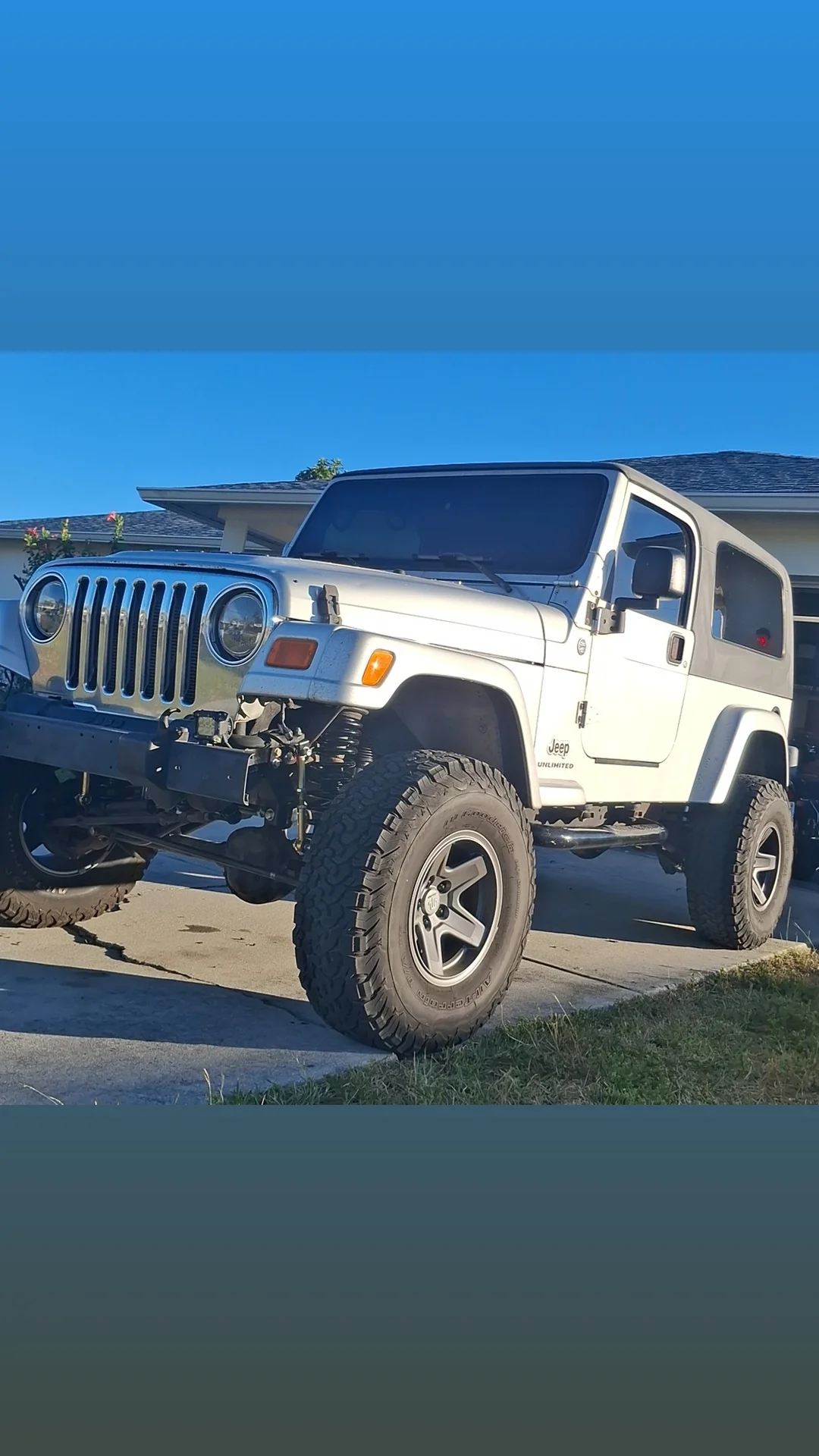

After 500 miles, the ride is substantially stiffer "FOR MY PERSONAL PREFERENCE" than I'd hoped for. Builder is questioning the springs and ME. Bilsteins are phenomenal above 55 with a solid, controlled feel but around town potholes holes feel....abusive at ANY speed from 5-45 mph. Not ready to bite the bullet with a custom valved set up just yet. All things being equal and assuming all part #s, install and control arm angles are correct what shocks are on the opposite end of the spectrum from the 5100s?

Approximately 17in compressd 27 extended fronts 16 in / 26 rears.

Skyjacker Blackmax or Rancho 5000X. Make sure they’re the right length so your travel bias is 50:50. Definitely not Bilstein 5100’s. Get a new builder if he’s questioning springs. Tire pressure at 24-26.5psi. Go have fun.
Your shocks seem long for 3.5” of lift.
x4, Rs5000X are the opposite end of the spectrum you are looking for and spray paint.
That's what people keep saying but these are the specs RK sent when I questioned them. Haven't measured but I netted more than 3-3.5 inches.

I would point the fingers at the shocks but won’t pass judgement until I see the entire suspension set up. Could be a lot to address. Can you post some good photos of the set up? Bump stops, track bar, control arms and the works?
Reactions: LJ-MXer
At the rate I am seeing people complaining about Bilstein shock you would think I could be able to scoop them up for cheap. 🤣
None currently I'll get it on level ground later tonight if I have sunlight left.
