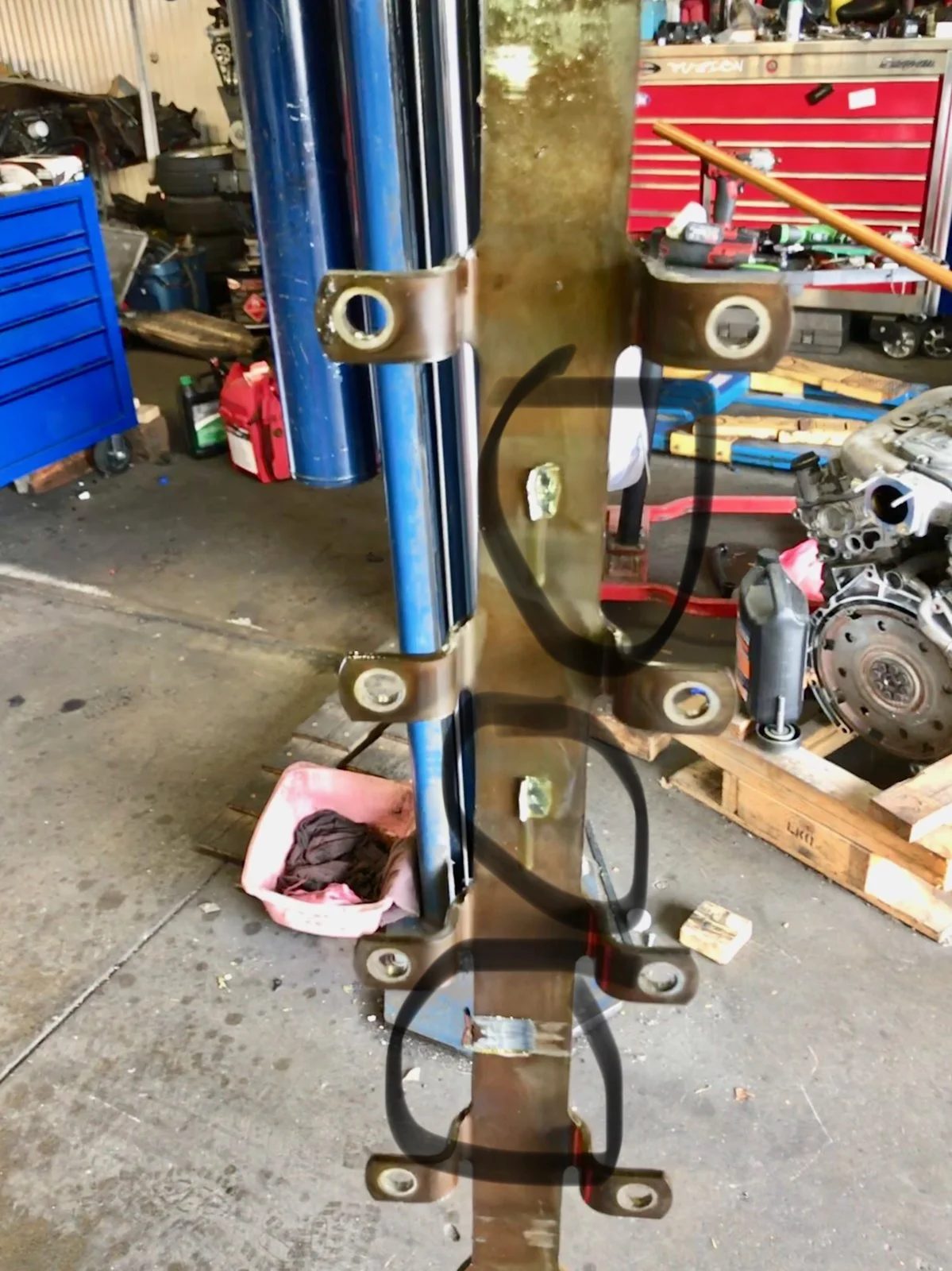

OK, finally found the time to get back to this project. When I received this motor from ATK, it didn't have a cradle for the crankshaft. I assumed that, like the other items I needed to add to this motor, the cradle was one of them. I called ATK and discovered that a stroker doesn't use a cradle due to the enlarged size of the crankshaft. Turns out my crankshaft struck the cradle and stopped during the initial start. It may be common knowledge to many of you out there, but it was certainly news to me! Thankfully, no damage to the crankshaft. If ATK had mentioned that up front, it would have saved us a ton of effort (transmission, clutch, flywheel, transfer case removal). We removed the cradle and got the motor running. Thanks for all your initial feedback. Checkout the photo of the cradle damage!
