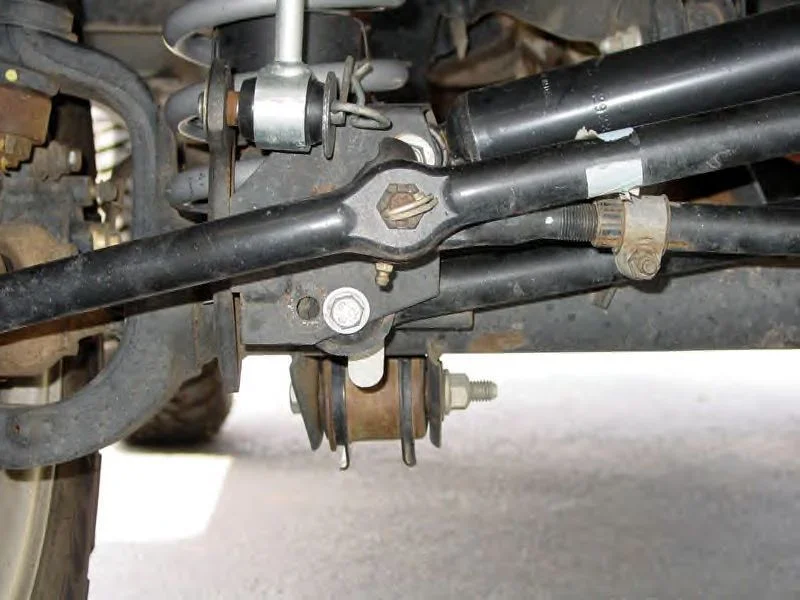

Or you can do what I've done on several (12) of my Jeeps. Cost me $1.24 at Lowes for a new 10.9 grade bolt, washer and nut. New stock track bar was $45. I've never had any issues doing it.
