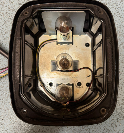

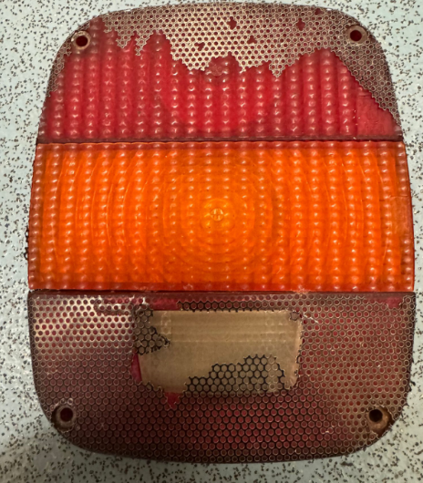

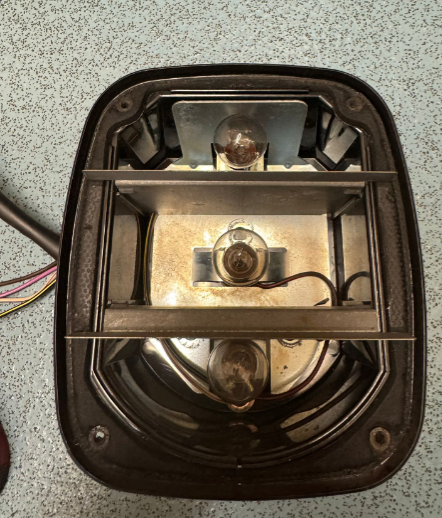

Are there two bulbs per side (not including the front turn buckets) and I’m just missing it in photos?

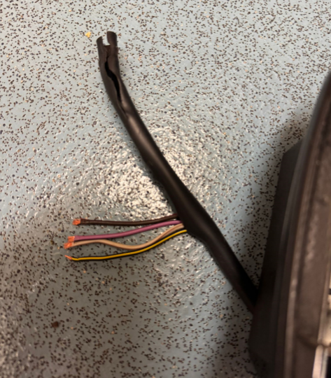

we have an extra bulb for amber turning signal and hazards,
Indicators : Black/Red
Reverse : Purple
Runnin Light : Yellow/Black
Brake : White/Red
Ground : = Black
