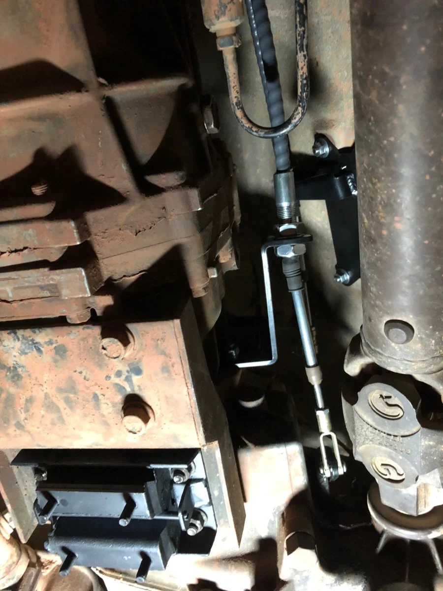

Thanks for the great advice all went well, Even replaced the trans mount that was grenaded. @Alex01 I am pretty sure that was the rattle I heard on "On Top of the World" when you and your father in law were going to help me track down the rattle heading up to the top.
Anyway here is the finished product shifts nice although I haven't test drove it yet still more stuff to do first and I am heading or a vacation in Vegas for the weekend.

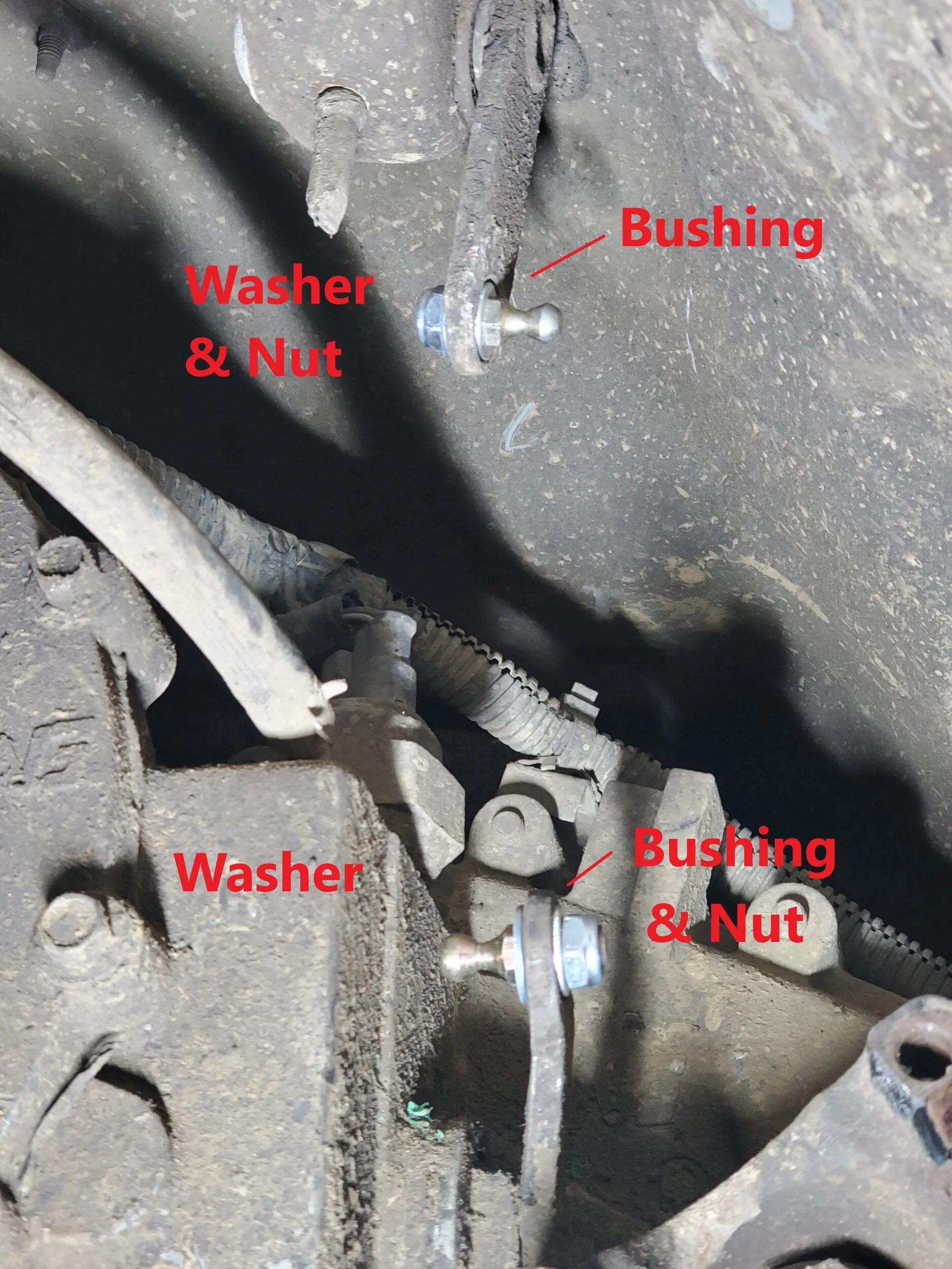

This is my 2003 TJR (241 TC) with 1.25" body lift. I spent several hours reading the many threads on this forum and others before attempting my installation. There is a lot of great information spread out over those threads however this detail wasn't real clear until I found an obscure thread on an another board. After removing the plastic bushings, assemble it as shown below.
I hope this makes it a bit clearer for the next peron installing the cable shifter.
