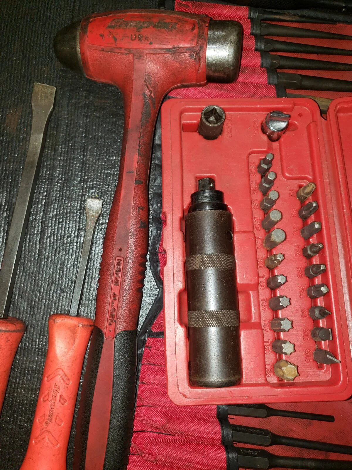

You need an impact driver...
No...not an air gun...
This 👇👇👇👇👇👇
Then with right bit smack end with hammer.
Good luck
