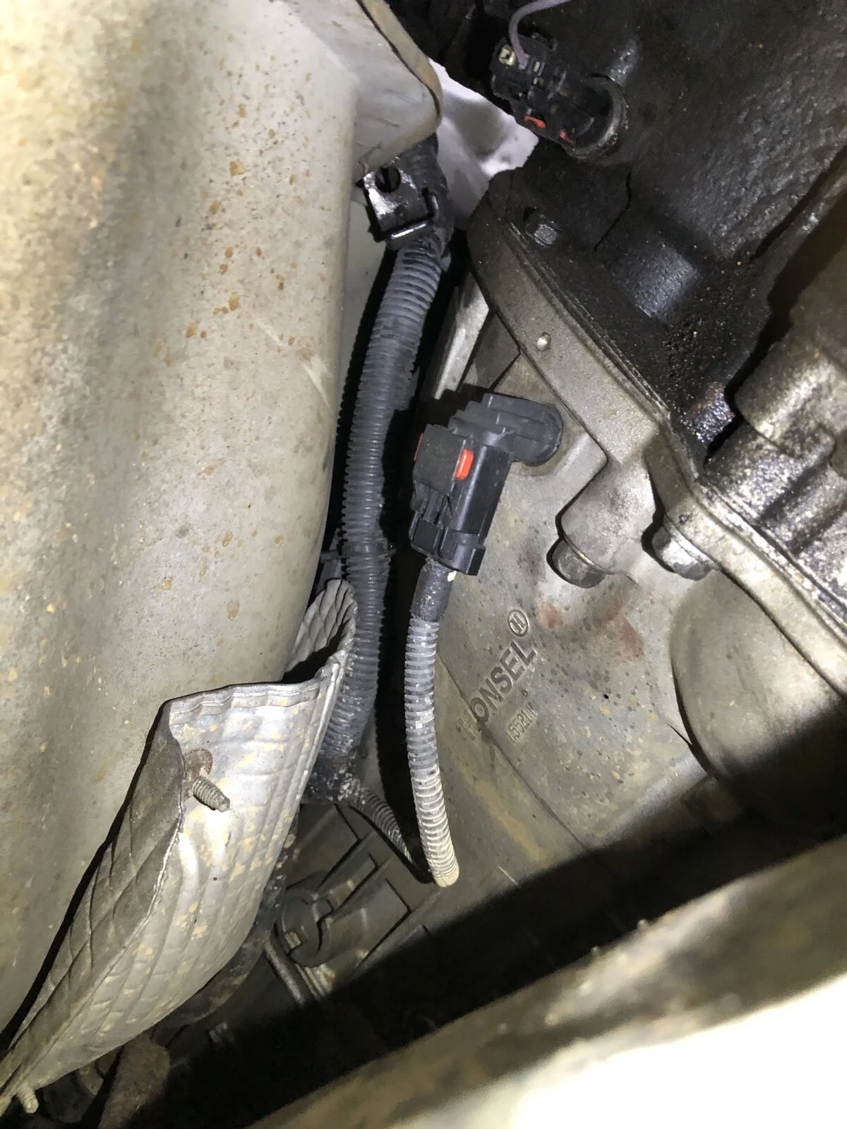

Just found the crank position sensor, so at least I'll have that in the case that the fuel "workup" proves unfruitful.

I think I found the Crankshaft position sensor, but can't seem to trace it's wiring harness to it's origin.
I can't really tell if the fuel pump is priming as I don't hear it while sitting in the vehicle, but I don't have a buddy at the moment to help me out with cycling the key so I can listen from the rear end. So I'll check back on that one.
Here's a pick of the sensor; it's on the passenger side of the trans bell housing (it's an NSG370 6Speed manual).
OK, final update from me for the night. It's not the Crank position sensor, it was super easy to replace, just had to pull the plug, I was going off the DIY's for the earlier models and thinking I had to trace the harness back and disconnect it elsewhere, then looked at the replacement sensor and DUH!
