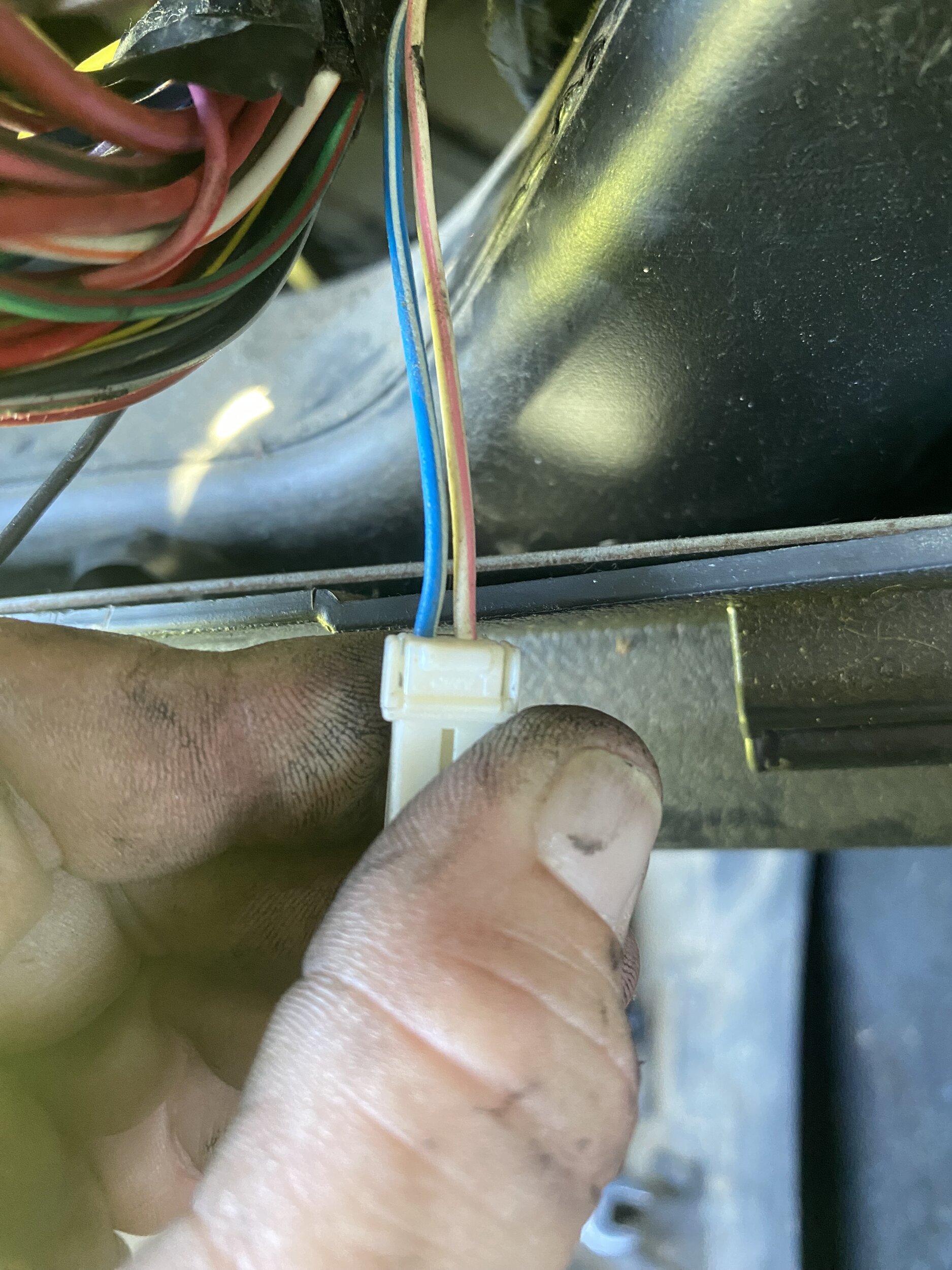

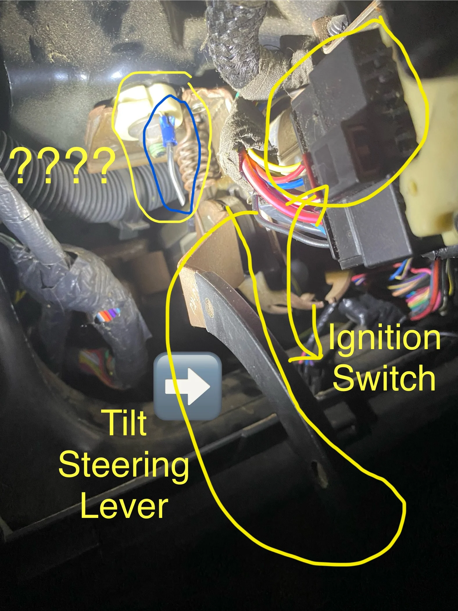

BUT… I did see a wire close to my steering column that look like it’s been severed or cut..
I looked for over an hour trying to figure out where it could have went to and no luck finding it…
I will post a pic of it.
Any suggestions on where it could go or what it’s to?

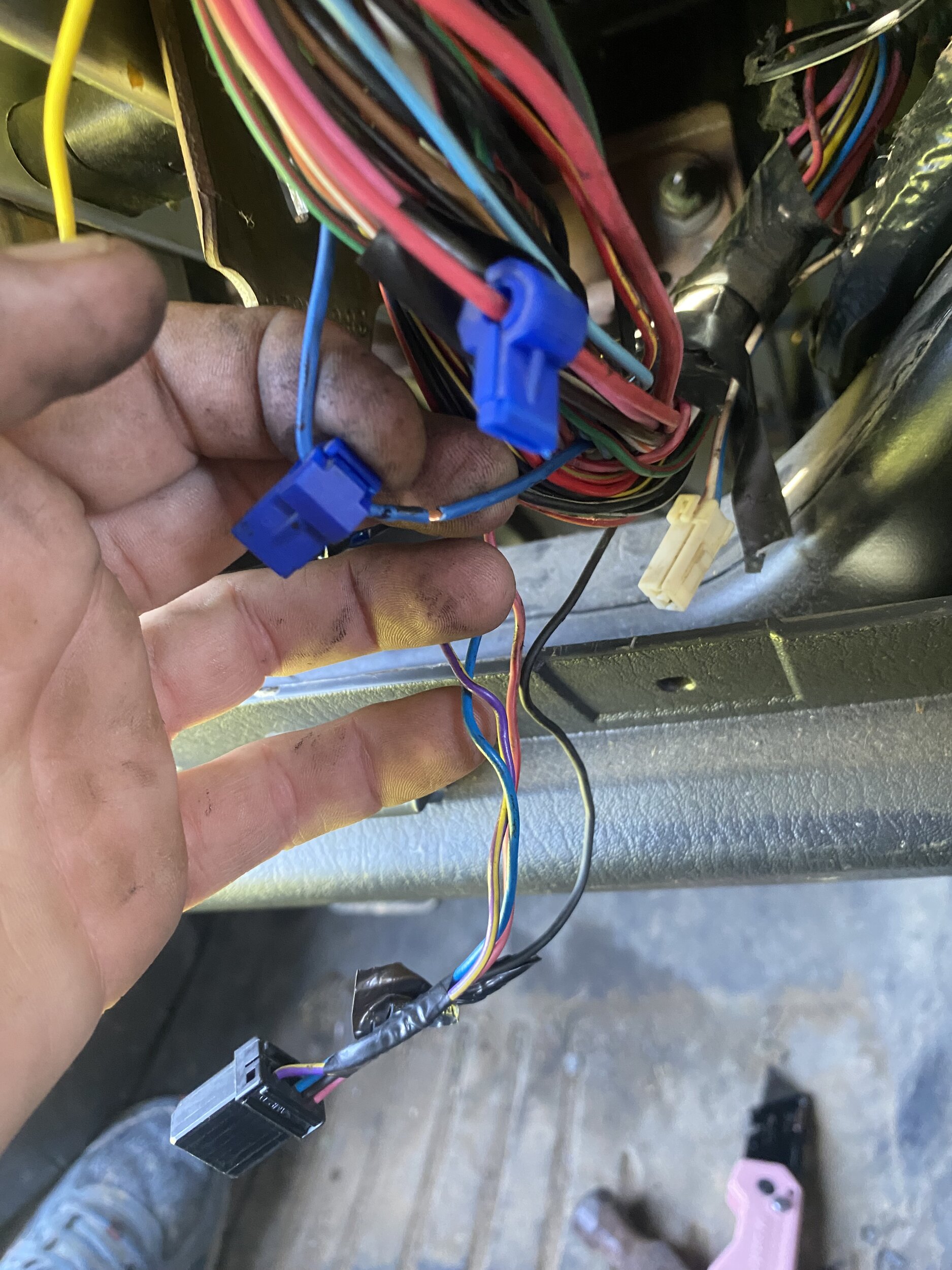

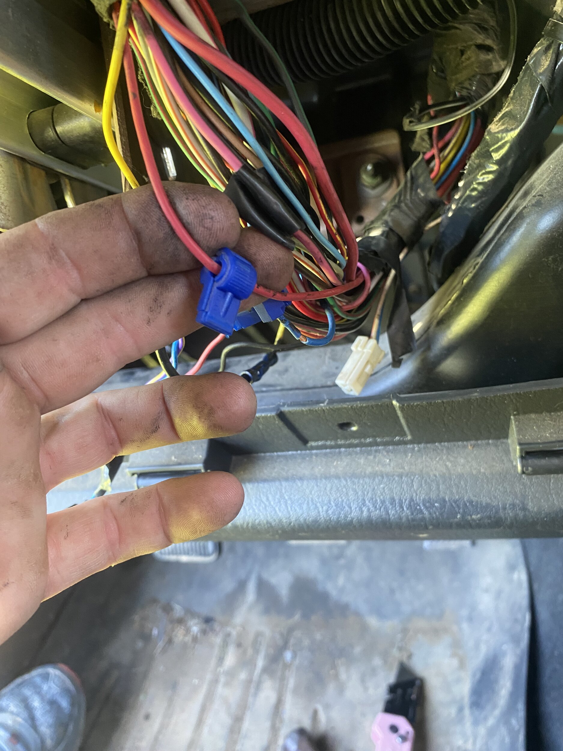

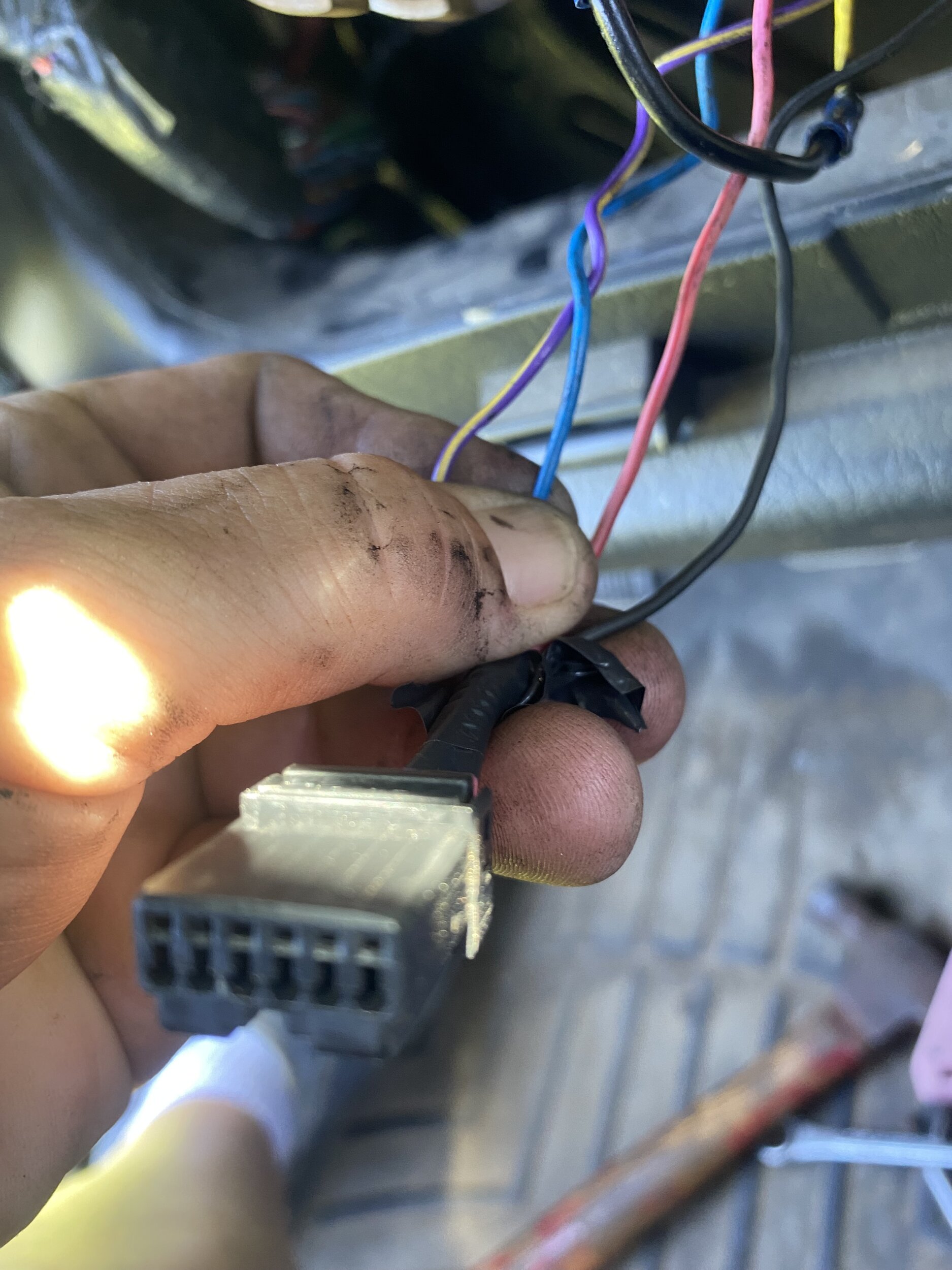

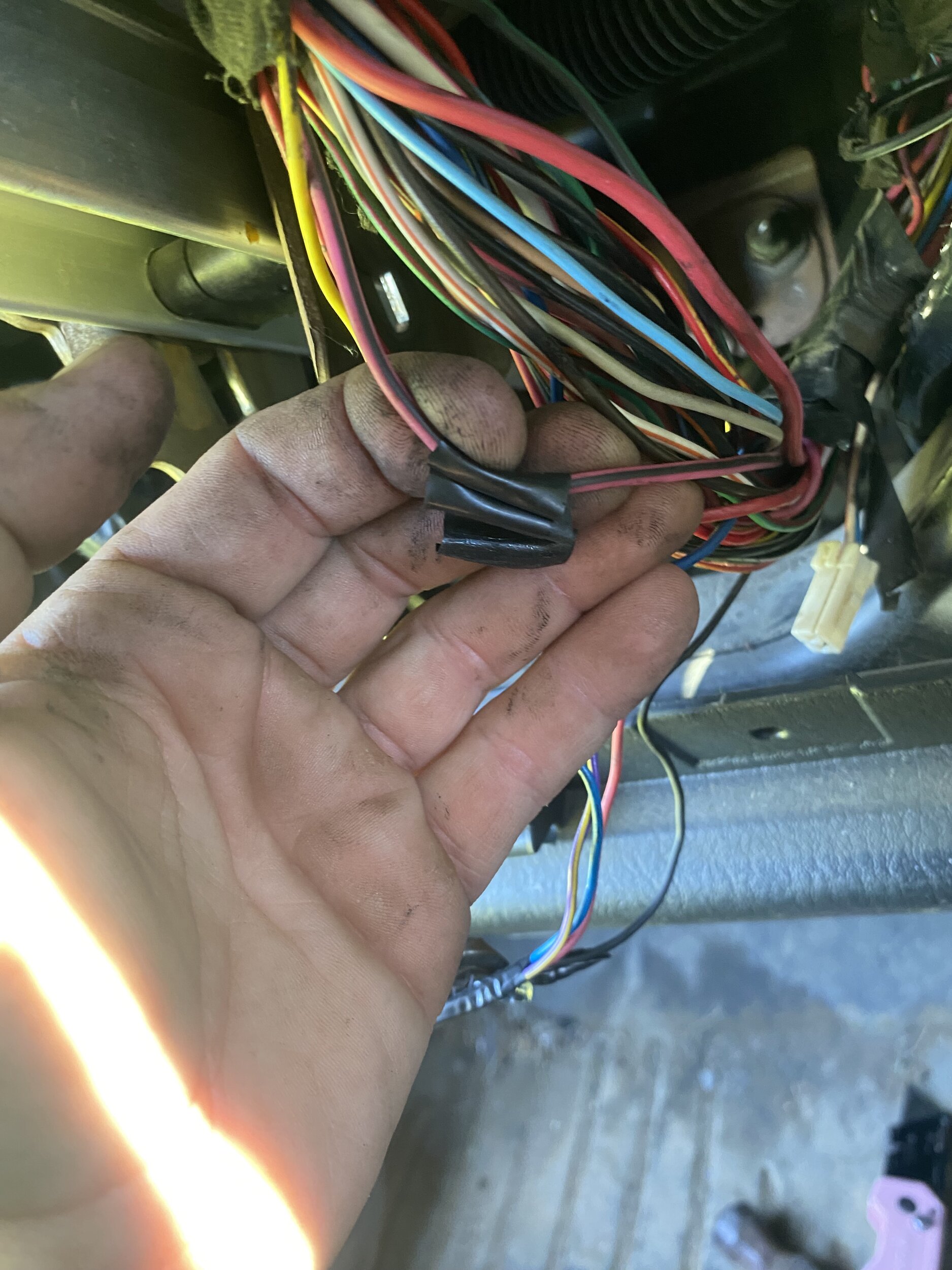

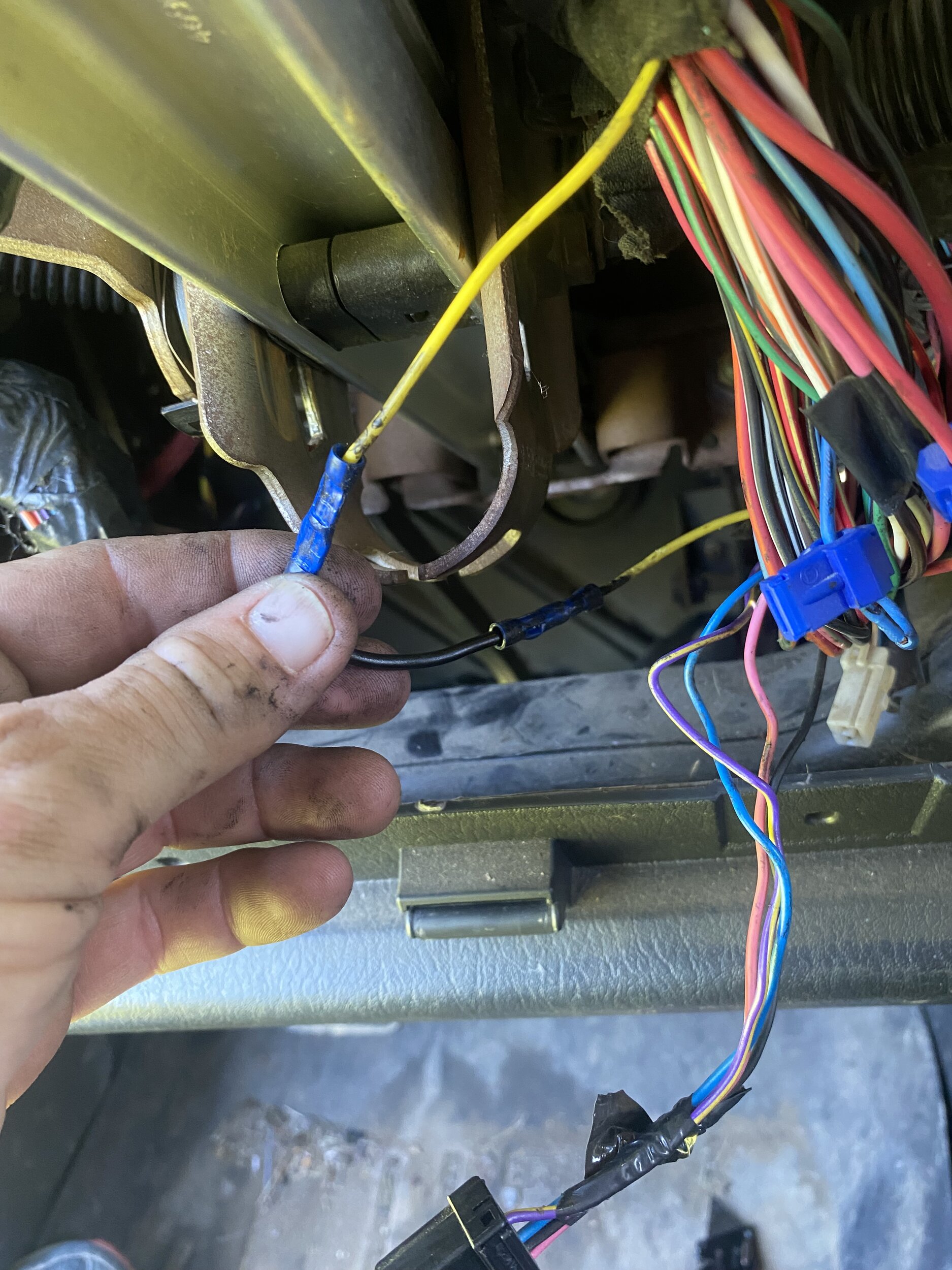

My cousin is gonna come by and test my starter …. But in the mean time I found a big mess…. And this mess ain’t mine:… it’s in the wiring… I’ll post pics… I’m gonna splice them and shrink wrap em… i’m not sure if this has anything to do with the problem I’m having now but I’m going to fix them anyways just to be sure

I still don’t know where the wire goes that’s in the first set of pics…. It’s next to the steering column:…

While I'm not a fan of how the previous owner wired things there, I'm more suspect of a starter system issue. It's good to clean that mess up, but debugging the starter and related components is the best place to start. @Granite's suggestion is spot on, too.
Well, it's not stock - Chrysler doesn't use those type of ring terminals. It also appears to be a ground. It was likely added by the previous owner for some electronic item added and then removed. Rather than properly remove the ring terminal from the screw, it was just cut off. You likely just need to remove it (and even that's not a top priority since it's a ground).

I am currently going through the exact same issue. It looks like you had an aftermarket security system installed at one point.
I know this cause it looks 100% like mine. I had a shop remove a viper system and now it won’t start at all. Nothing.
