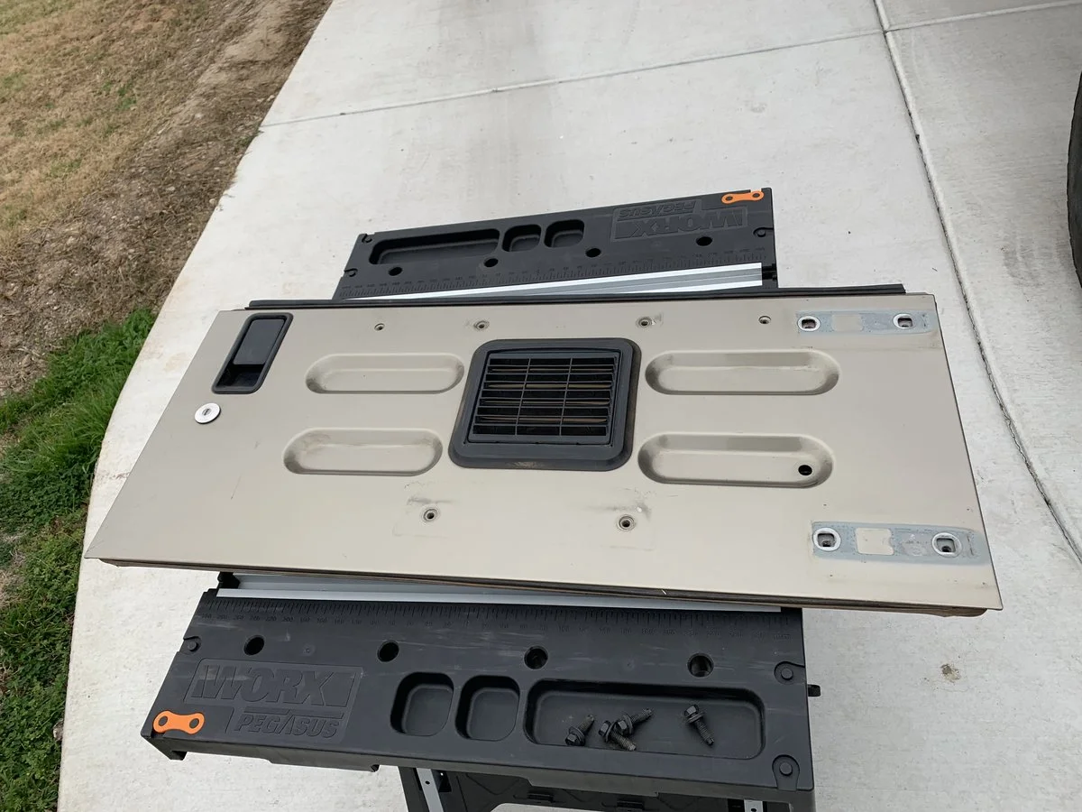

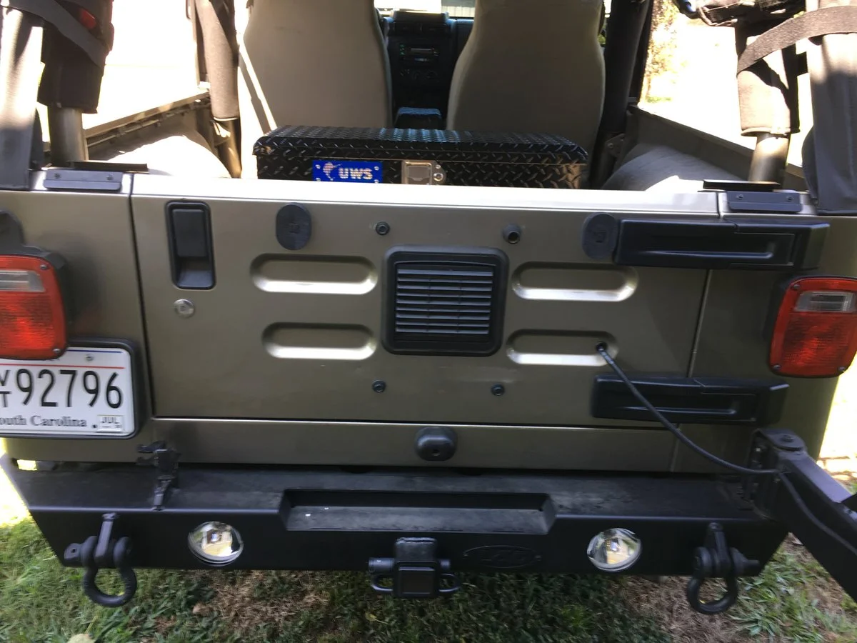

Anyone have a pick of a newer TJ vented tail gate? I think that’s where they are vented?
I have been dealing with it. Not a big deal, but the doors have to be slammed unless I crack the windows a bit. Just us annoying.
2006

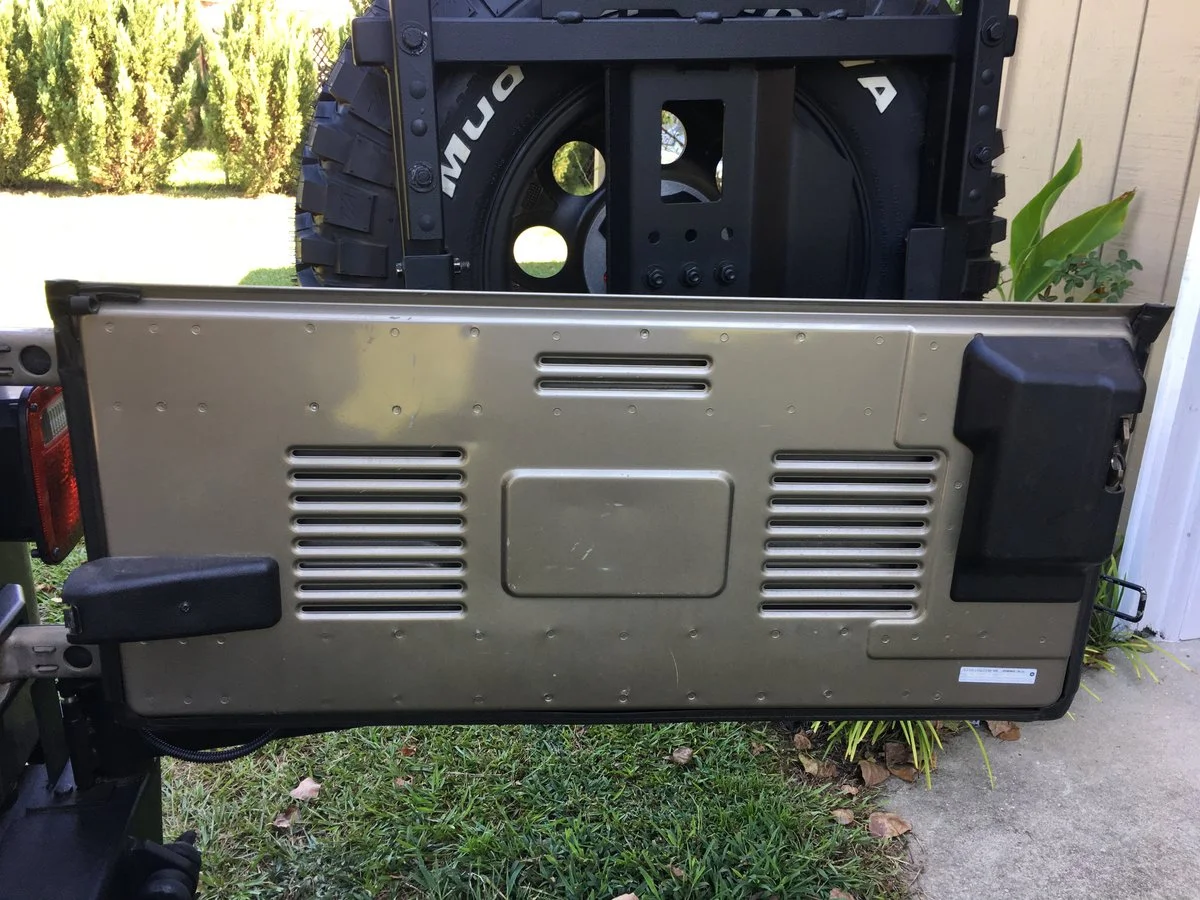

Grab a outside vent assy. from Davey's, and DIY your own. I'm sure you can come up with something creative for the inside vents. A die grinder is your friend!
Ya I have an idea. A few small round louver style vents. Couple on inside and couple outside. Just need to find exactly what I’m looking for first.

You will want to use an OEM vent. It is a one way vent that allows air to escape but prevents water and exhaust from being pulled in. They simply pop in so you would just have to cut out the hole. On the inside you could do want you want.

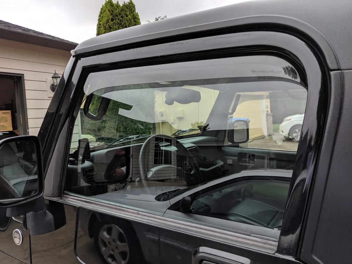

I have an '05 with the vented tailgate and the doors were still hard to shut. I installed these last winter since I like to get fresh air even when it's cold/rainy. Since I leave the door cracked open all the time now, it solved my for closing problem completely.
