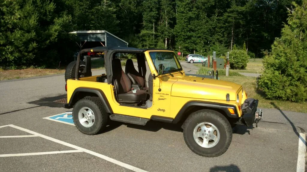

Hope y'all won't get tired of my n00b questions but I want to learn and be able to make the right choices on my new toy.
We hauled my 00 4.0l manual TJ up on the lift and gave it the once over. My Jeep friend says this TJ "didn't have lockers" and in fact when i put it in 4wd a light on the dash says "part time". My wheeling experience has recently been driving a JK Sahara which locks axles in 4wd. How is my TJ going to handle things differently if the front axle didn't lock into posi style rigidity?
The only other major concern I have is the transmission is iffy. 2nd gear grinds easily on a downshift. We're going to do a full flush and refill with synchromesh and hopefully that'll smooth things out but I may be looking at a rebuilt NV3550 at some point. (These don't have AX15s right?).
Hope to see some folks at New England events soon. My yellow and black baby should be easy to spot :)
