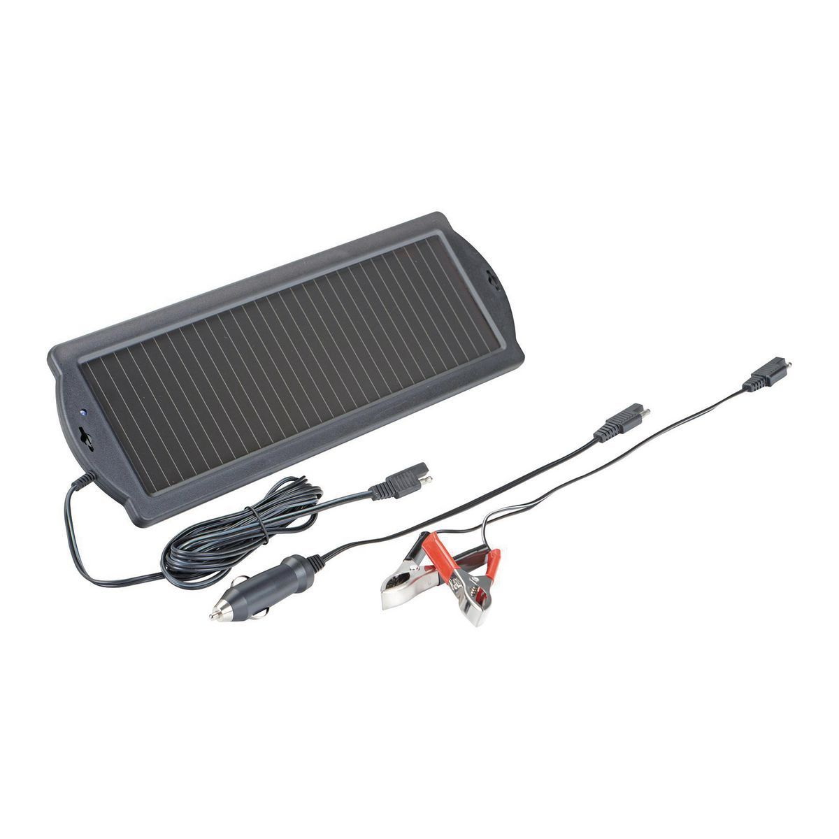

Harbor Freight has a small solar panel that you could probably mount in front of your grill, on the sway bar cover. $15.
Why the cheapest option?
Cool solar panel... maybe it'll fit on the cowl or on top of the spare tire? I trimmed the sway-bar cover, and there isn't much room between the grille and the winch.

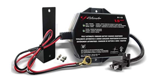

I'd keep any battery you want to have a long time on a battery maintainer when you're going going to be driving it a lot. I bought the below maintainer on Amazon 10-12 years ago, it works great. I keep it permanently attached, I mounted onto the top of the air intake filter box. I extended its AC cord so it hangs in front of the radiator so I can plug it in or unplug it easily.
I would like to be able to do that, but most of the time I can’t park my Jeep close-enough to the house for a cable to reach. The best I can do is to mount a solar panel, which I’m looking into.
