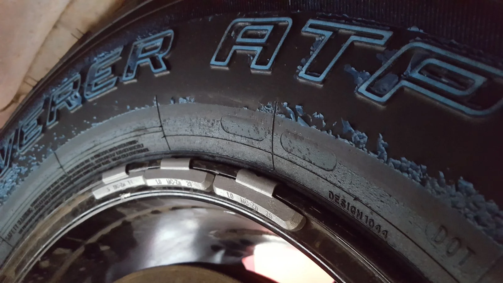

I bought brand now Cooper ATP's and aluminum rims from Discount Tire. They don't have a lip for wheel weights so they have to use tape weights on the inside. I have had it on 4 times in a year for a balance, and they can't seem to get it right. This is on my Ram 1500 pull truck. I have never had luck getting my tires balanced at Discount Tire. Am I the only one? The reason why I post this is I am looking for new wheels and tires for my TJ, and I am pretty sure I don't want to get them from Discount Tire, so I am looking for a better place either in the Arizona area, or maybe a better chain? Any suggestions would be great!

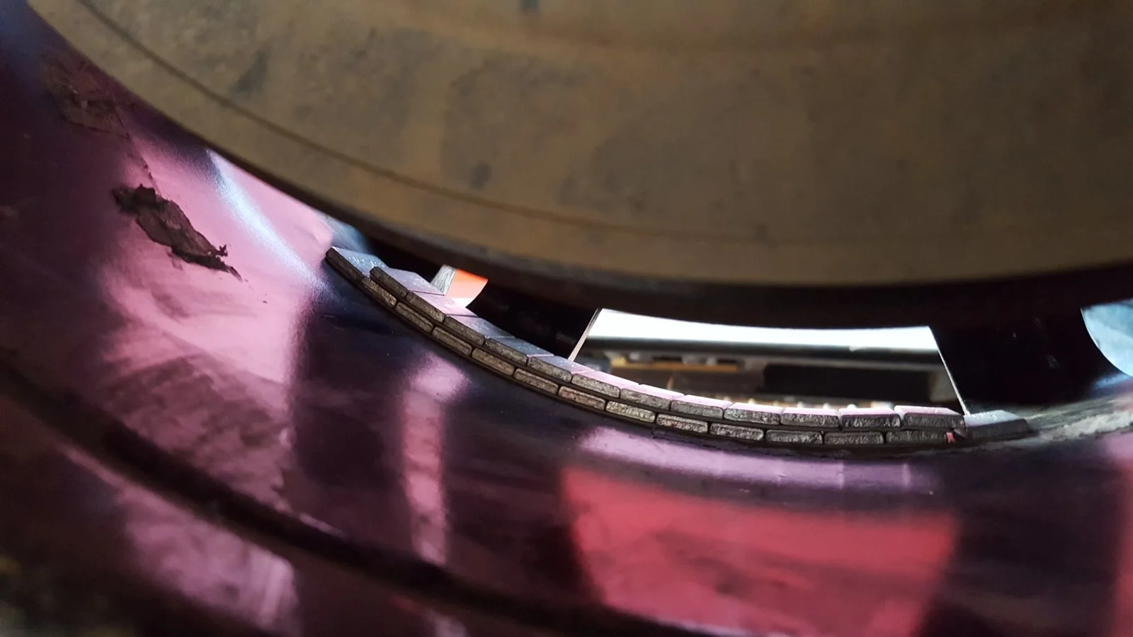

I am at the point where you were. I am fed up too. Not only can they not balance my tires they tell me they split the weights up because the weights were on one side of the tire, So after driving home from work today it is still bad. I mean like 70 it starts to vibrate and 75 if feels like I have lost a wheel completely. This is worse than how it was when I brought it in to get it fixed. I looked at the wheels and they are still balanced on one side of the wheel. I am not even sure they even did anything the 4rth time. so after 4 times they still can't get it right. At this point, I don't mind spending more money to get it right. I just want it right. Thanks for the story. I thought I was going crazy. The only local show I am aware of close to me is 4wheelparts. I will talk to others and see if there are shops I am not aware of, but this is pretty ridiculous. All I know is they aren't going to get any more money from me. Especially expensive tires. I like the advice I got about finding a ma and pa shop. On the Hunt. If anybody in the Tempe AZ area reads this and has a suggestion hit me up!

I emailed corporate and let them know I wasn't satisfied and that I had it in 4 times for balance and each time it gets worse. They said they would have a guy from the store get a hold of me. He did and he told me to bring it back in, so I did for a 5th time. It is a little better but the truck feels like it is coming apart at 75. They gave me buzz words like force balance and other what I am assuming are discount tire made up words. So I crawled underneath and found there are tape weights on the outside and lip weights on the inside and there are no rhyme or reason. Meaning if the tape weights are on at 0:30 the lip weights are on 0:50 on the opposite sides and others are at the 30 and at the 0. WTF now the wheel behind the driver has two stacks of tape weights one on top of the other
Now mind you these are brand new wheels and tires. They are house brand wheels and house brand coopers. I didn't know at the time. I am suspecting a bad wheel, but arent they professionals and after taking it back 4 times shouldn't they be looking at these? Now I have taken them back 5 times and still not satisfied. Does this look odd to anybody else? Doesn't it seem weird that the weights are on the bottom and the top of the tire and not on others. Also this tire has at least twice as much weights as any of the other tires. Do I take these back and throw them through the window like the old lady?
