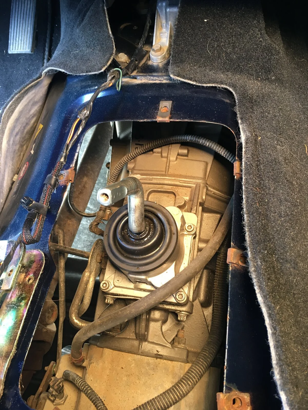

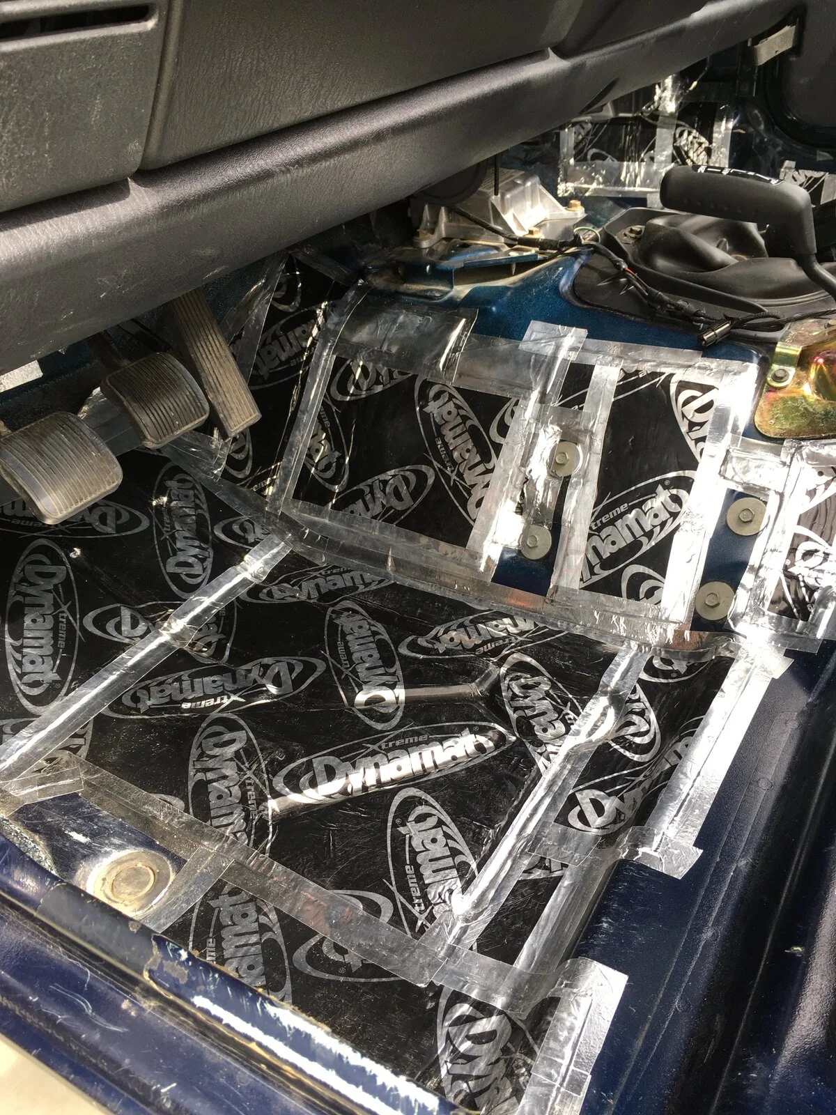

The pre-cat and downpipe are nearby, combine that with convective heat emanating from the transmission and bell housing. The main cat is located under the passenger side next to the transfer case. Here's a top side image sort of showing the area under the right foot:
Dynomat is a poor thermal barrier, but it will mitigate heat transfer somewhat.
A Yoga Mat helps, but products designed for thermal shielding are better. https://www.thermotec.com/products/sound-and-heat-barriers
