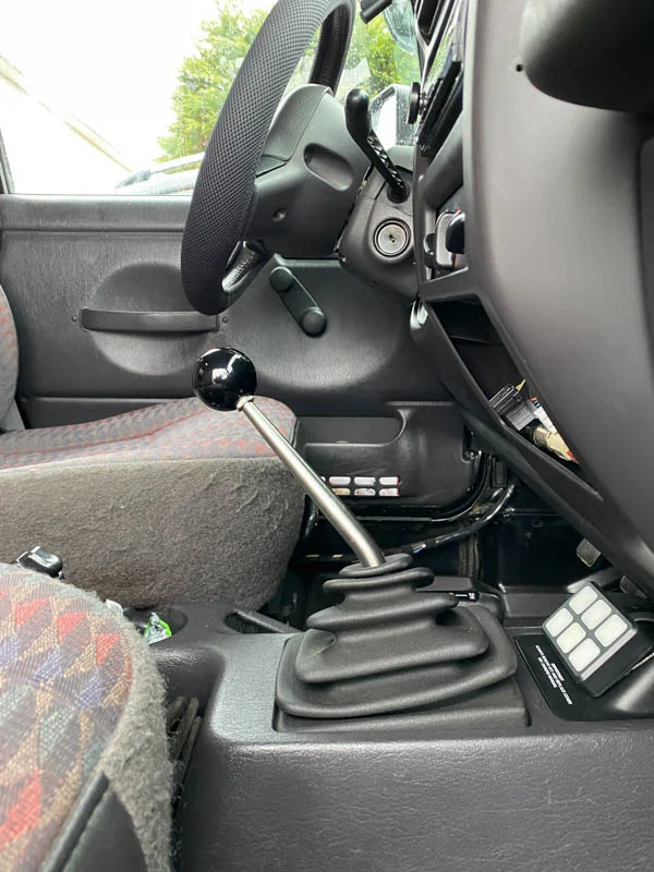

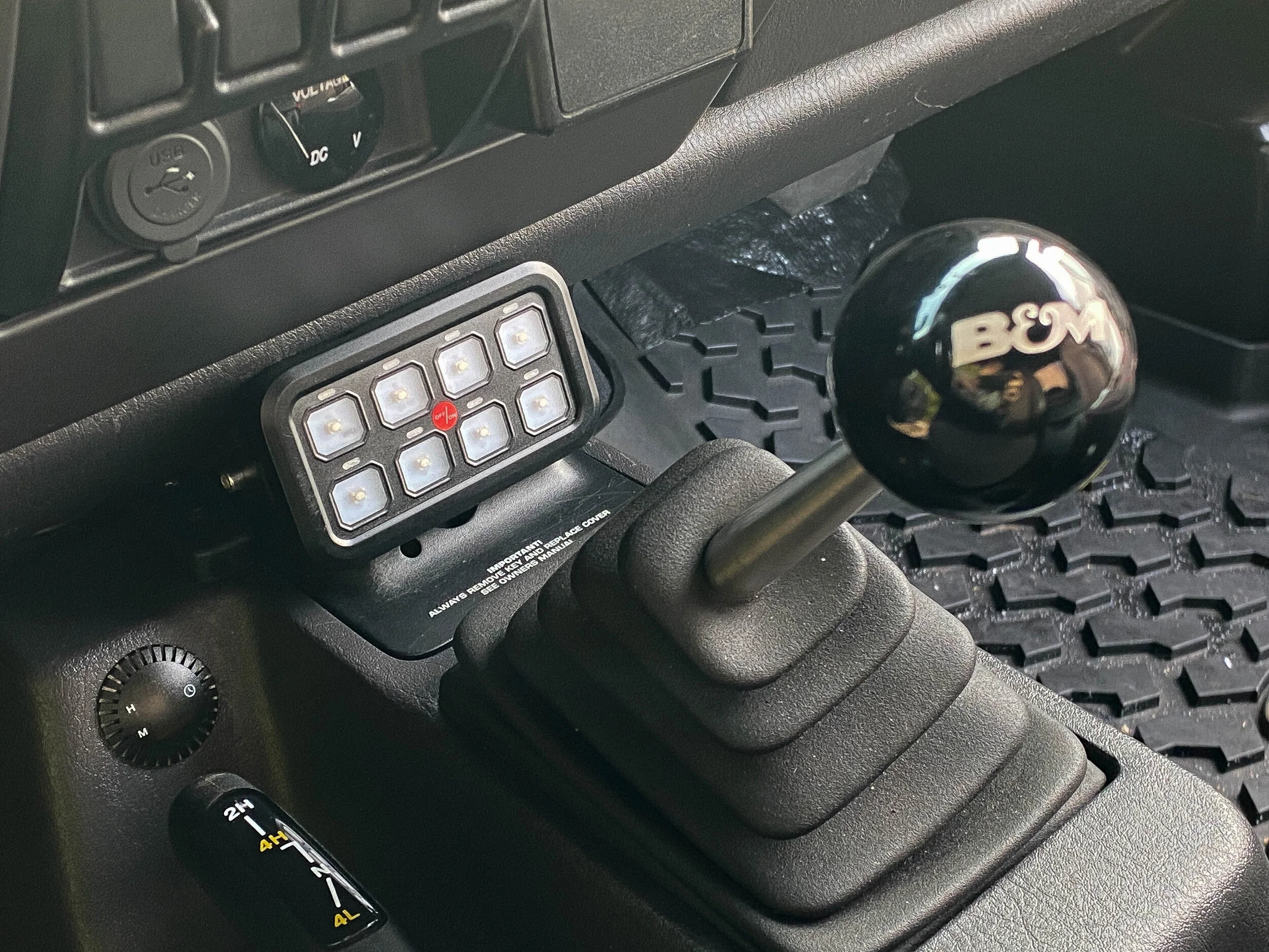

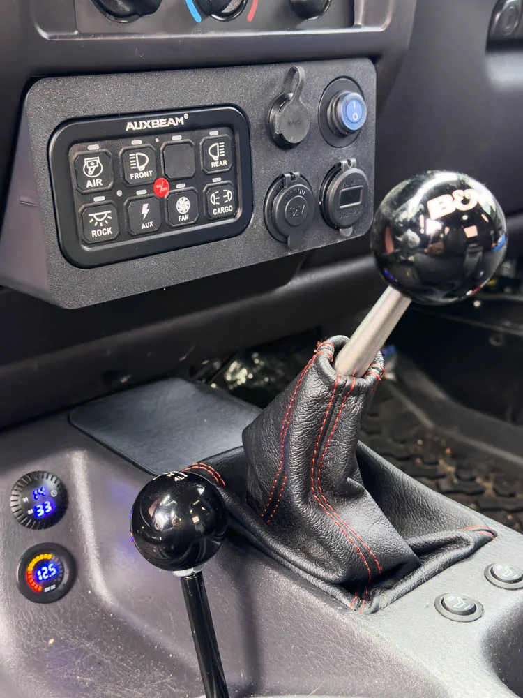

What do you mean by "how much lower the B&M shifter sits"?
I have the B&M in my 2000 with the NV3550. The throw is substantially shorter but the overall height of the shifter is no different than the stock was.
You're looking for this one...
Every picture or video I've seen for that shifter shows the shift ball lower than the OEM one.
Can anyone post pictures of the B&M installed in their TJ?

The B&M is only slightly shorter.
I watched that video a few days ago. The B&M looks like it is at least 2" shorter than the OEM unit.
Do you have a side picture of the B&M?
What is your transfer case shifter?

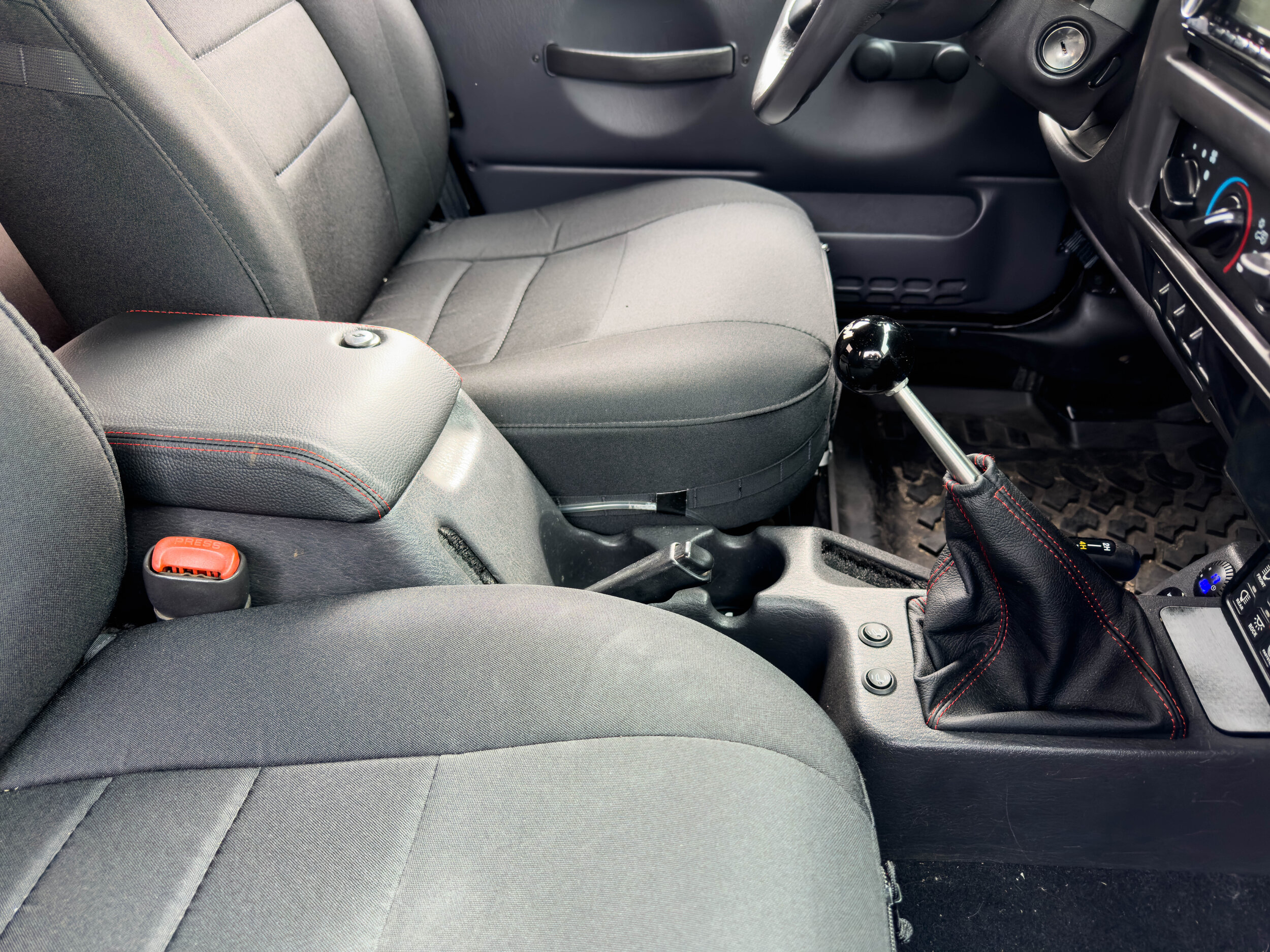

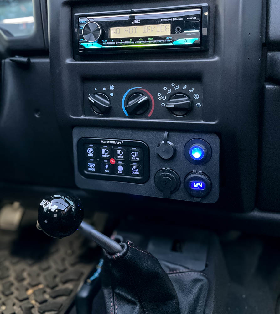

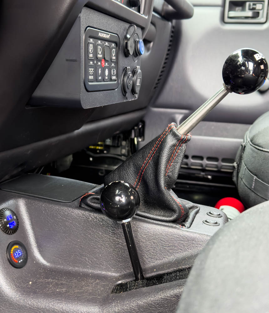

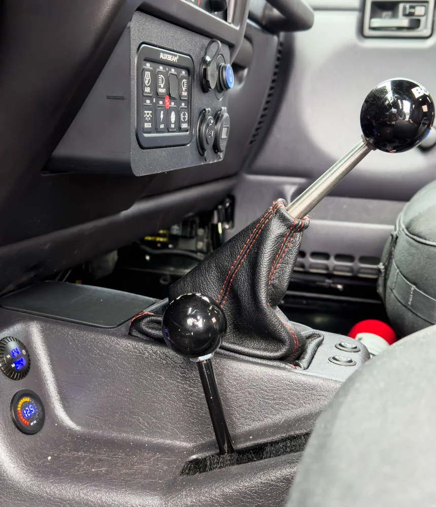

Candidly, I never noticed/recognized that it was shorter in height.. I was too enamored by the precise shift throws to even notice.
The images I posted above were readily available. Tell me exactly what you're looking for and I'll take a few pictures today.
Straight transfer case lever made by an eBay seller, that I bought from member @Moglocker. Mated to Savvy transfer case cable shifter kit. Knob took some searching to find what I wanted.
Reactions: mjonesjr84
Looking for from either side looking into the Jeep. Looking to get an idea of exactly how low it sits so I can compare it to my factory shifter.

It will be hard to compare apples to apples because so many other things might have been done to the jeep that will affect the height of the shifter. Like Mike, I didn’t notice any difference.

Mine is in the stock location. I guess if the B&M is too short for me, I could always get the belly up skid plate installed sooner than later.
