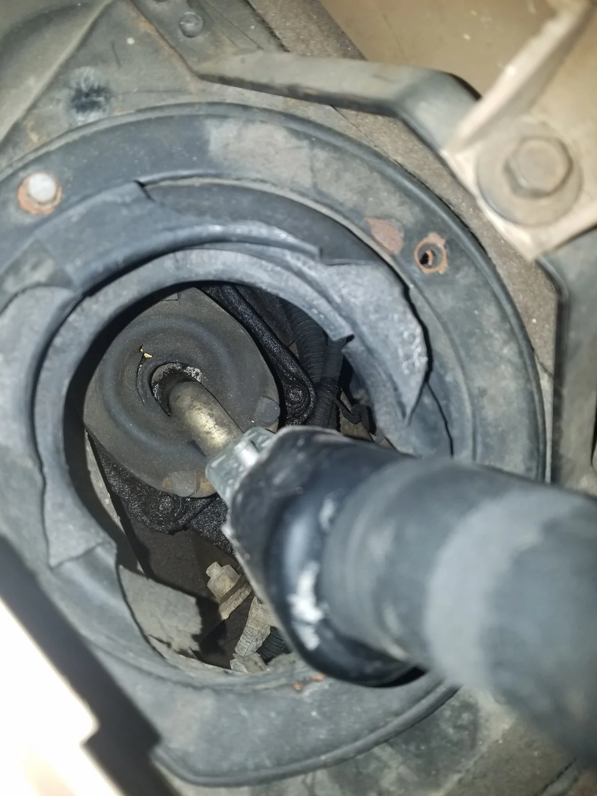

It soon became obvious that I needed to gut the interior at floorboard level, just to do a decent job of rust denial and abatement. Not surprisingly, I remove the outer shift boot and center console...and then the inner shift boot and plate...and then, ugh...the boot on the top of the tranny looks like this:
Hmmm, mental note to change the tranny lube when I'm done.
...and add the boot to the list of "get now" items.

After pulling it all out, including the tower, I find that, at least on the NV3550, the internals of the shift tower are kinda fairly water tight...not totally mind you, but incidental water like driving in the rain (not a frog choker) would probably not be a big issue if any of the dust boot remained as a deflector. That said, these are Wranglers and we are supposed to be able to ford creeks and small rivers without damage...the boot has got to be fixed!
I discovered a possible source for a boot that runs around $50 (all in) rather than the roughly $110 (all in) for the replacement Jeep tower. I'm rolling the dice and, if it works, I'll be sure to let everyone know "how to".
Seriously though folks, I'd check my boots fy weryoo. It would suck big ones if, just because you didn't realize your dust boot was...well, dust...that your next trip though a creek ended up trashing your tranny. On a TJ with a NV3550, you can pull the upper/"outer" boot and middle/"inner" boot with very little effort and that will allow you to put eyes on the tower/dust boot...just to check on that critical chunk o' rubber that separates the top of your tranny from all that the mean, cruel world wants to throw at it.

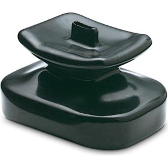

So, I had to do the same thing. Here is another option if you just want to replace the rubber boot instead of the entire tower.
It’s a Hurst shifter boot (1140024). Runs around $40 on Quadratec.
Unfortunately, I already purchased the tower for my replacement so I cannot attest to its viability. The hurst shifter boot is made for the same tower, so I would hope it works. You could just slip it over your existing boot.
