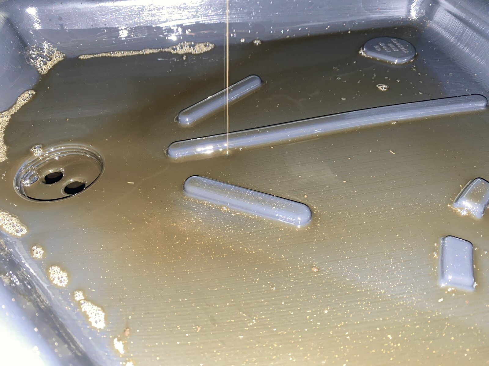

does this sound like symptoms of worn out synchronizers, I always see golden glitter when draining the fluid (photo above at a 50k mile fluid change interval). ive replaced shift forks internally in other standard transmissions, so I know internally what they look like.. just not so much on how exactly transmissions function.

I just drained the synchromesh and the oil looked good coming out. other than a slight gold glow to the draining oilI didnt see any brass flakes and bits like the prior 50k whatever mile drain earlier this year in the drain pan.
