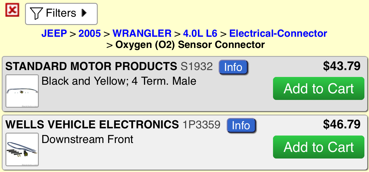

I’ve been in a similar position. I believe I purchase the Standard Motor version for my 2005 B2S2 harness side plug.
However, I ended up having bare wires touching that I re-insulated. I kept the connector as a spare, so I can’t remember if it was the correct plug for me bc those details are getting fuzzy.

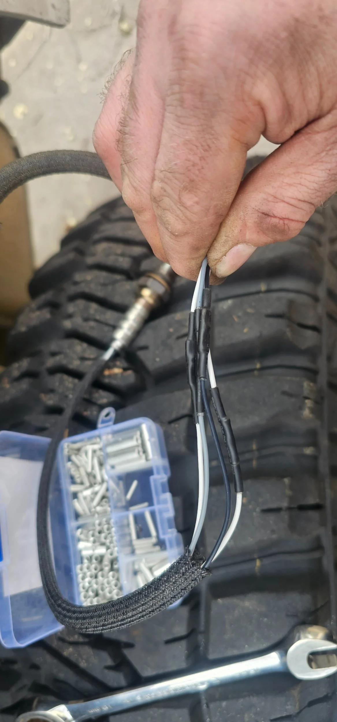

If I couldn’t get it to work I would either find a different plug to use for both ends, use heat-shrink space crimp connectors, or use heat-shrink crimp butt connectors. I’d then tape and zip tie them. I wouldn’t use bare splices and heat shrink tubing for this unless you make the tubing short or the wires long enough to allow for future repairs.
I moved the plug over to the driver side of the transmission for easier access and tied the wiring off.

Use insulated butt splices and adhesive heat shrink to repair and move things around. A couple months ago, I added several inches to the B2S2 sensor after the connector because getting to it was so difficult.
