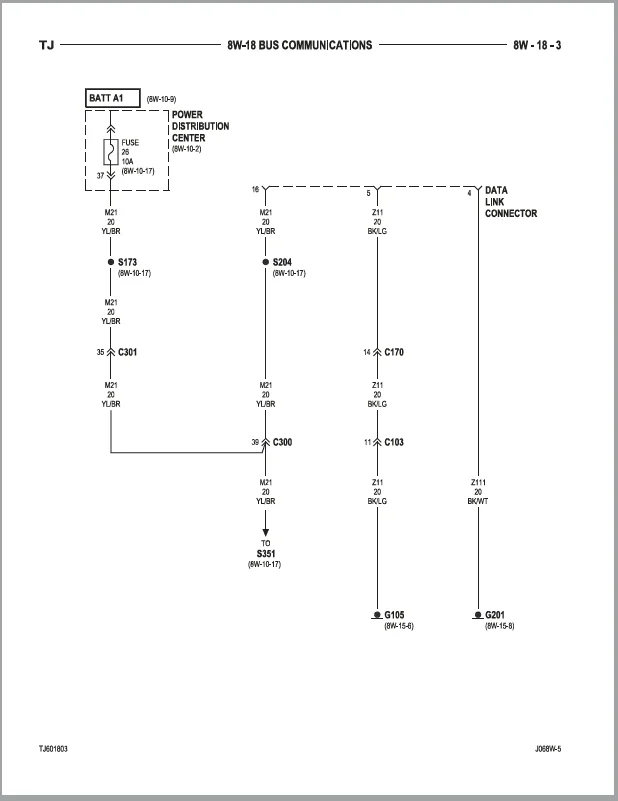

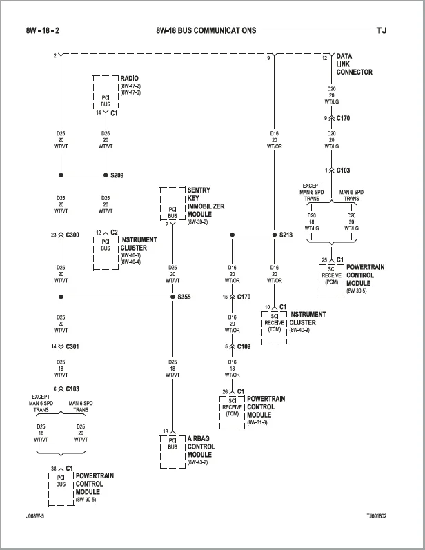

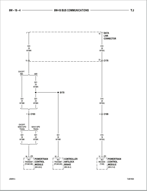

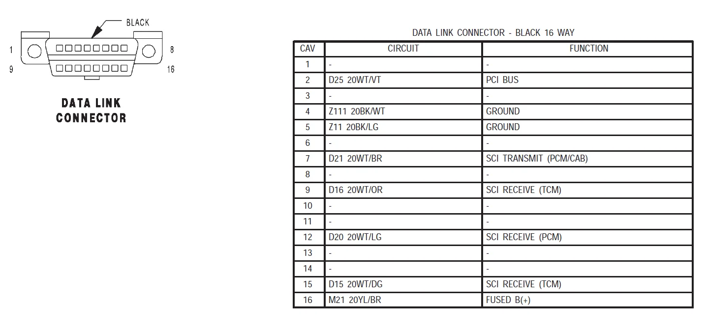

Hello all, new to this forum and I’m hoping you all could help me out. My obd2 port on my 2006 LJ broke. I ordered a new obd2 port that came with wires already on it in ports 3-7, 11 & 16. I need help figuring out which colored wire from my Jeep goes to which port in the new obd2. Any pictures would be greatly appreciated!
Is your old OBD port so messed up test you can't just go pin-for-pin swap?
Here are the three pages from your factory manual that show the wire colors & pin locations. Your manual is available for free over in the TJ Resources forum btw.
Pin 2 = White/Violet Wire
Pin 4 = Black/White Wire
Pin 5 = Black/Light Green Wire
Pin 7 = White/Brown Wire
Pin 9 = White/Orange Wire
Pin 12 = White/Light Green Wire
Pin 15 = White/Dark Green Wire
Pin 16 = Yellow/Brown Wire
