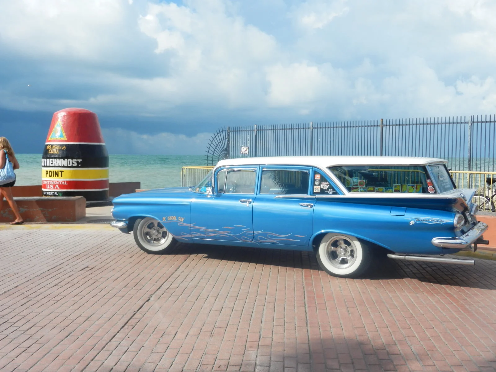

hoping to finally find an answer to my dilemma. My screen name obviously relates to my other baby, my 59 chevy wagon. My youngest daughter grew up while we traveled all over fla and up into Ga and Tenn,, On different trips the wagon has been as far away as texas ,drove it across the bricks at indy, cruised the GM proving grounds in Michagan and survived time in NY. I had replaced the original 283 /powerglide combo with a 350 and a 700r4 and it was fine for yrs. Well you know how it goes I needed a little more power and before you know it I had a 383 stroker with 420 hp and 460 ft-lbs of torque with a fast ez efi system on a chromed gm ramjet fuel injection manifold . well I got it running and it ran great . I put on 500 miles to break it in ,changed the oil and set out for charlotte nc for the 2014 hot rod power tour. Everything was good till I hit northern Ga where it began to stumble and finally it died on the south Carolina border. well AAA towed it to a great little shop and the guy was very helpful but small towns don't always have the parts you need in stock so I had to stay overnight . About 3 am the unthinkable happened as a drunk driver slammed the jeep next to me into my 59.
