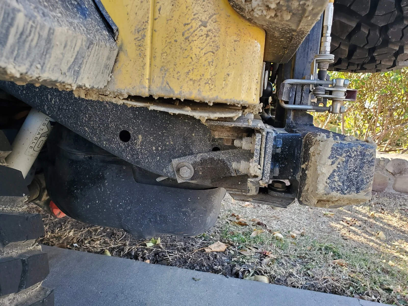

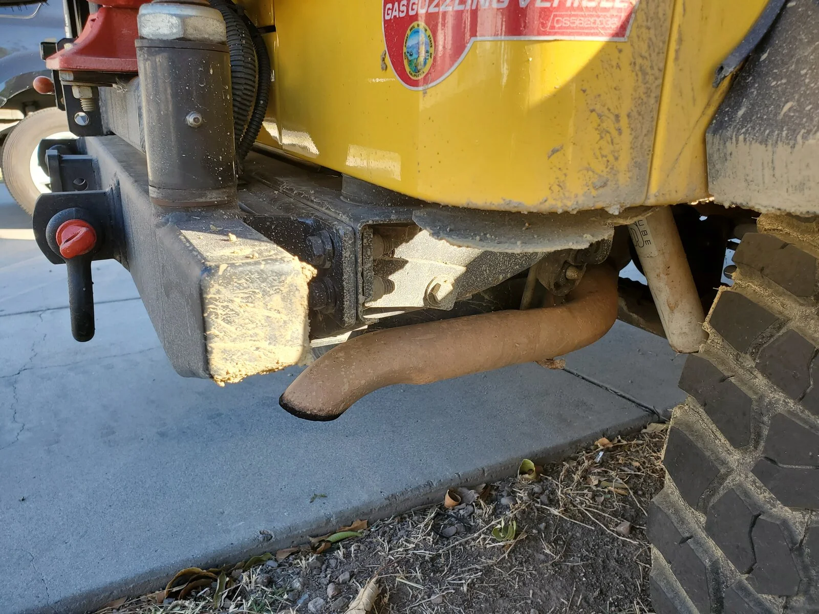

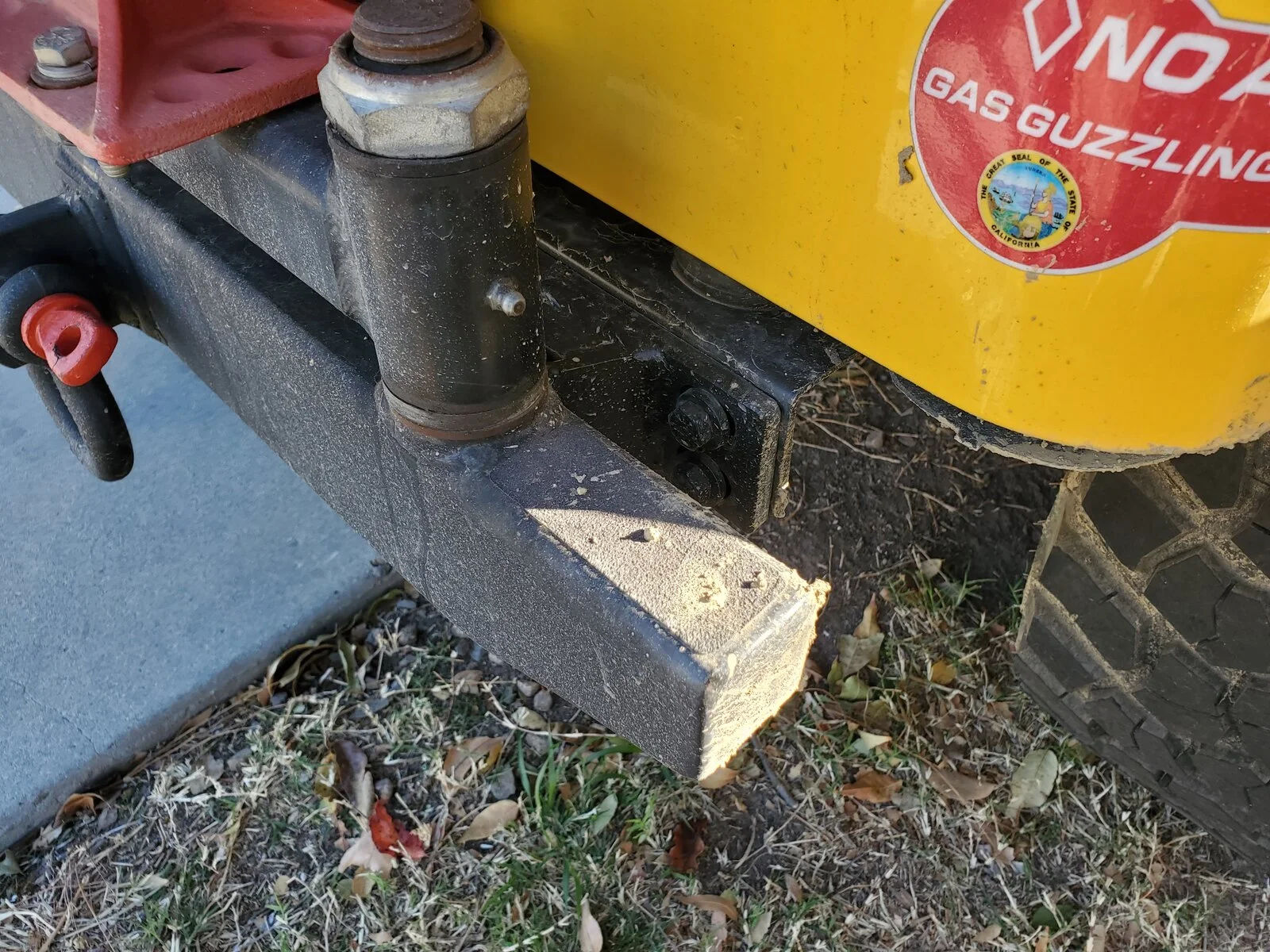

If you do get a rear bumper, it will be worth it. I've had mine for 10 years and it has never failed me, given me vibration, or shown wear. It's heavy, but built like a brick dunny. And, you'd be buying American.

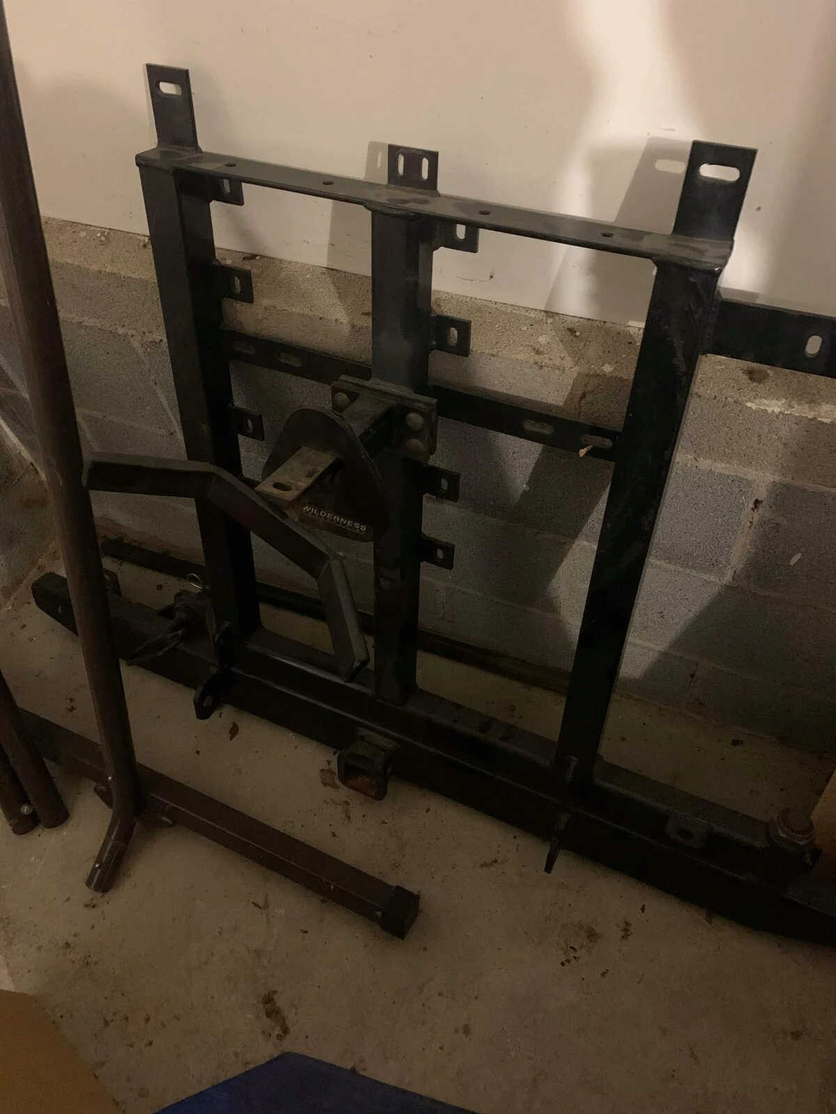

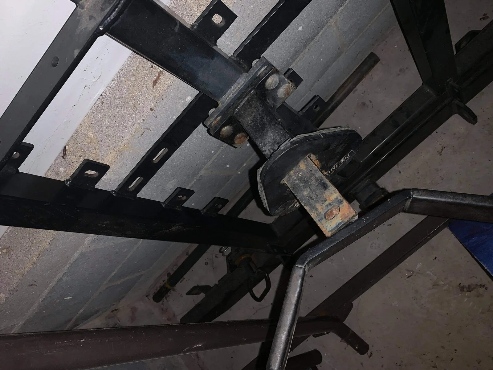

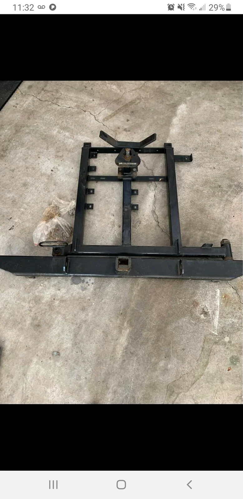

So I found another listing for what appears to be a Garvin Expedition Bumper (Older Style).
The person listing it says they arent sure what model jeep it goes on. Apparently they bought the house and this was in the basement. Anyway to confirm this is for a TJ?
If you can, get a look at the back side. See how it attaches to the frame. Either way...no reason you couldn't make it work even if it was made for a YJ.
Whatever bumper you get, make sure you use frame brace brackets. Just about every TJ bumper manufacturer offers them.
Otherwise you risk tearing the rear crossmember off of the frame, with the bumper and everything else attached
Good point. The listing says it comes with all "Hardware" but I won't believe it until I see it.

It looks like Garvin updated their latching mechanism and sell a retrofit kit for the older bumpers like the one I am looking at.
The older ones appear to have a screw type T handle. Is this something I should look into upgrading?
