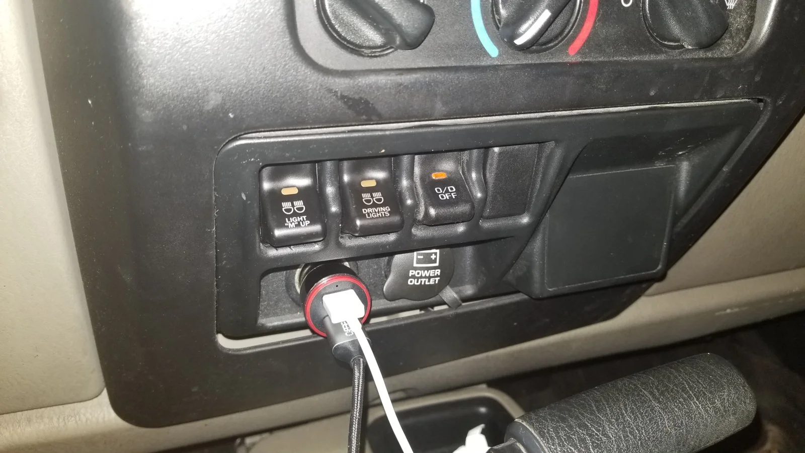

Where can I get a set of switches to replace the factory blank one? Do these just pop out? I want to add rocker switches in there but I cant find one with them already. But if I can just pop them out and put my own, I'll use the one I have.
View attachment 25650 Where can I get a set of switches to replace the factory blank one? Do these just pop out? I want to add rocker switches in there but I cant find one with them already. But if I can just pop them out and put my own, I'll use the one I have.
Yes you can, you have to pull the center off to get to the area but you can put rockers in or check ebay people make ones that look factory
Reactions: i.chevrette
Only problem with the aftermarket ones is that the little picture doesn't light up when you turn on your headlights. It bothered me so I bought a factory fog lamp switch and an aftermarket switch. Then I just put the aftermarket switch face on the the factory switch so they light up like the factory one would
