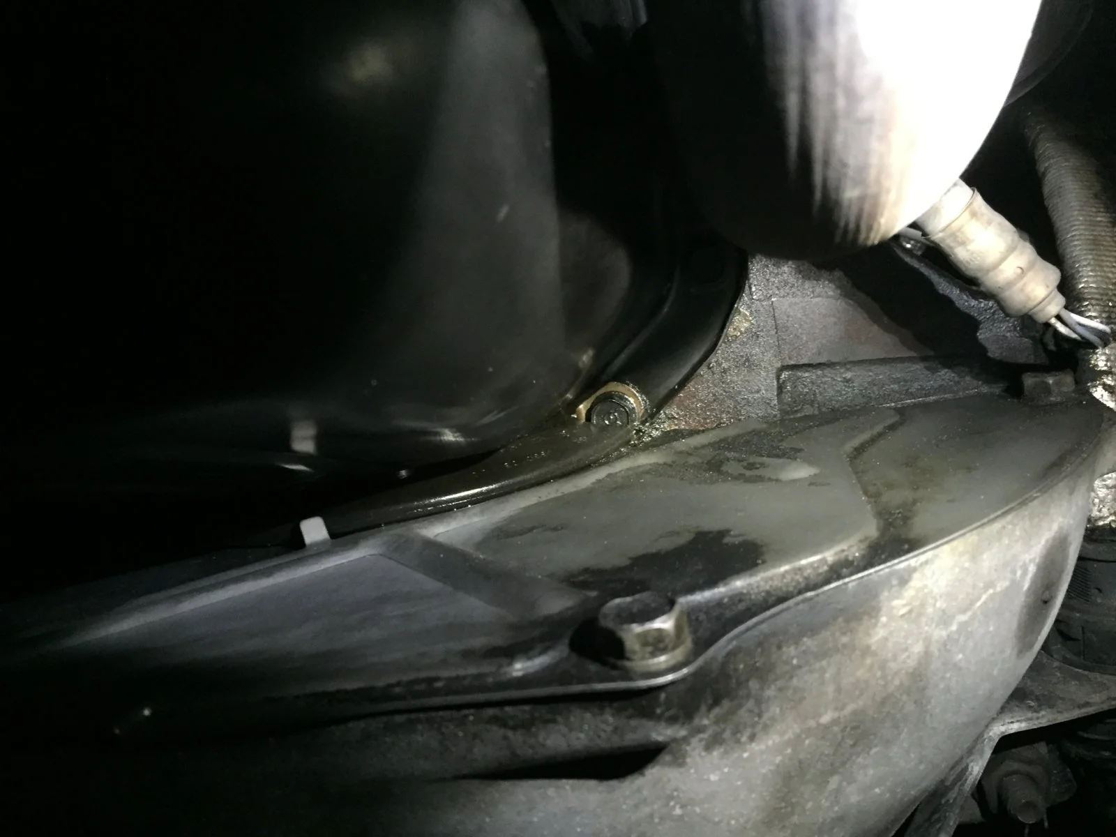

So I'm on to the next phase of working on the Jeep, and that is locating the source of an oil leak that appears to be getting worse. I always thought that I had a small RMS leak, but after some searching the consensus is to start from the top down and start with a check for a valve cover leak first. I checked last night, and the back of the block appears to be fine. However, when I got right up on the oil pan with a flashlight I was able to see a faint oil trail coming down the side of the pan and then collecting to form a drop right at the drain plug bolt.
Following that trail up and forward, it appears that the oil leak starts in the middle of the pan on the drivers side. There is quite a bit of gunk built up in that area, but from my visual inspection it looks like it is traveling back along the pan and then dripping down the side and also back to the bell housing, then dripping down and collecting right at the RMS.

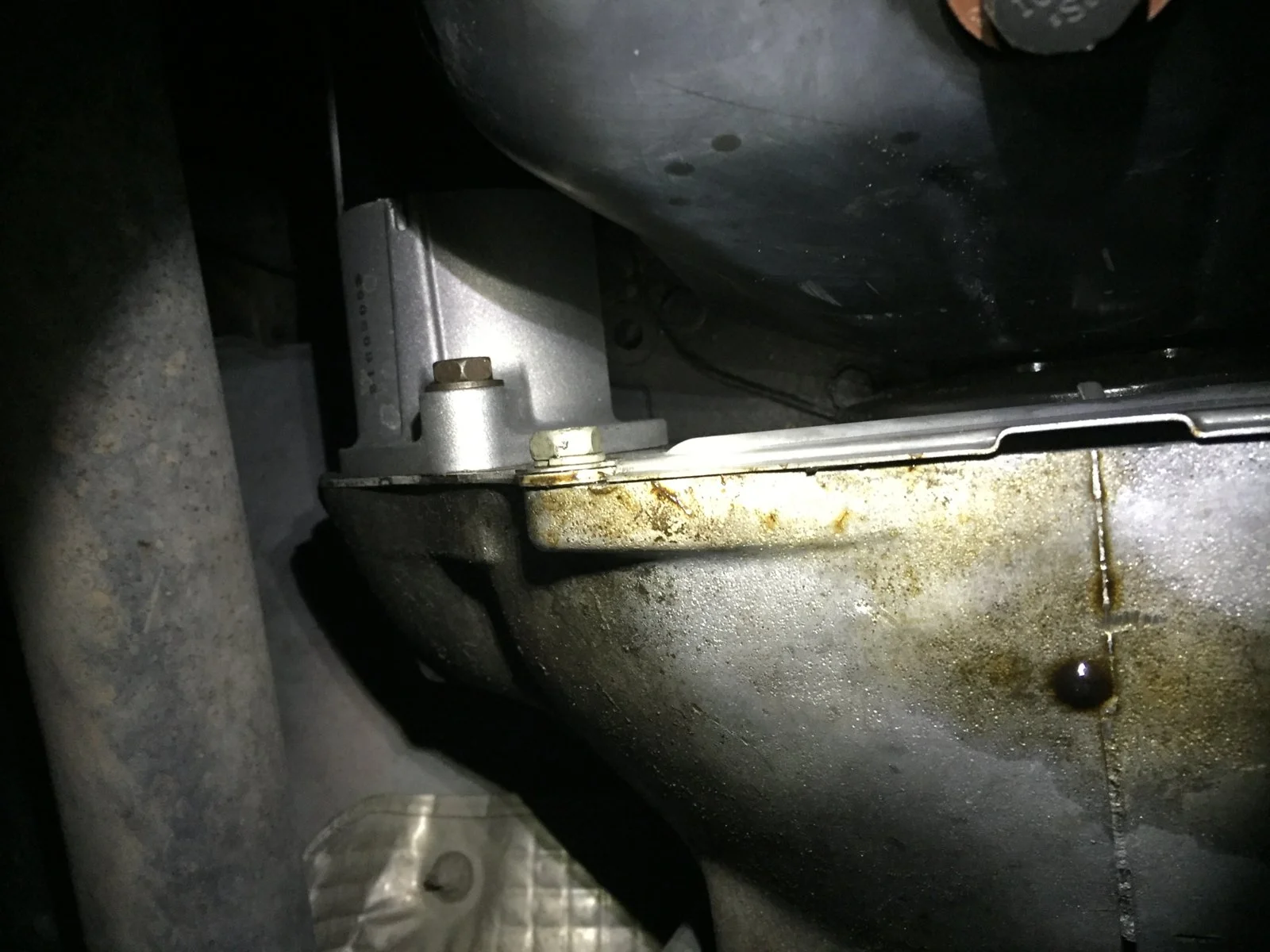

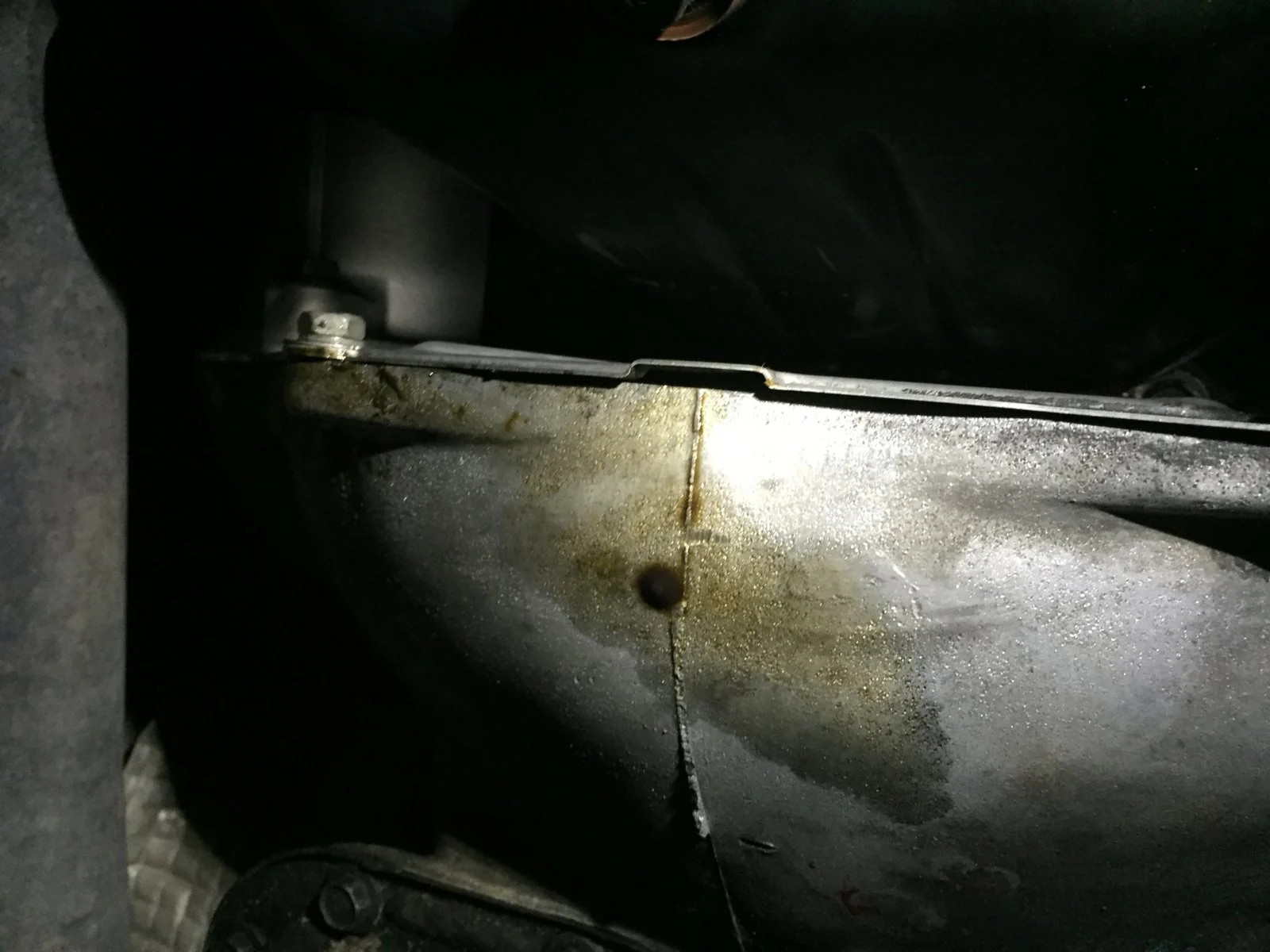

Okay, so oil has shown up again. It's not on the side of the oil pan like I thought. It showed up on the bell housing, and it looks like it begins at the starter. Does the RMS leak from behind that plate on the bell housing? Is that why I can't see the source?
Right above the starter is the oil pressure sending unit. Mine failed and slowly dripped down and collected on the bellhousing. Took me forever to find it.

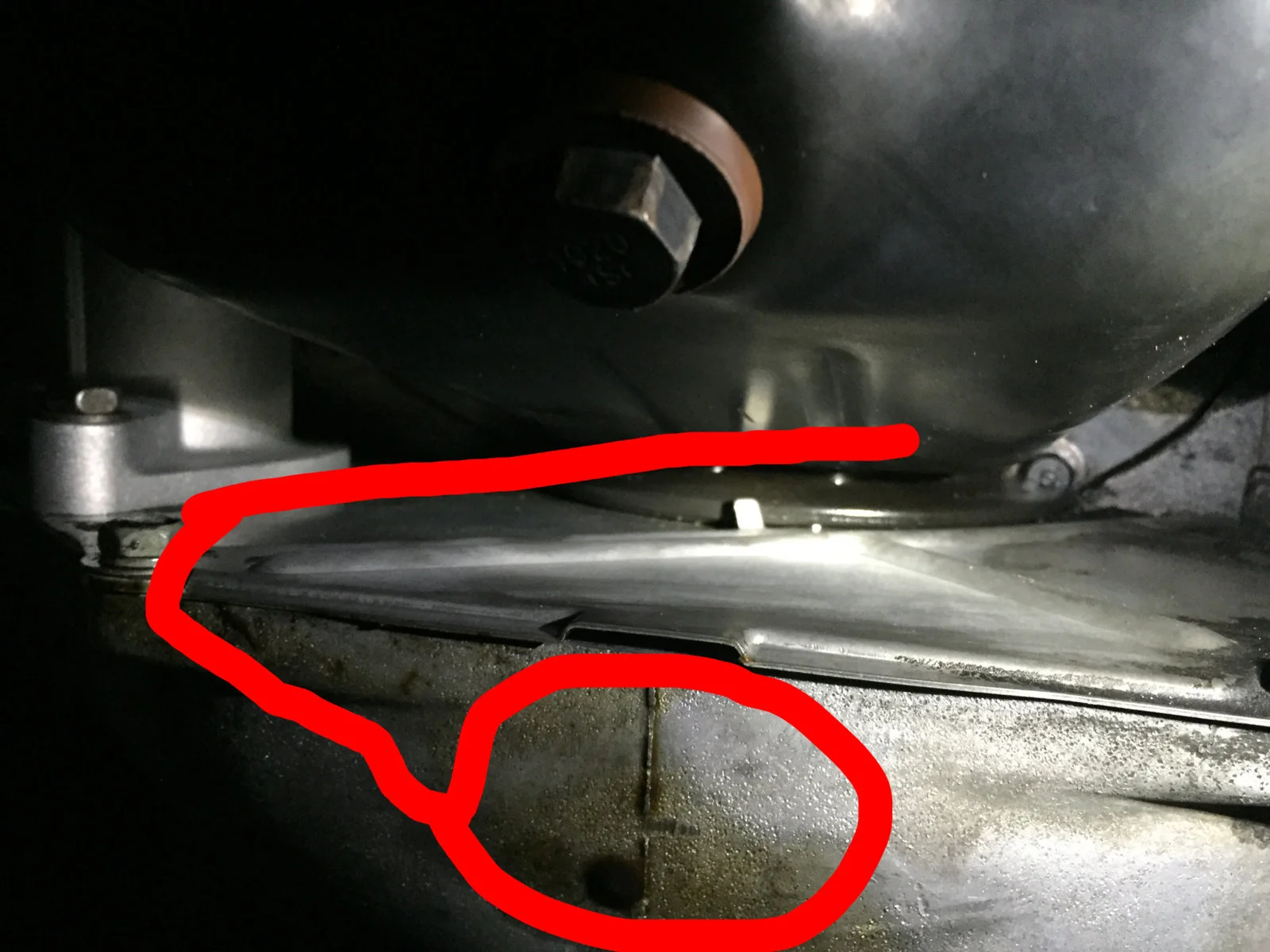

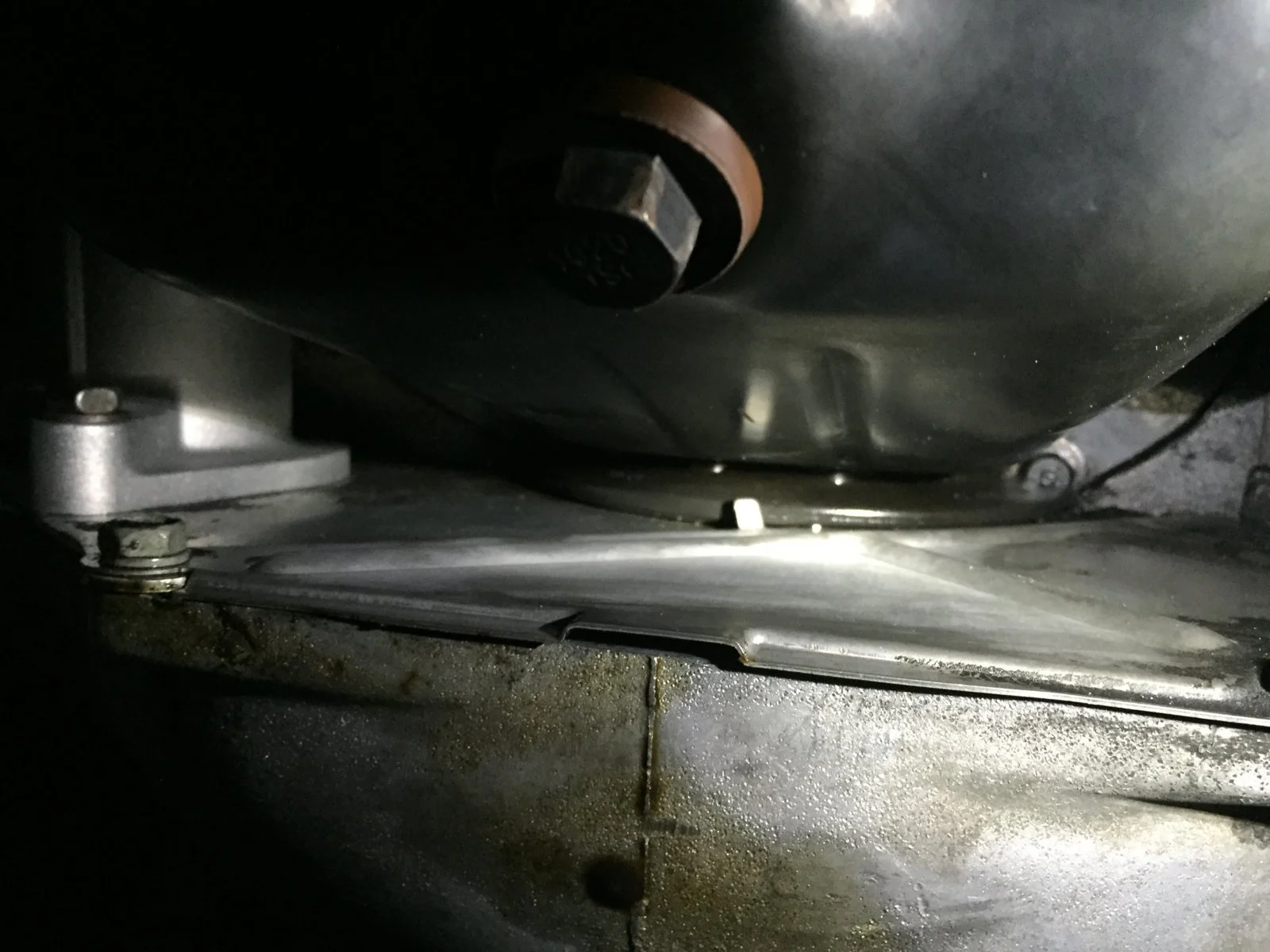

I checked the sending unit again and it looked fine. I think I figured it out though. It's flowing down on the lip of what looks like a outer piece of a two piece cover on the bell housing, following the line below.
Looks like the rear main seal might be leaking a little. Mines doing the same thing. I have an 05 with 2.5l and 6 speed. I was under it the other day and noticed it was seaping oil around the dust cover/inspection plate. Guess I'll pull the trans here in a couple of weeks and put a rear main in it and a new clutch while I'm there
Mine had literally the exact same leak, in the exact same place. Turned out to be the rear main (go figure).
