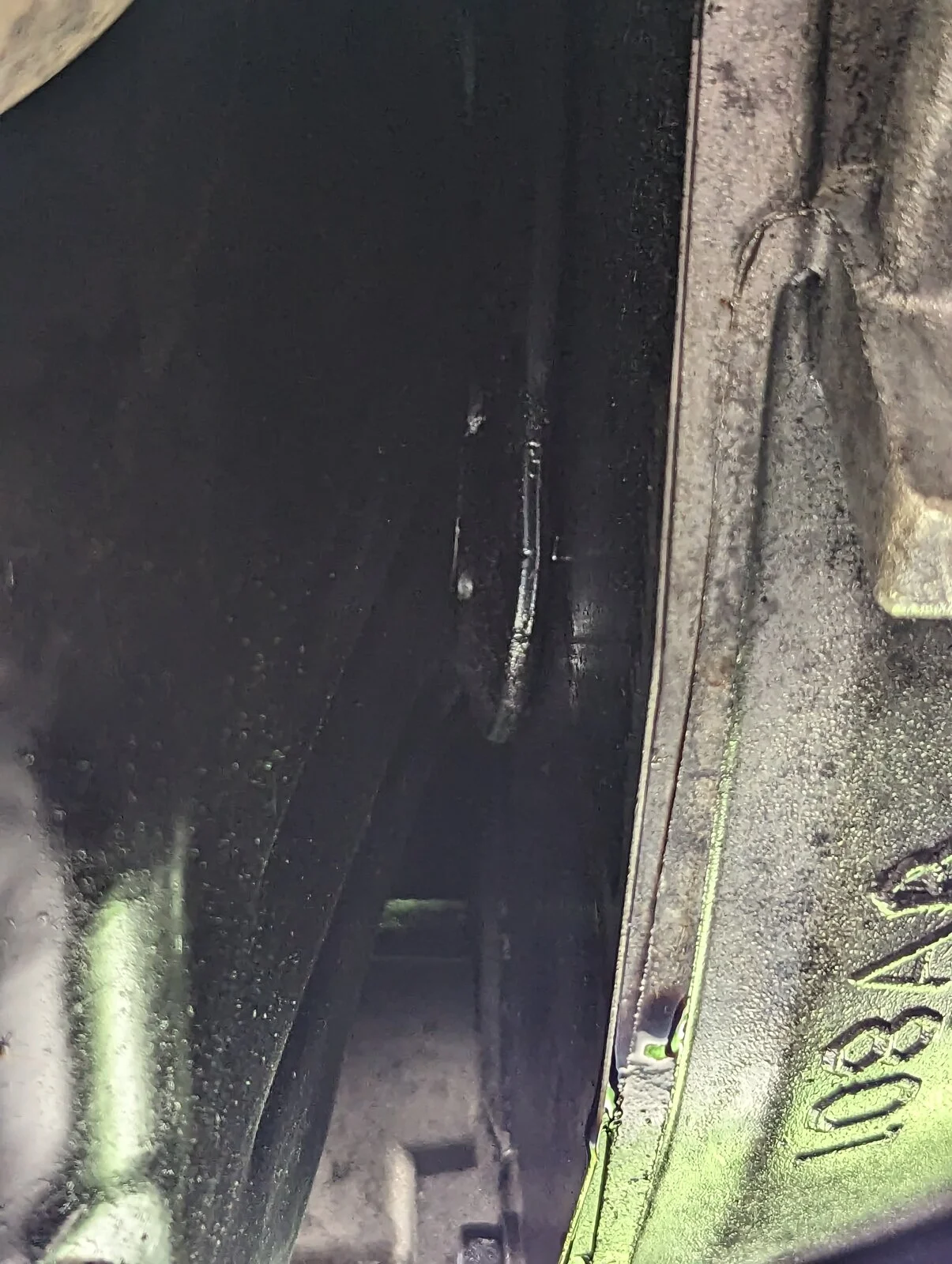

I've been trying to hunt down and stop this leak for a while now. I've replaced the rear main seal as I thought that's was the problem. Also place the seal on the oil pan. But I'm still leaking oil in between the transmission and the engine. It's really starting to add up so I'm trying to get suggestions on if any of you guys have seen this before and how to suggest to fix it. I really would like to be able to park in my driveway without creating a bigger oil stain.
As you can see in the picture some oil gathering to drop.
have you checked the rear of your engine for oil? the valve cover will leak on the rear of it and run down to the same area as your rear main seal.
