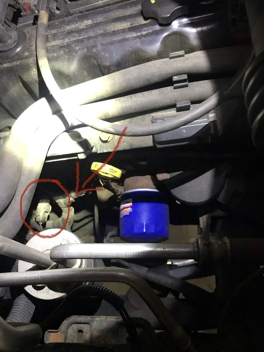

This may be a dumb question but I’m looking to replace the oil pressure send unit and I’ve seen so many conflicting locations for this part.
I have a 2005 LJ. Is the red circled item in my photo below the part?
MutantNinjaTJ
Jul 21, 2018
347
The sewers of Newer Mexico!
If that's not it you pretty close, I can't see the sending unit in your picture but it's a little round gray pot that screws into the block at the very rear passenger side of the engine blow the valve cover, Be careful talking the wire connector off the sending unit, it's pretty tight there. Figuring out the connector release is the hardest part of the repair.
