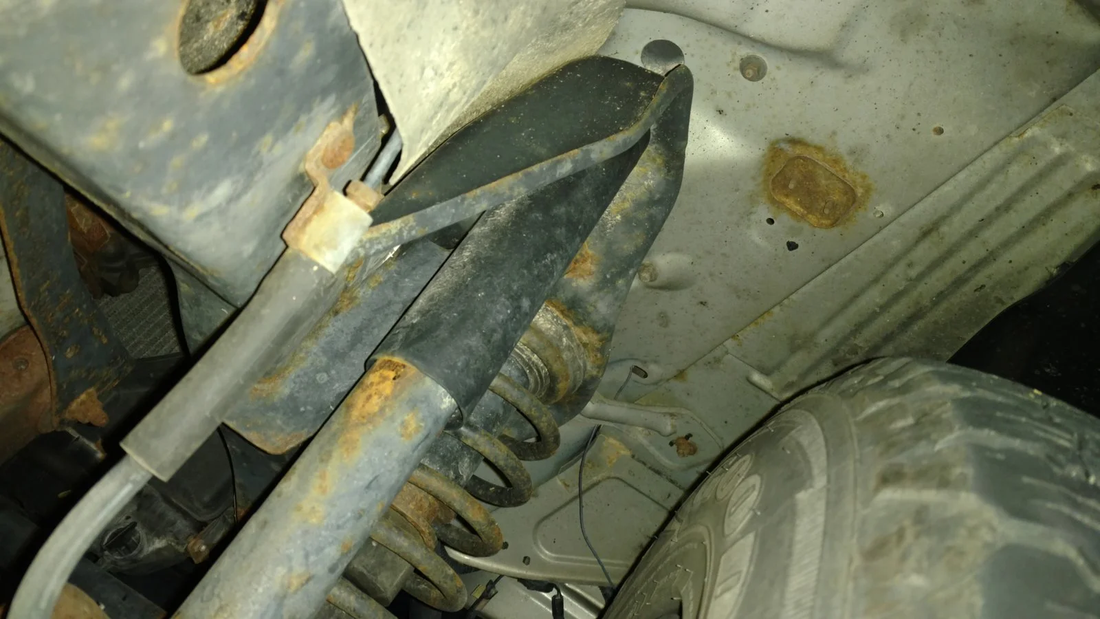

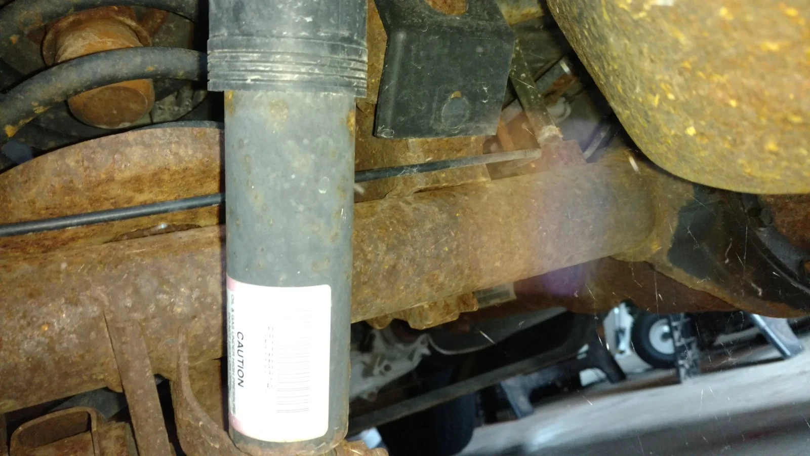

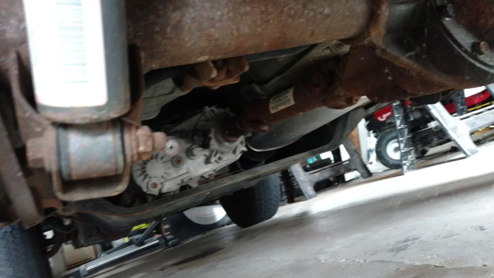

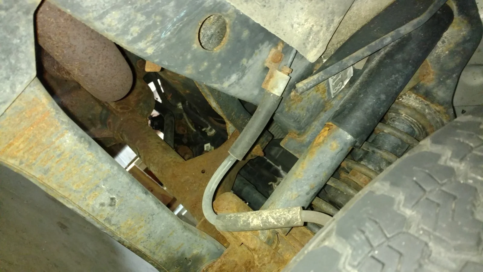

So, I'm going to lineX the underside of my TJ later this fall, but after reading some stuff, I just want to make sure I'm not really wasting money on my Jeep.
I'm the second owner and I've had her for 3 yrs now. Always garage kept and I don't drive it a whole lot. I've put 7k miles on in that time (70k currently). And the original owner did have it Ziebarted when she purchased. I really love this little Jeep and want to keep her for a very long time! My other vehicle is a 17 JKU that's really our daily vehicle. We had the jku treated when we bought her (I know Ohio winters suck) with the lineX underneath, seats, and paint. So I attached some pics for any good advice. Please and thank you!

Wow it's amazing the difference in Northern Jeeps and Southern Jeeps. If rust is really a concern for you then go down south and get you one to put in your garage. Looks like even with the PO’s treatment it’s still rusting.
Seems like its just a thing you have to “deal” with up North in the winter. Most people see Jeeps up there as tools for winter driving.

Oh man... that rust isn't good, really. Not that any rust is good, but that rust you have there is far more than just surface rust.
I realize very much that I come across as a "rust snob", but I'm telling you, after my experience with the rust issues on my old '69 Camaro, I'll NEVER deal with rust again... ever. It's the worst kind of project IMHO, because it gets into all the cracks, crevices, and places you'd least expect it.
Like cancer, if left untreated it continues to grow more-and-more. My goal isn't to scare people (well, if they're looking at purchasing a used TJ with rust, then I suppose it is), it's to let them know that rust is the death of these things.
If you don't plan on keeping it that long, then I suppose no big deal (though it does drastically affect resale value). However, if you plan on keeping it for a long time, you have to take care of it.
Here on the West Coast, we're spoiled. We don't really have to deal with rust on our vehicles. Admittedly, that does make me a bit of a rust snob.

The frame itself looks good actually don’t get all bent out of shape about it. The only part that looked like it had a lot of surface rust was your driveshaft. If you can get away with not driving it in the winter that’s going to be the only way to have a rust free tj. If you could get it up on a lift and sand done the surface rust with some pads you could hit the frame and the other areas that have surface rust with some flat black and it would look good again. Not sure I would likex the underside.

Put your finger in one of the bigger, round holes in your frame. If you can pull a lot of chunks out of the frame, then you're in trouble. If you can't pull very many chunks or there is only surface rust, you're most likely fine for now.
Surface rust doesn't mean much on TJ's. The only thing that matters is the rust on the inside of the frame.
Reactions: fourpointzero
It doesn't look all that bad. Pics of the frame at all the bracket points and transfer case skid to frame connection would give a better idea. Bang on the frame with a hammer, it should sound solid and metallic, not dull and "soft."
If all that looks good, a rust neutralizer and Fluid Film or similar should take care of it. Being diligent in rinsing off the road salt will go a long way in protecting your TJ.

My 2 cents (from the salty rust state of NJ) I wouldn’t seal coat anything in the fall, when its typically cool and damp. Unless lineX completely seals out moisture or oxygen, I would not lineX my frame. If moisture or oxygen penetrate the coating, there’s no doubt rust will follow. Last thing I’d want is something camouflaging the rust until it’s too late and the surface or structure is compromised. The good old ‘bubbling’ too commonly seen on vehicles.
Wire the surface rust and treat it w Fluid Film or CRC marine rust inhibitor. And as you do now, keep it garaged and out of the snow in the winter. Sucks, but that’s what I do.

Keeping it out of the salty winters is the only way to 100% make it last. Undercoat/powdercoat will just mask it for now. Frame looks pretty good from the pics, but several salty winters could change that going forward. Garage it for the winter and enjoy in the nice months.
