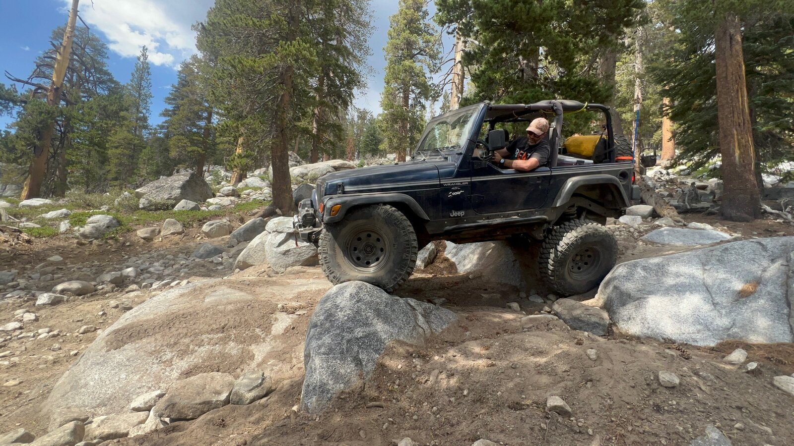

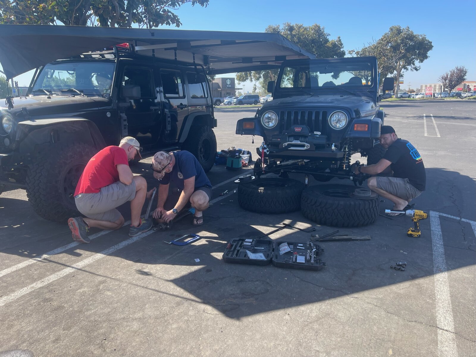

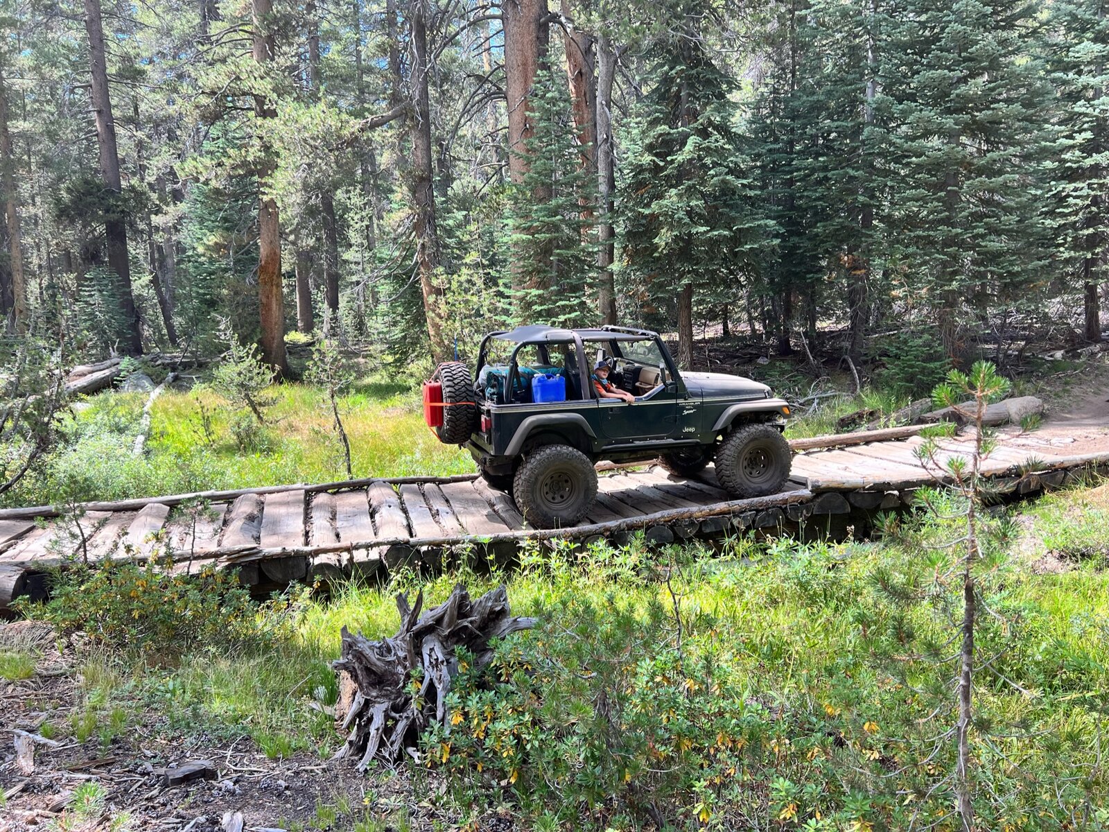

Got started Friday afternoon — first time having the Jeep up to highway speeds for more than five minutes, and realized I was smoking. Stopped and smelled gear oil, checked axles, and found that the front locker air line had melted off the bulkhead. Axle was HOT. Figure I smoked a bearing, so stopped at the nearest Oreillys, bought a few tools I wasn't expecting to need, some extra U joints, and off we went to pull shafts in 105* heat. Thank goodness for the new awning:
Back on the freeway, she drove fine the rest of the way to the trailhead where we camped for the night before reinstalling shafts and heading up through Chicken Rock/Voyager and eventually Thompson Hill for day one. TJ did great. No breaks, no winching needed, just nice-n-steady all the way to the top.
Passed a couple of full-size rigs (you can kind of see in the background here...Ram and Suburban), which was a helluva thing to see up there. They also had a couple of TJs. Unfortunately, we would be stuck behind/with this very rude, very loud, very disrespectful group for the rest of the trip. After almost burning down Ershim camp with a can of gas out of control, I think other non-ethanol and non-plant-based chemicals came out that kept them up and rowdy until the wee hours of the morning. Camp etiquette is apparently a lost art.

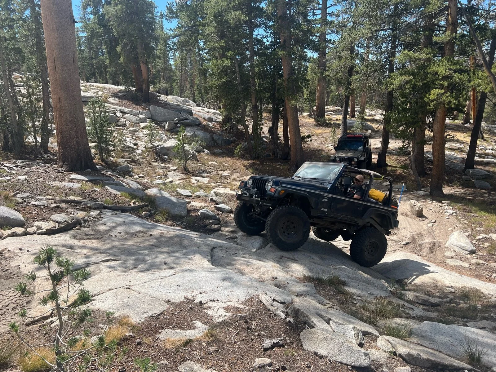

Camped at Thompson Lake that night and had a great time. Woke up the next morning to some fun stretches for about 3-4 miles. Beautiful meadows and some mildly technical and tight spots, but nothing gnarly.

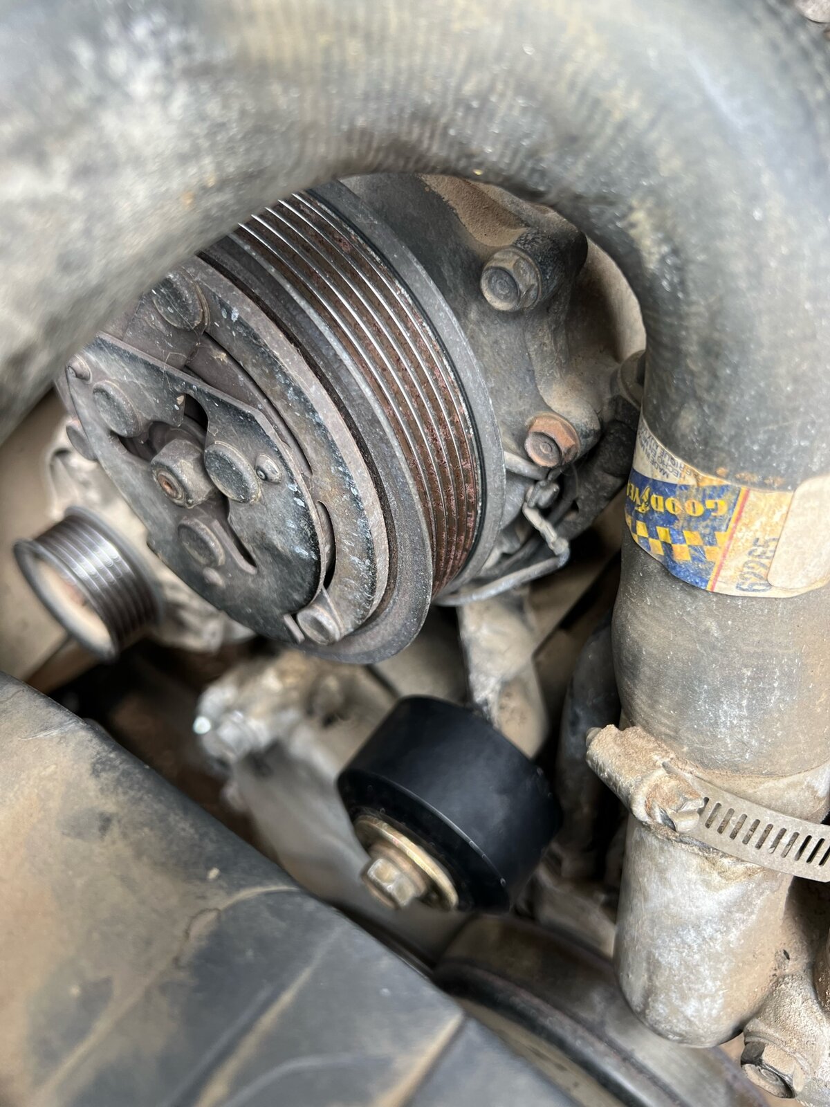

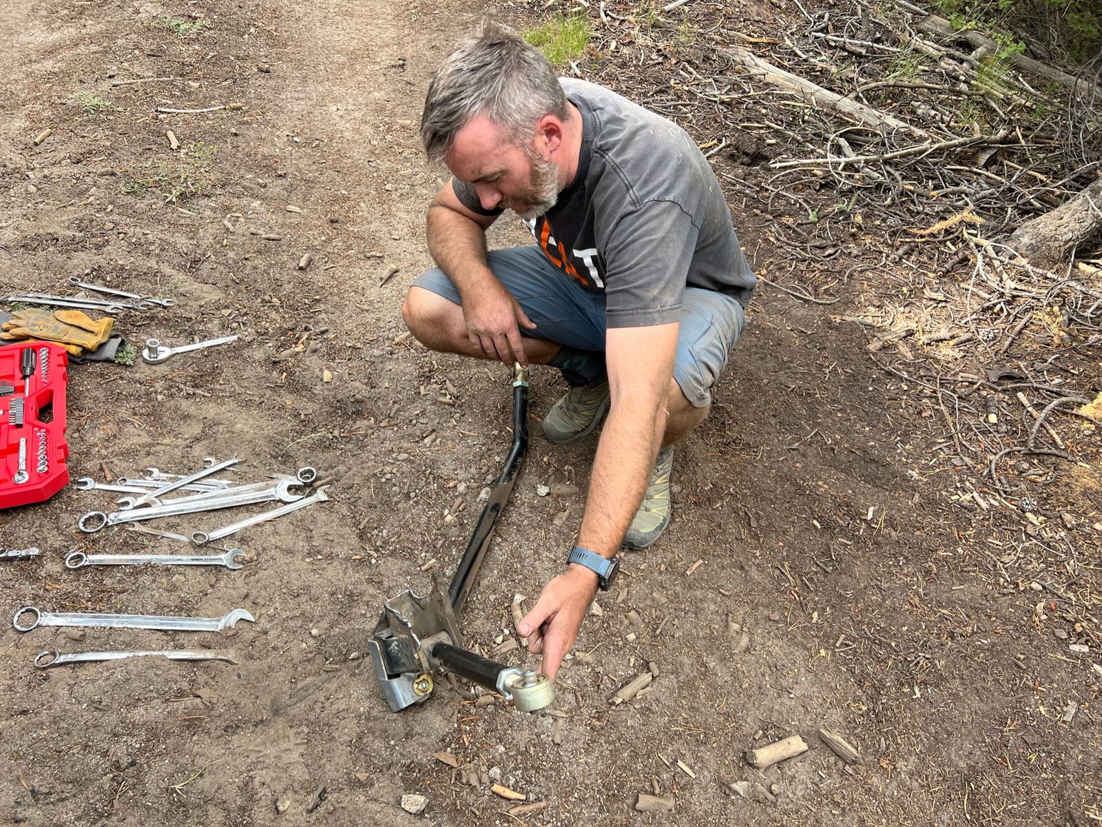

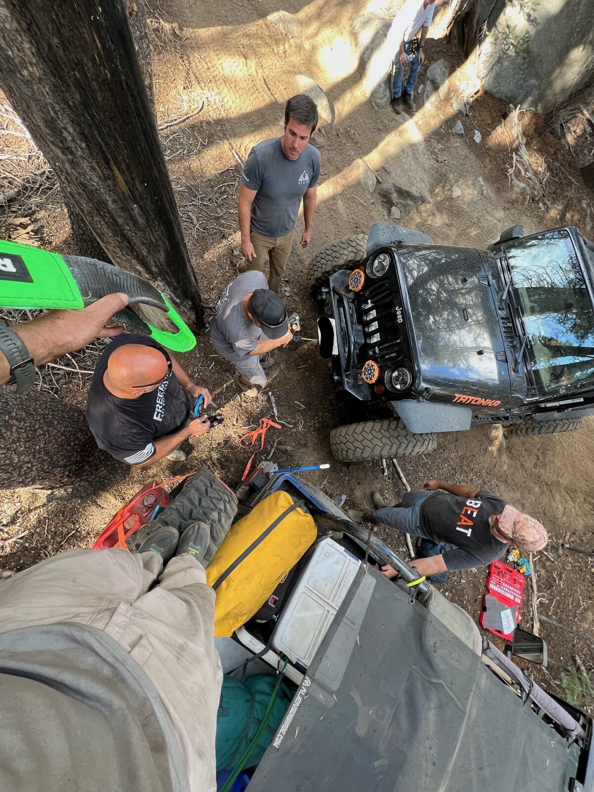

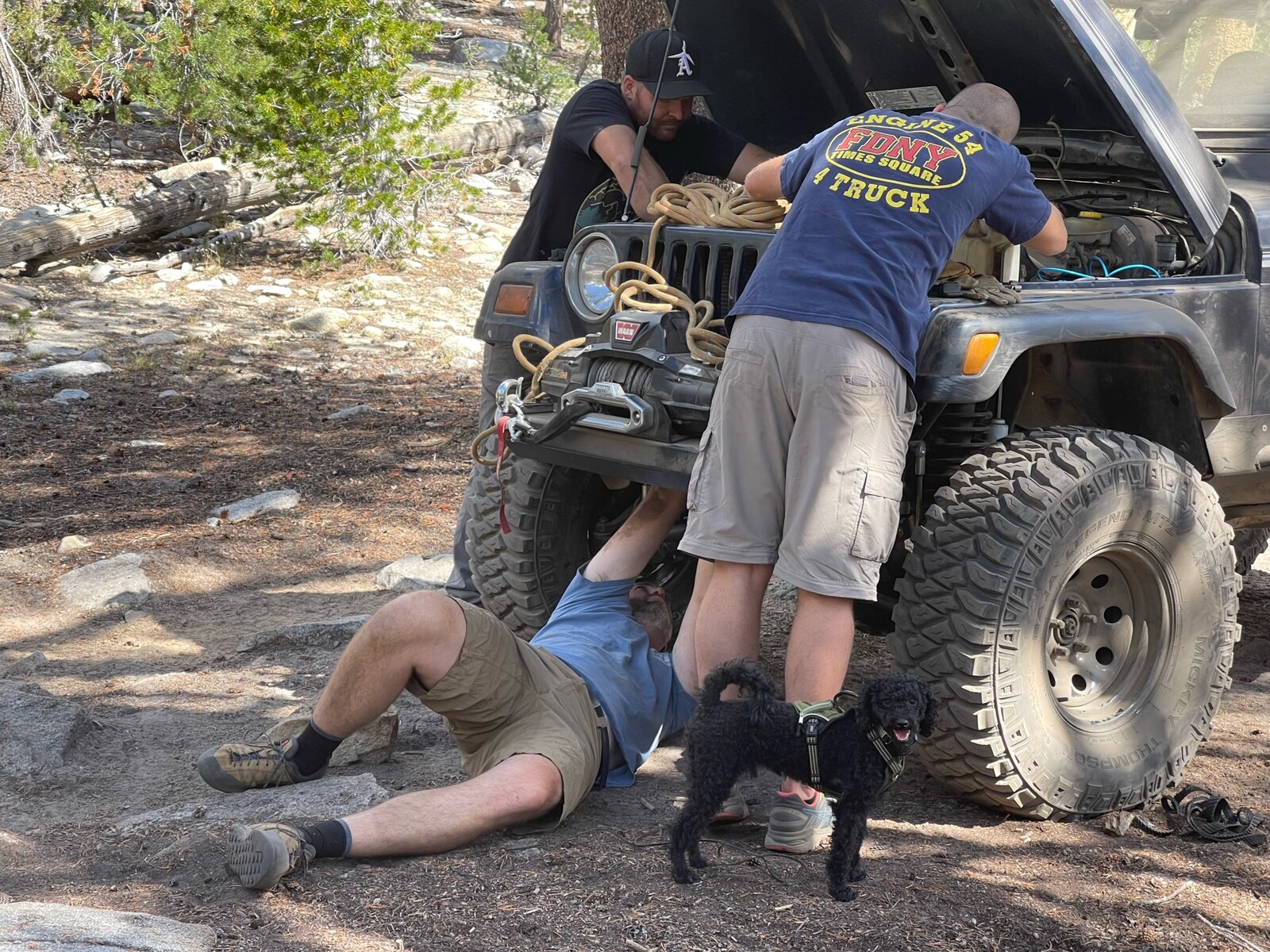

A couple minutes later, I heard a chirp from the engine compartment that got louder, then a squeal, then smelled rubber, then saw smoke. Uh oh. This was EXACTLY at the mid-point of the trail.

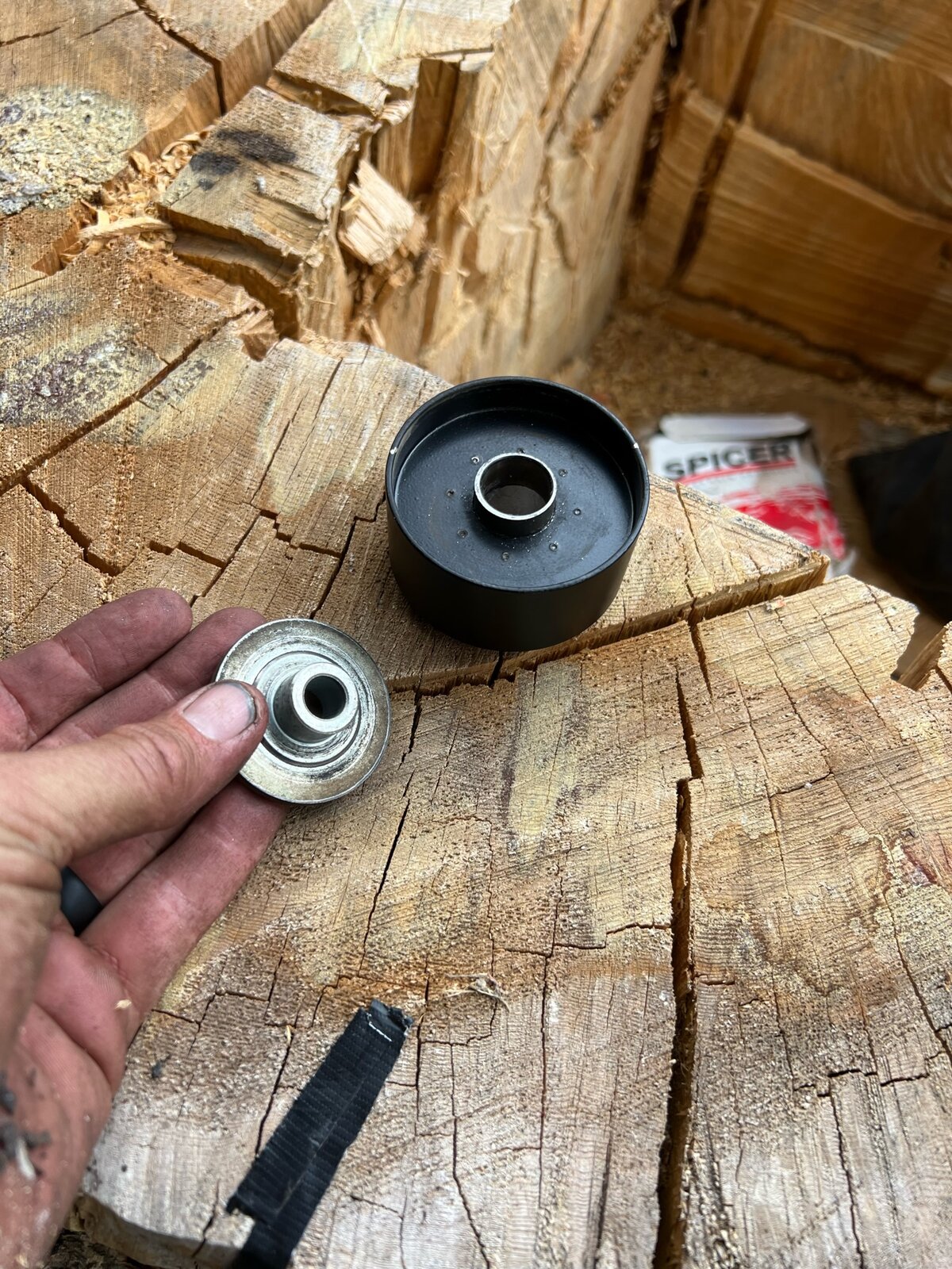

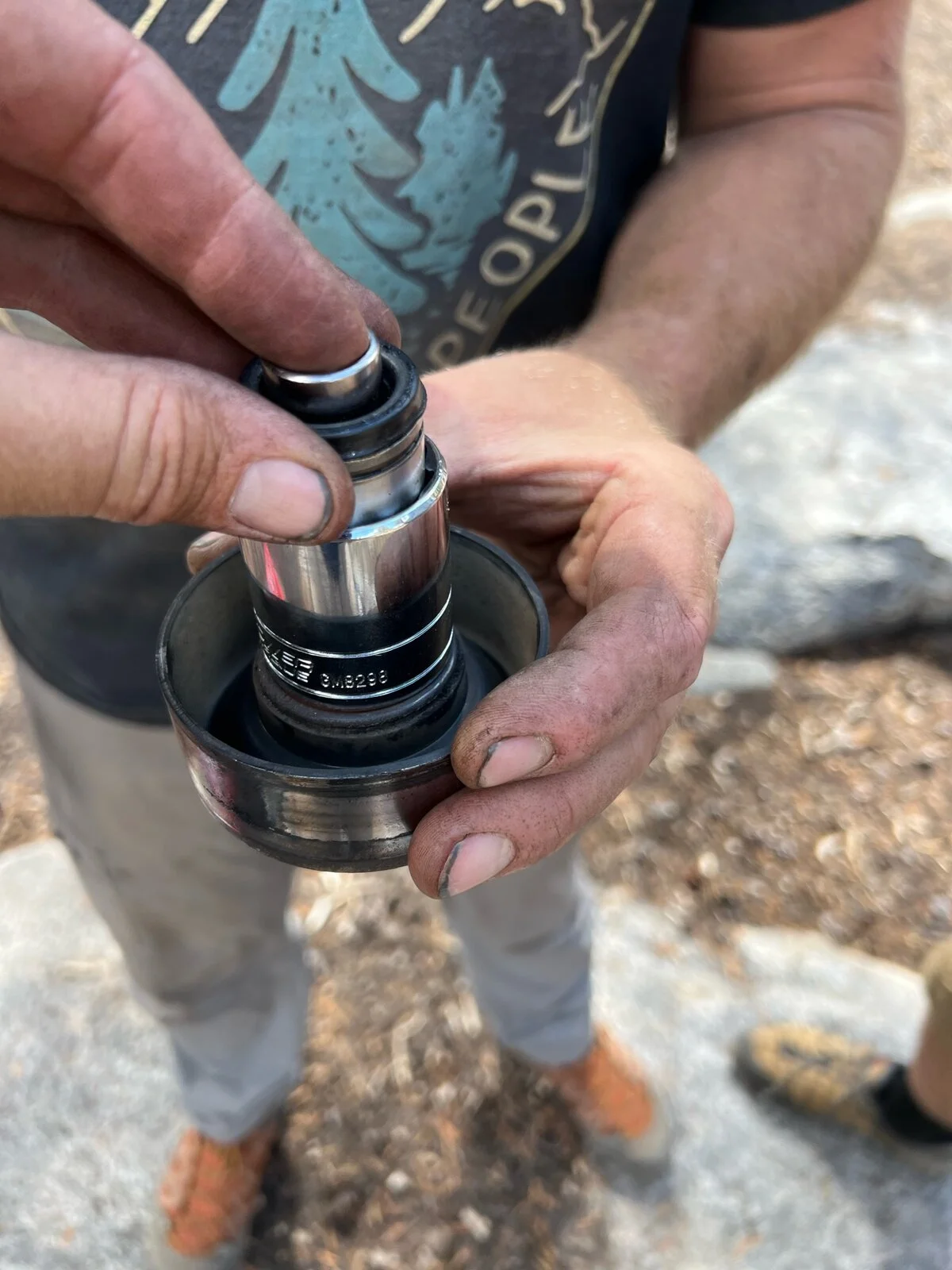

Belt was gone. Upper idler pulley bearing seized and shredded the races. Time to get creative.

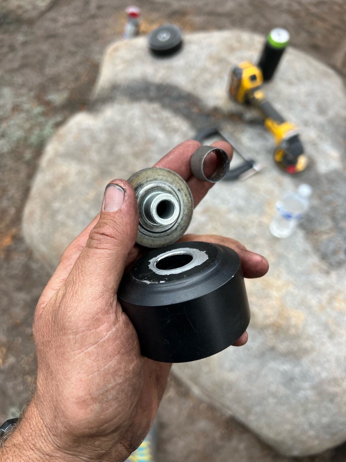

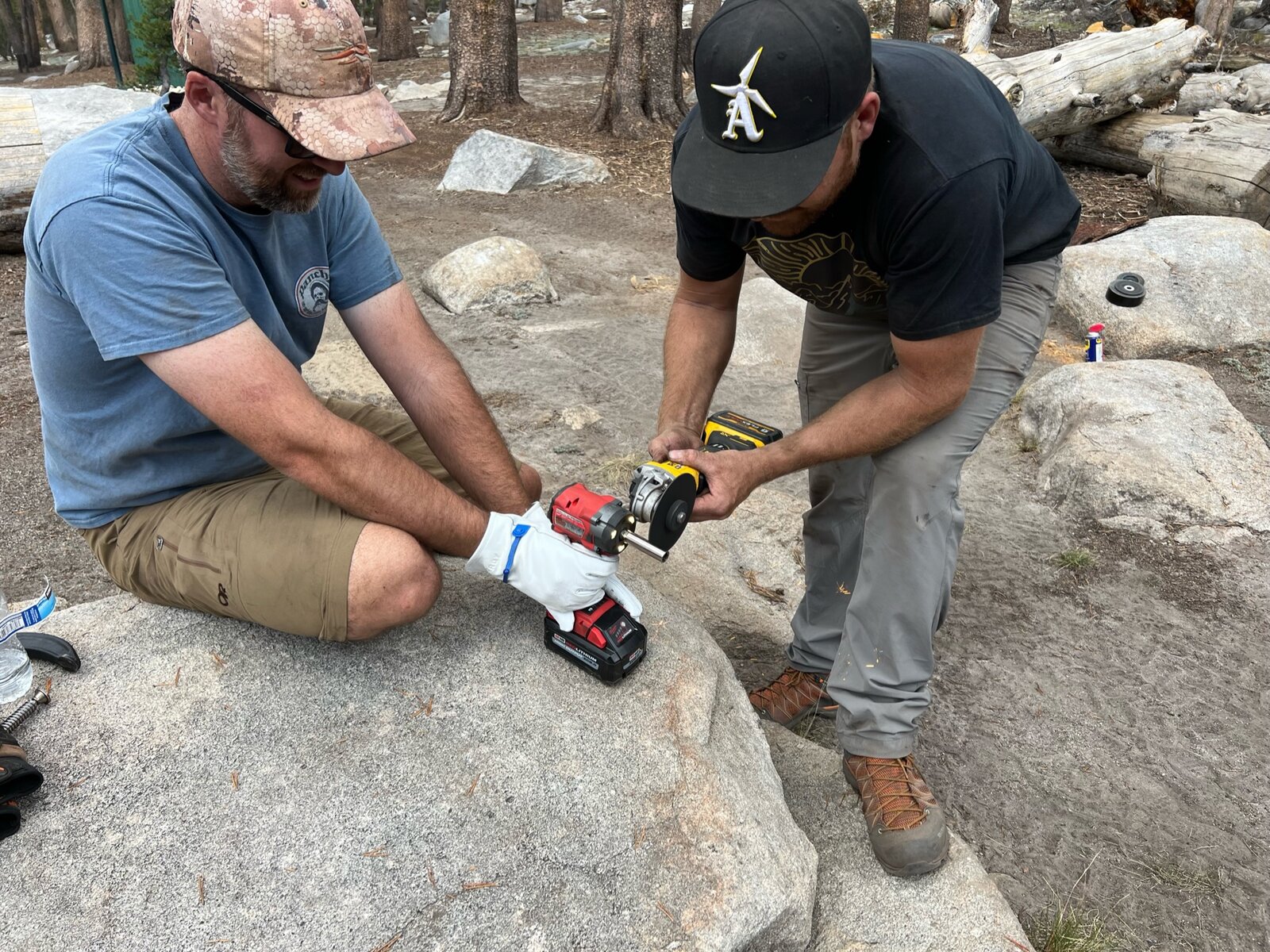

Modify socket and ujoint?
Too much cutting of strong metals given what we had available. What did we have that was roughly the same size as the idler pulley itself? Oh...aluminum body lift pucks! We needed to grind down the hardened steel washer/flange so that it would fit the hole, then cut a socket to fit inside that, then bolt the whole thing back to the aluminum bracket in the compartment. Trail side machining at it's finest:
It bolted up, but only on a couple threads, due to the width of the puck. It looked good:
It acted like this:

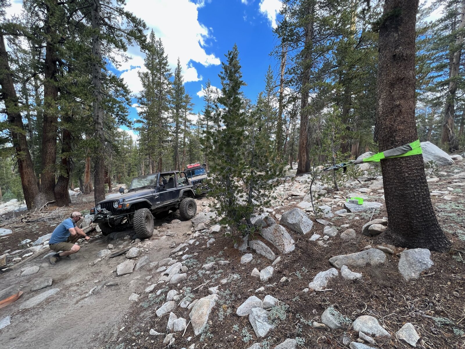

Well, dang. We were SOL. Time to tow at least to Ershim and figure something else out.

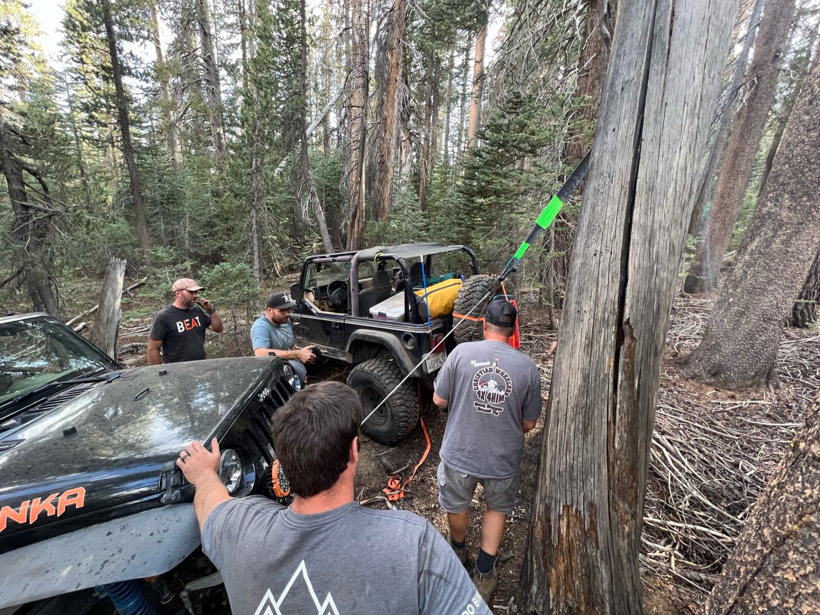

Now, towing without power steering really really sucks because a) it's a lot of muscle and b) you can't dodge stuff easily. Because Dusy is so tight, we dragged the right fender into a tree and the left into a rock within the first three quarters of a mile. Oh well, an excuse to get flat fenders.
Shortly thereafter, I get pulled sideways into a hole, and lose a bead:

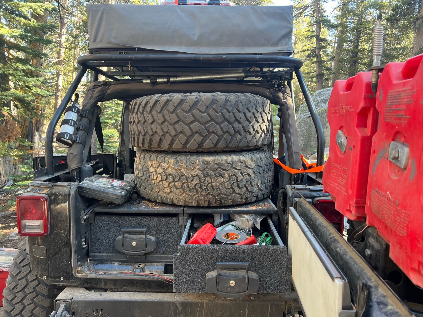

Get that back on, and a half mile later, JK cuts his SECOND sidewall. Uh oh. No more spares. JKU runs 8-bolt axles and the wheels don't match up. Things went from bad to worse:
It's getting late. We have the wife and kids to think about, so we pile all the essential gear into the JKU, tarp the broken rigs, and leave 'em trailside. The families hike the last four miles to camp at Ershim Lake while two of the three dads haul ass to set up, and try an overnight haul down to get parts/tires and come back.

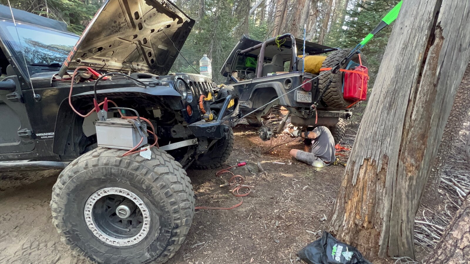

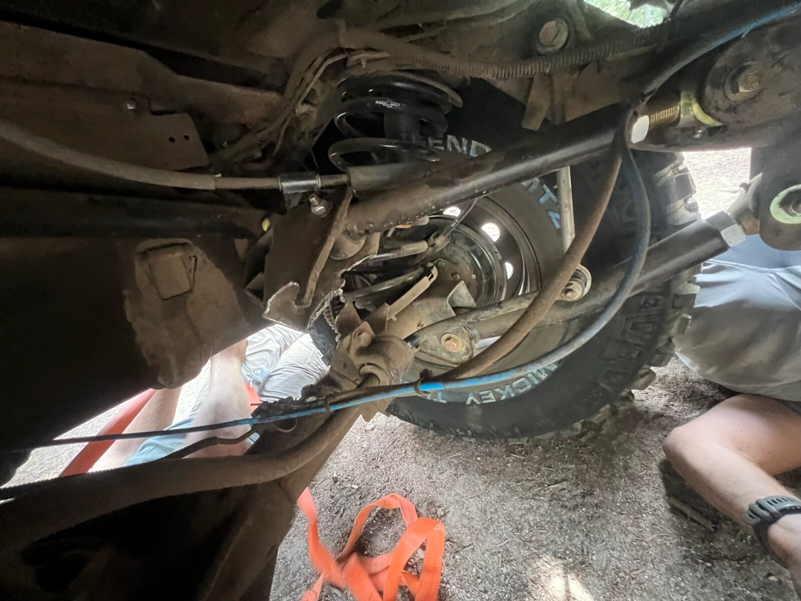

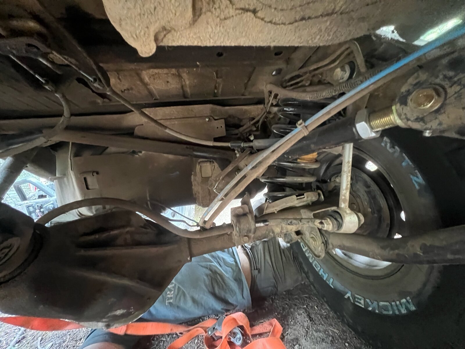

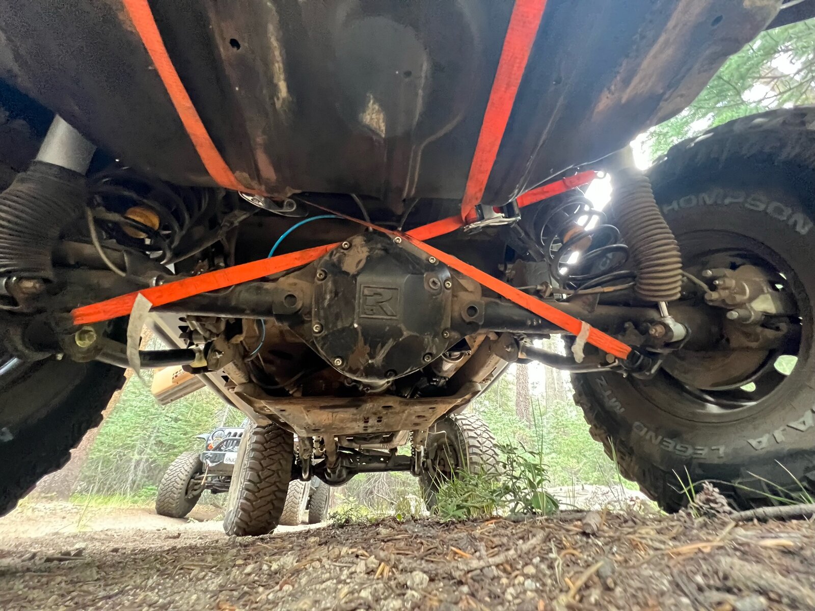

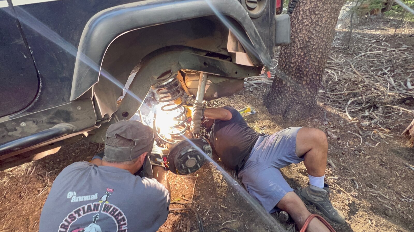

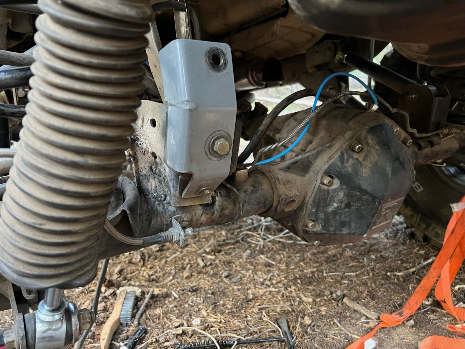

A couple miles down from thompson, and I smell burning rubber. Check the engine compartment again with a sigh and find nothing. Start looking around and find the left rear rubbing on coil. Uh oh:

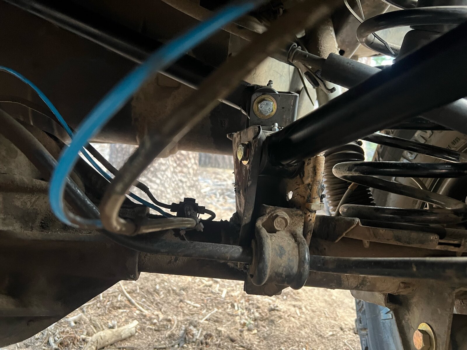

Bracket completely sheared from the rear. We attempt to strap it up in hopes of limping it back:

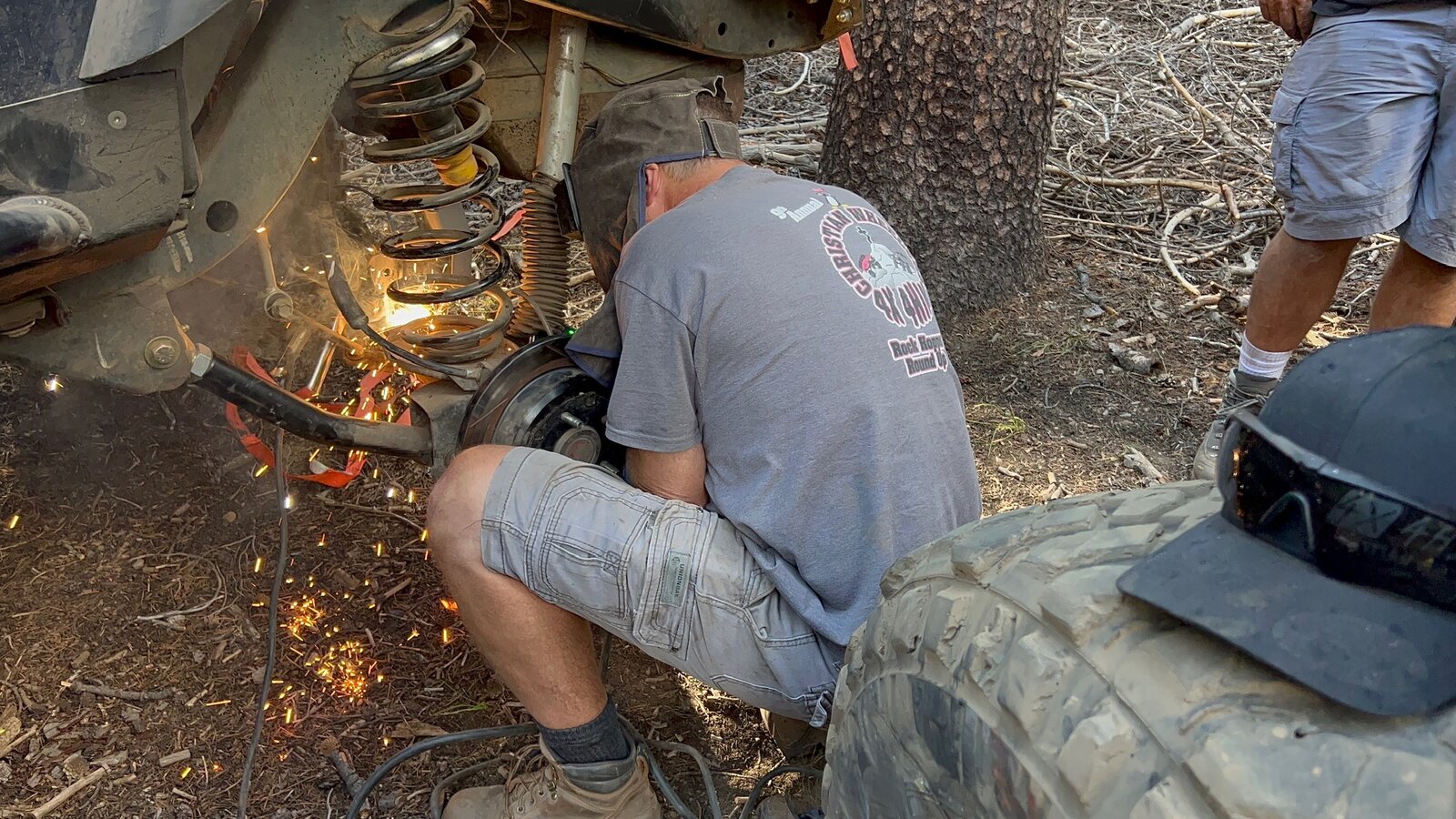

But she doesn't go. Fully prepared to ditch it trailside and come back this weekend, we are saved within minutes by a group coming up with a welder at hand! We get the rig in the air and they go to work:
We take down the model number for the welder that is now a must-bring, hook everything back up, and baby ourselves back down to the lake where we can take the high-water line and do our best moon buggy impression:

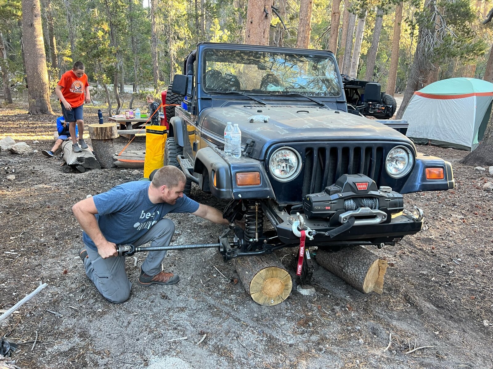

We make it out, remove front shafts in under 20 minutes (we're fast, now) and motor back home.

That upper control arm bracket with a raised track bar bracket is a known and common failure. Look up posts on this forum and you will find references onto how to reduce that load from the raised bracket. I added a welded on gusset to mine and it seems to have held up well over the last few years.

I got the opportunity to use a friends Karnage Trail Welder during my last trip and I was surprised at how well it worked. It is much more expensive than utilizing car batteries with leads and electrodes, but it is very convenient and burns great. It is on my list of things to buy if my company ever gives us a bonus again (so I will probably never have one). Something to look and consider, it definitely works good.
