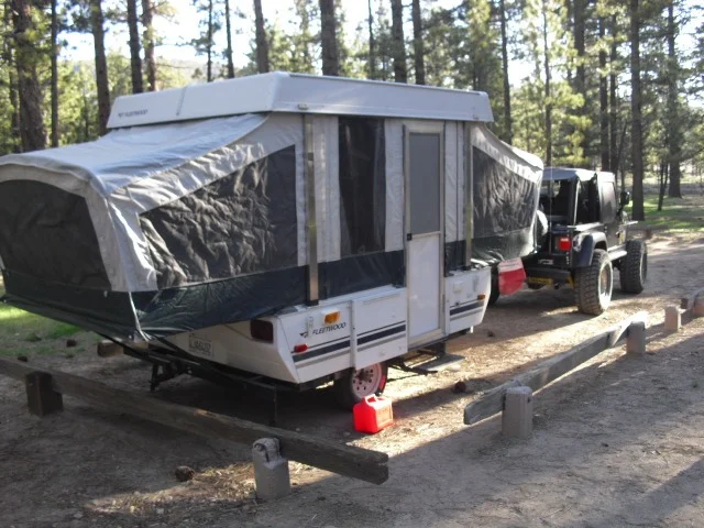

Jerry what kind of trailer do you have?
I tow a Fleetwood Taos pop-up tent trailer.
Awesome! I have been thinking about getting a Runaway RV trailer and have been curious how our Jeeps tow. I will have to wait until after my gears are installed though! :) Do you know how much your trailer weighs?
The spec says 1245 lbs. unloaded. I may carry an additional 150 or 200 lbs. including 5 gallons of water in mine at the most.
