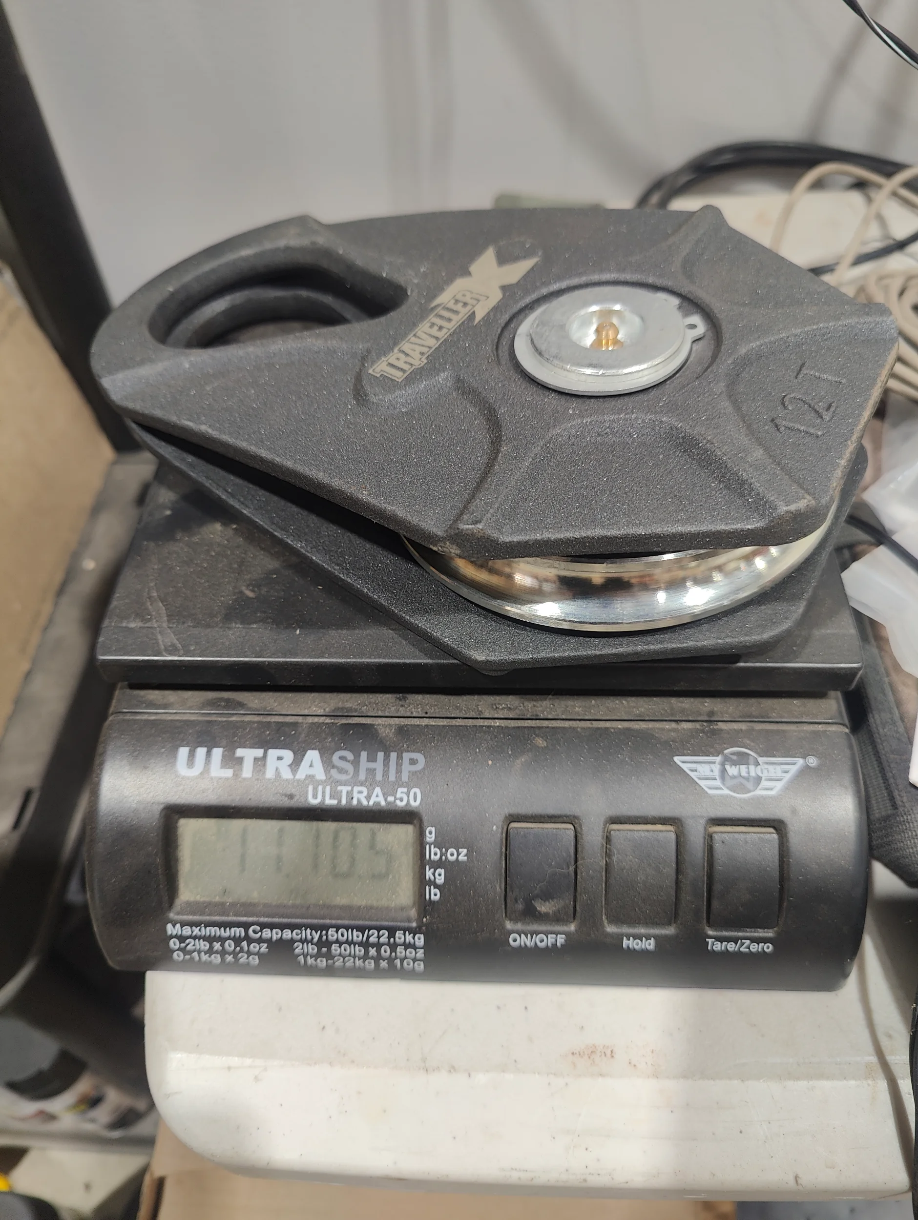

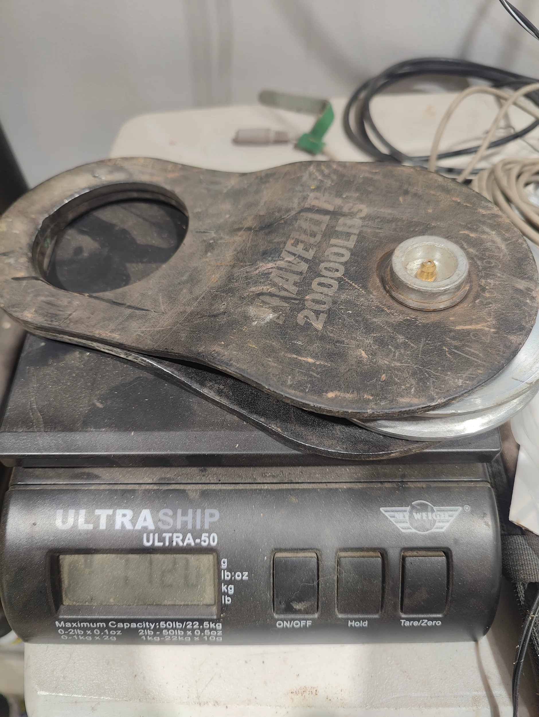

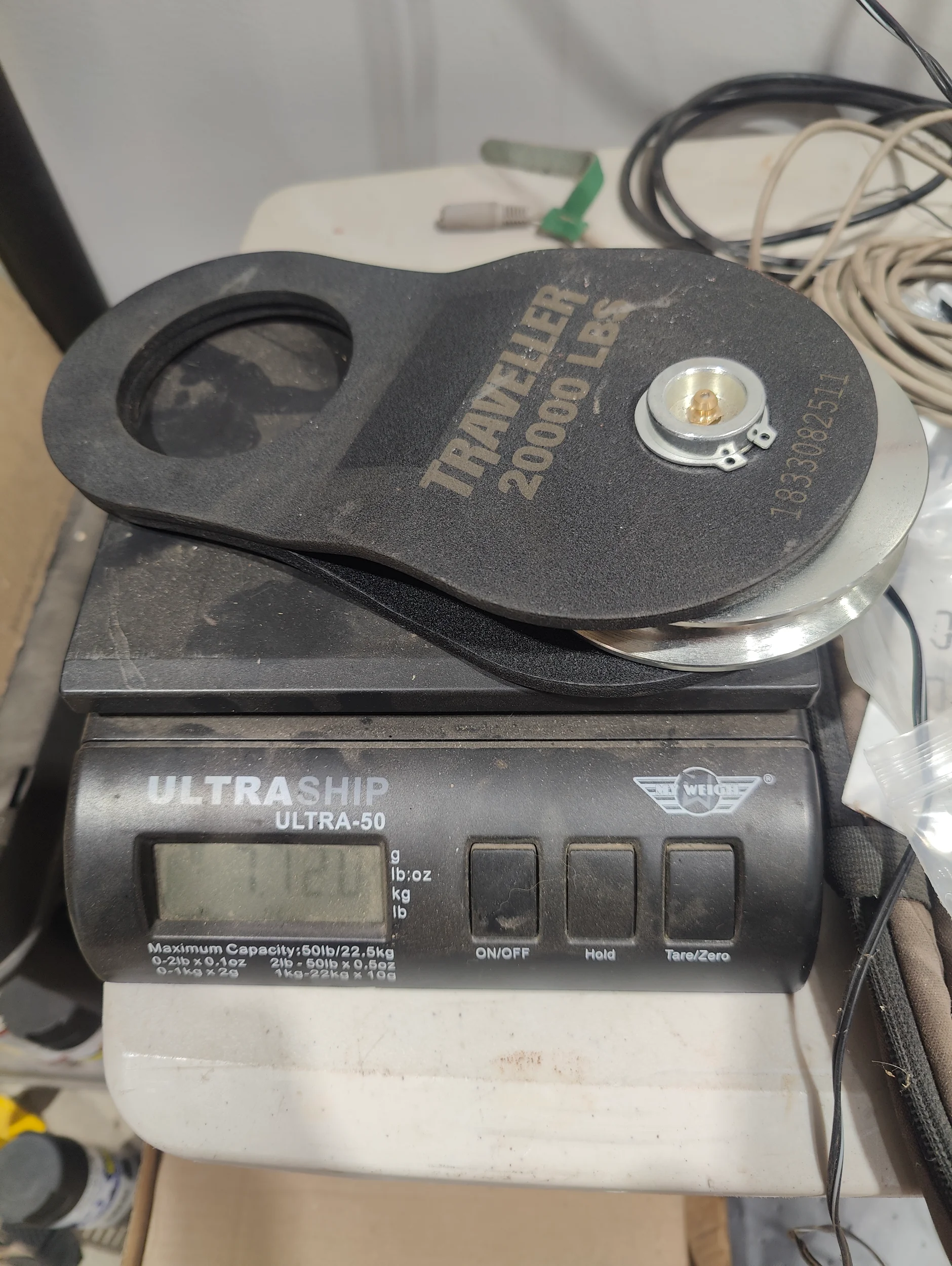

Also weighed the truck pulleys. The Traveller from Tractor Supply weighs a touch over 7 lbs. The new one is identical to my trusted ten year old one. The Orcish brand I ordered from that jungle website is $15 less, weighs 8 lbs and is rated for 1/2" vs 9/16. The Traveller cast pulley weighs 12 lbs. So four pulleys weighs 44 lbs and that's why these are truck pulleys.

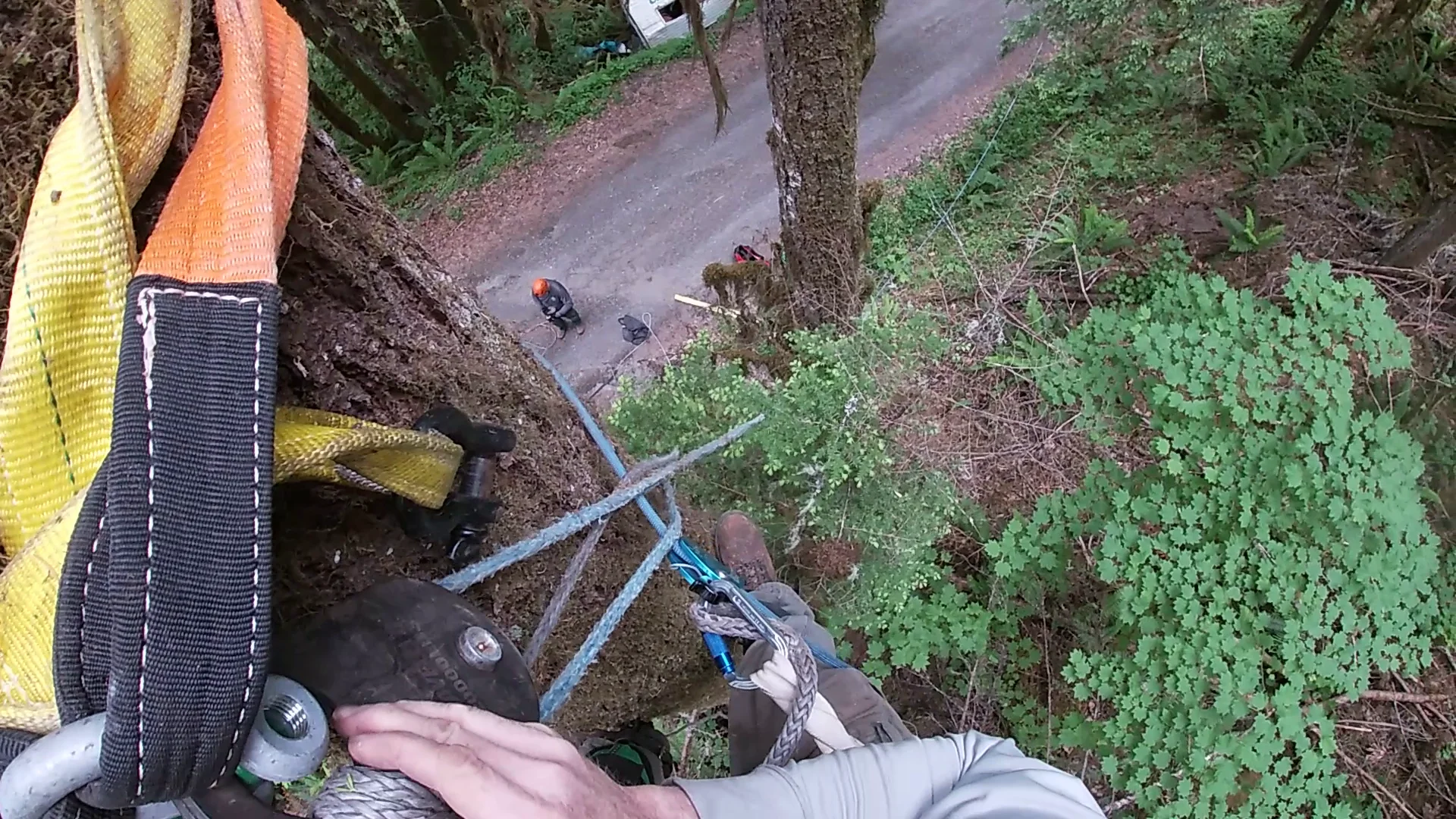

Big reason I use the big pulleys is it keeps the rope captive. If I have to climb 40' up a tree I can't have a rope slip off.

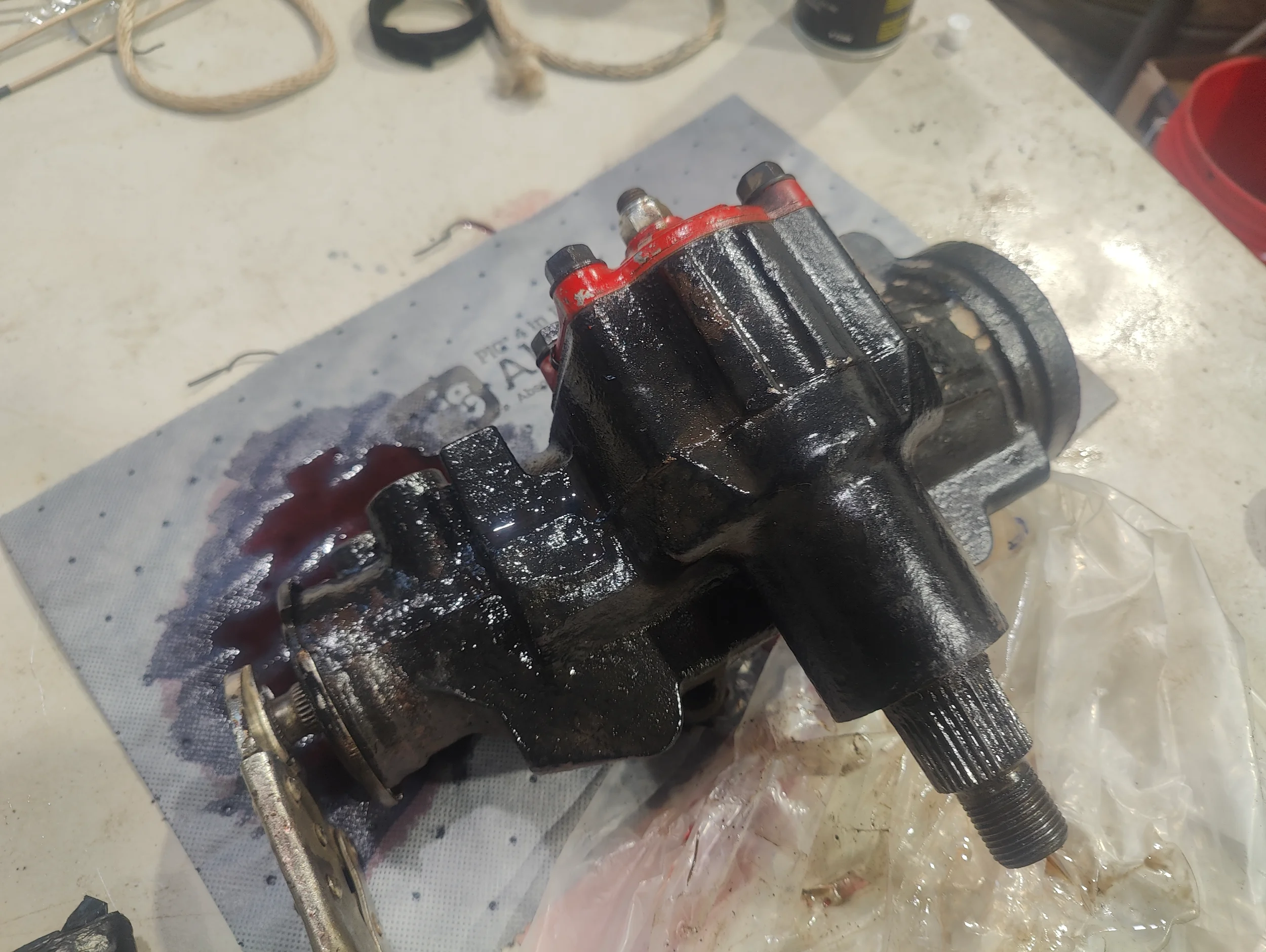

Swapped my steering box with the one I salvaged from the rusted Sahara. Seems like my dead spot is gone but I need to recenter the steering wheel...the or I got the pitman off a notch...that actually sounds more plausible.
My Redhead box lasted three years. I don't really blame them for the failure... they're rebuilding boxes and you really need a new case.
Hoping this used one can last me until I can afford a $2500 PSC kit.
-Mac
Pulled the pitman arm and tried straightening the wheel and reclocking it. No dice. Wheel was about 90 degrees off. Pulled the pitman off...box has three turns lock to lock. I recall the 97 boxes having something like 4-5...quirk of the 97s...so I put the wheel in the middle, moved it enough to install the pitman and adjusted the bar about 3/4" to center the wheel. Steers great. You can feel just a tiny 3-4 degree dead spot in the top but I think that's endemic of Saginaw boxes. That and it's probably the original 26 year old steering box from a rusted out Jeep.
