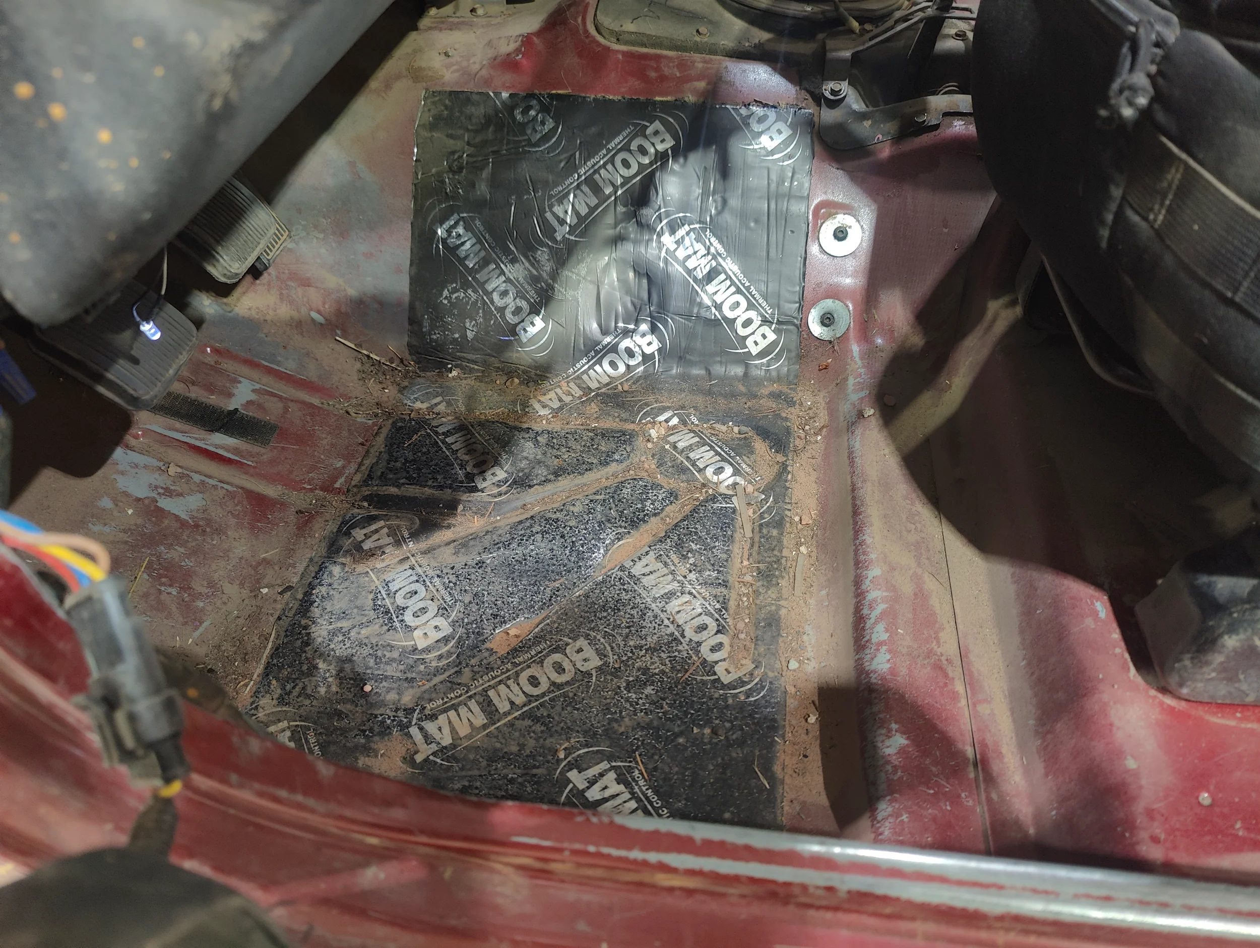

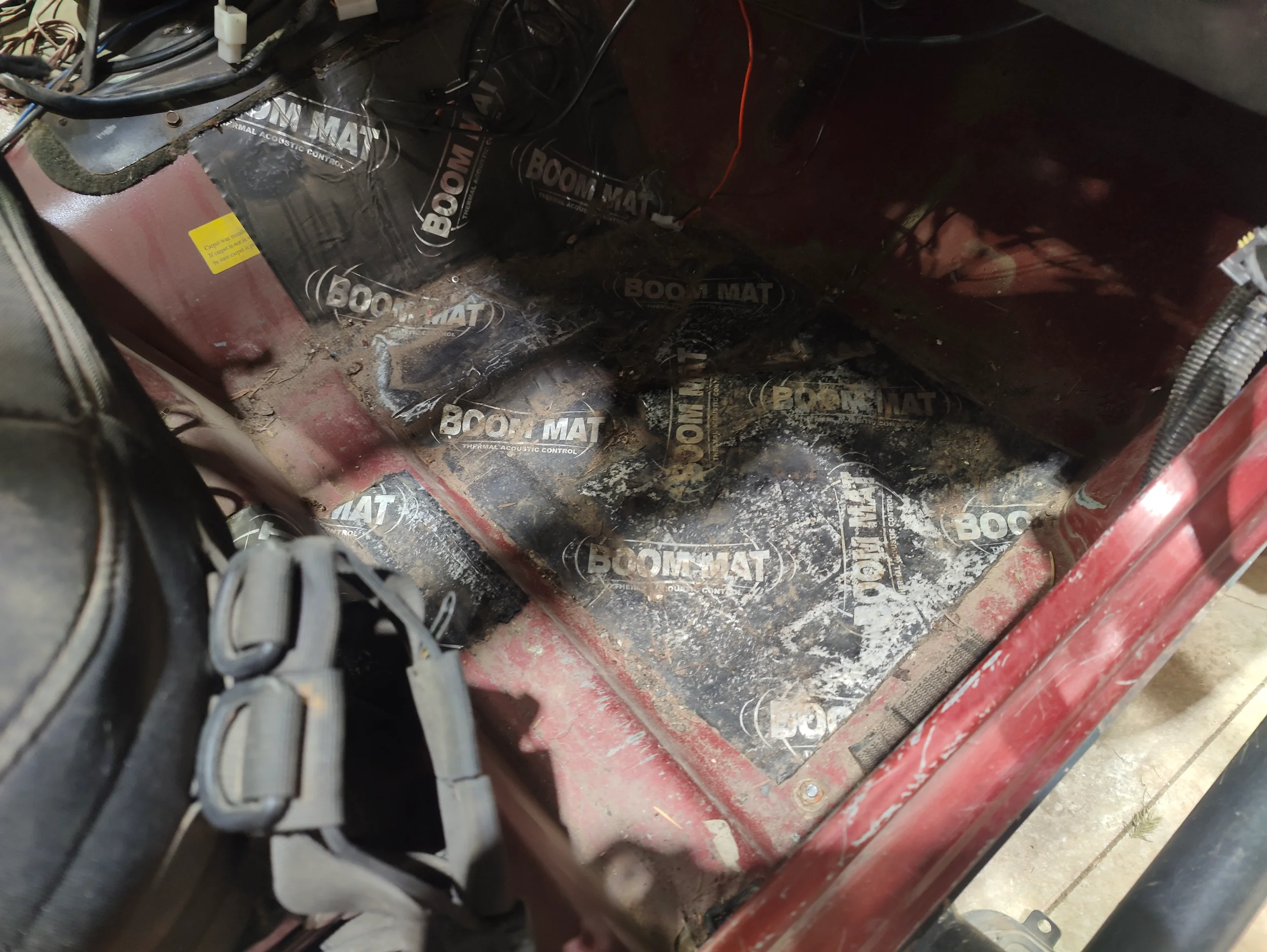

Finished laying down closed cell foam under the foot wells. Probably should have pulled the seats. Hopefully that'll help cut down on some of the heat.

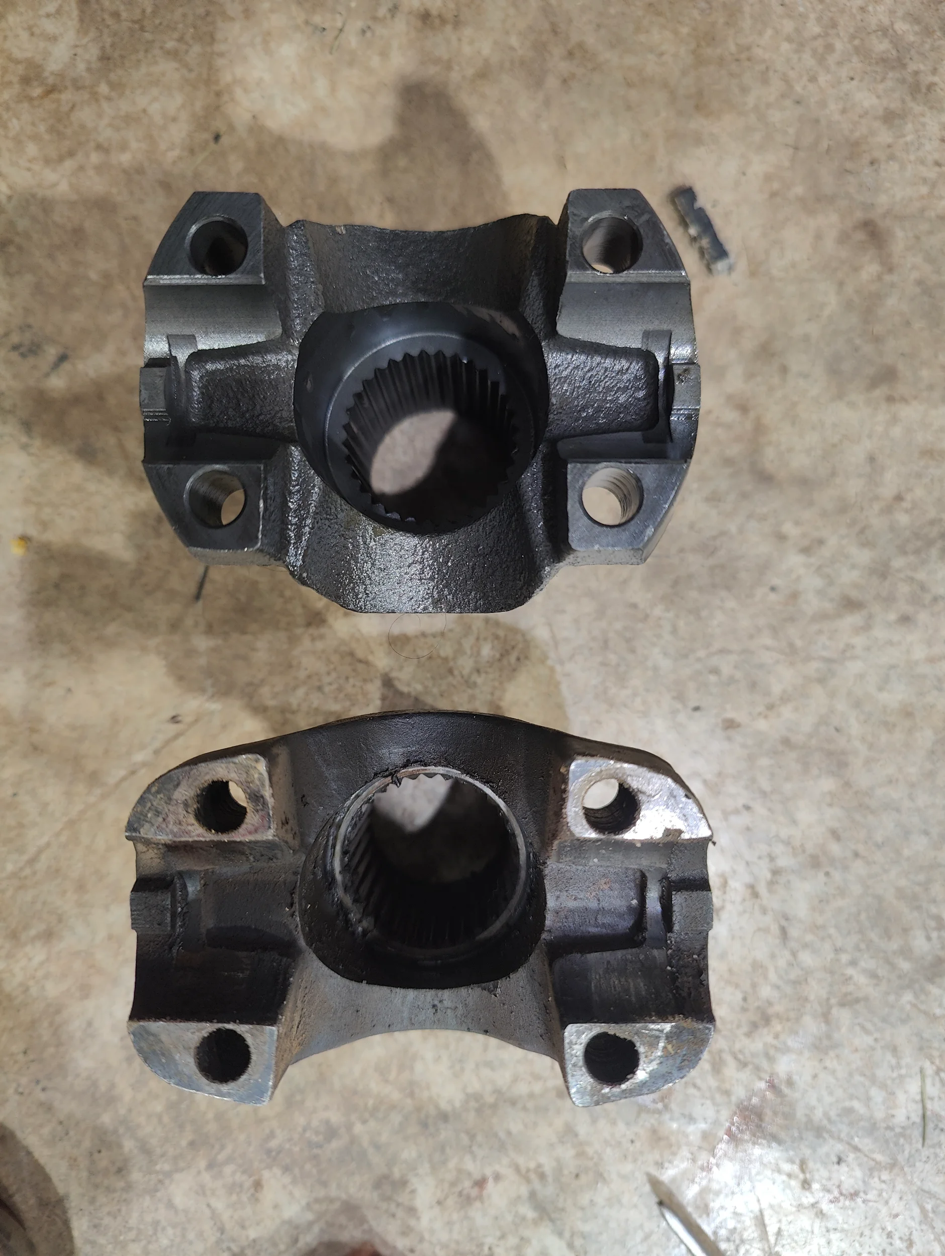

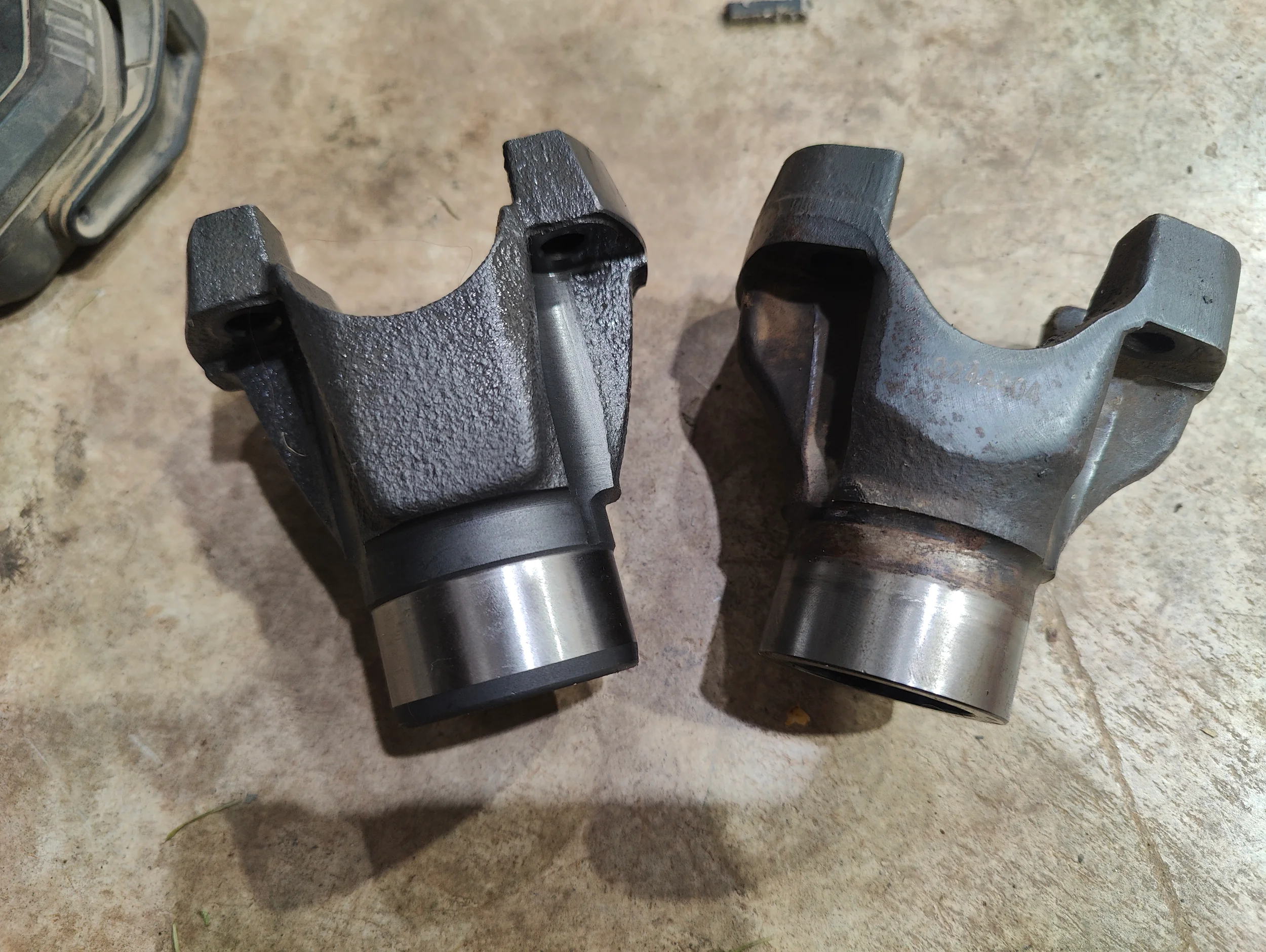

Ordered a yoke from Tom Woods $100 shipped. Don't think it's the bearing...note the nut not moving.

It looks like the yolk is moving relative to the shaft. So it could be the yolk, or the shaft, or both. And that movement could’ve messed up the bearing too. So yep, time for an Atlas.
Agree with @FarFire70. That looks like heavy pull.

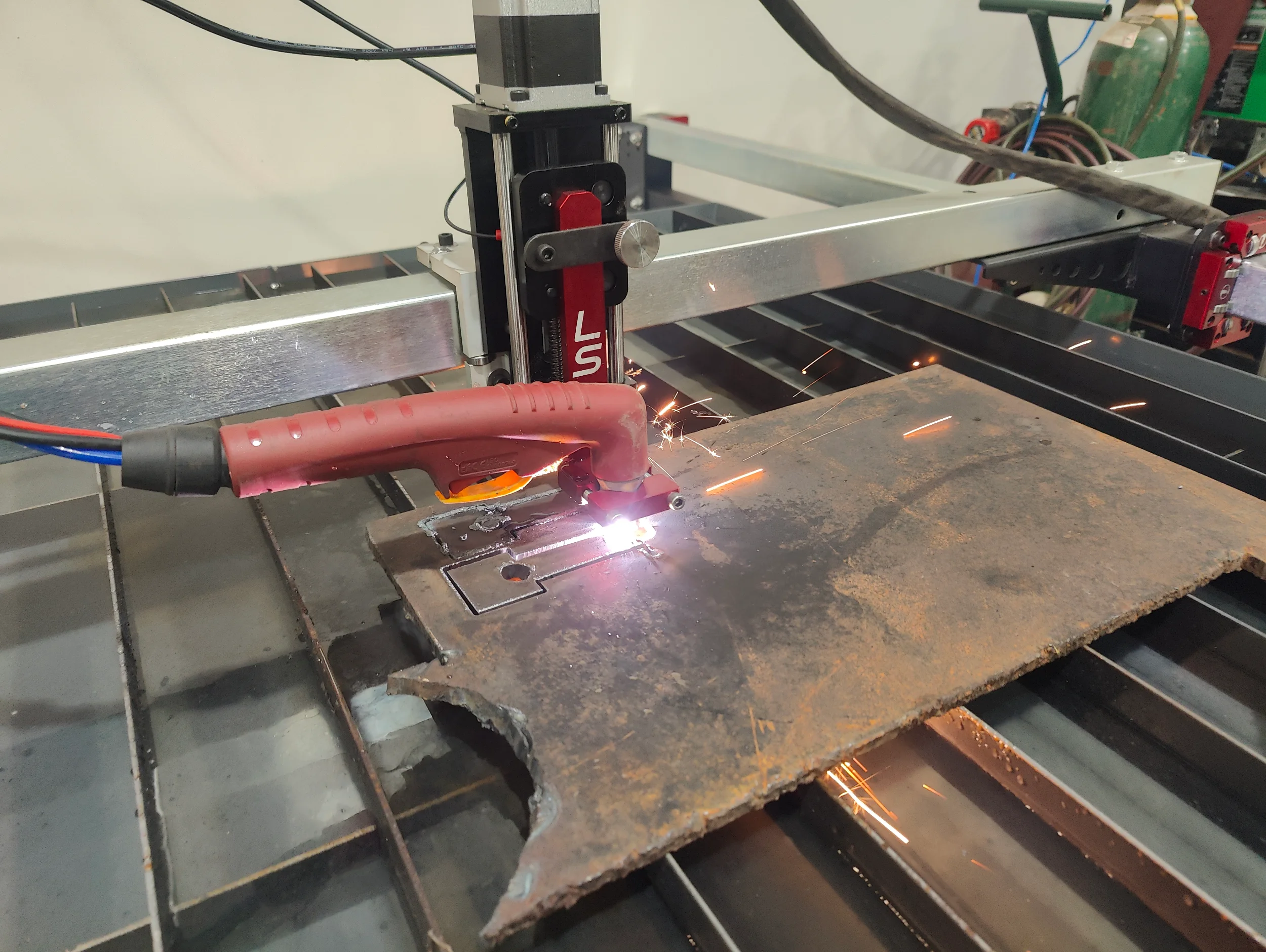

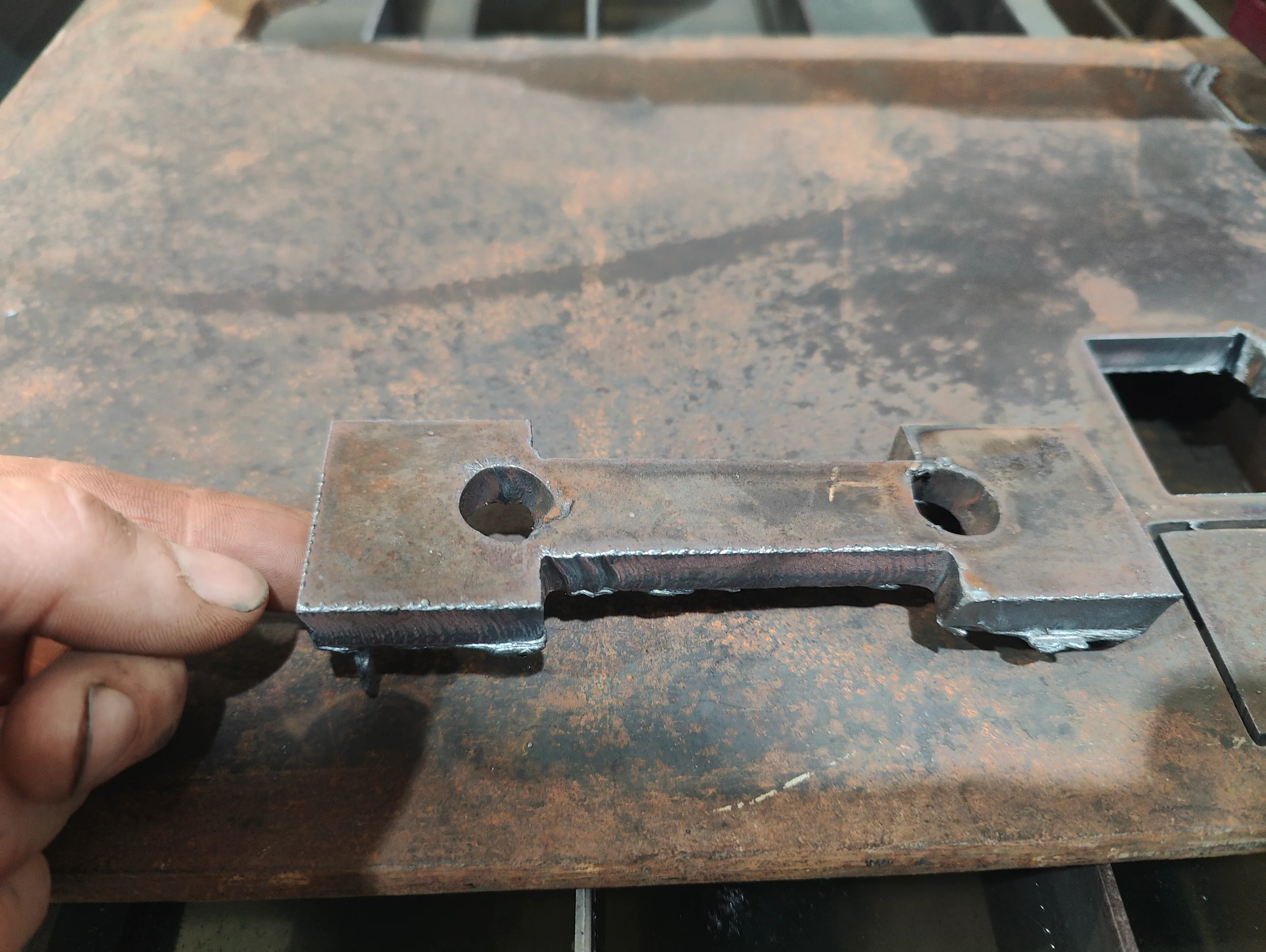

Very cool, Mac. What are you using for CAD?
Well I started using Fusion and then it threw errors exporting to gcode...so I switched to OnShape until I realized it doesn't have a native path to export to gcode...so then back to Fusion where I figured out in addition to adding the plasma cutter you have to import the table into the post processing section...which finally got me gcode.
Then I put three hours into figuring why the torch wasn't firing... continuity tests on the trigger cable.. manually connecting the wires and confirming I can get the torch to fire. Finally took apart the control box and found the firing relay had fallen off the board. Reseated it...bam.
I've spent hours and hours figuring this out.
I'm really good at manually making something once. Making multiples that are exactly the same is my issue.
This looks like it's going to be a great tool.

I use Fusion as well, and have gone through some of the same challenges learning to get things to the 3D printer (different ball game than dealing directly with G-Code, but the same type of learning). I came over to Fusion from Sketchup, so I did have a bunch of experience with 3D design, and that helped with my learning Fusion. But, above all - I find it fun. And learning is never a bad thing. I now look for excuses to design things in Fusion, where in the past (for metal work, anyway), I would have just jumped right into the fab work.

Ok...Tom Woods sourced replacement yoke arrived for my SYE. Little slather of grey RTV on the splines, couple of wuggas on the small 500 lb impact gun and perfect.
New yoke has more beef on the side.

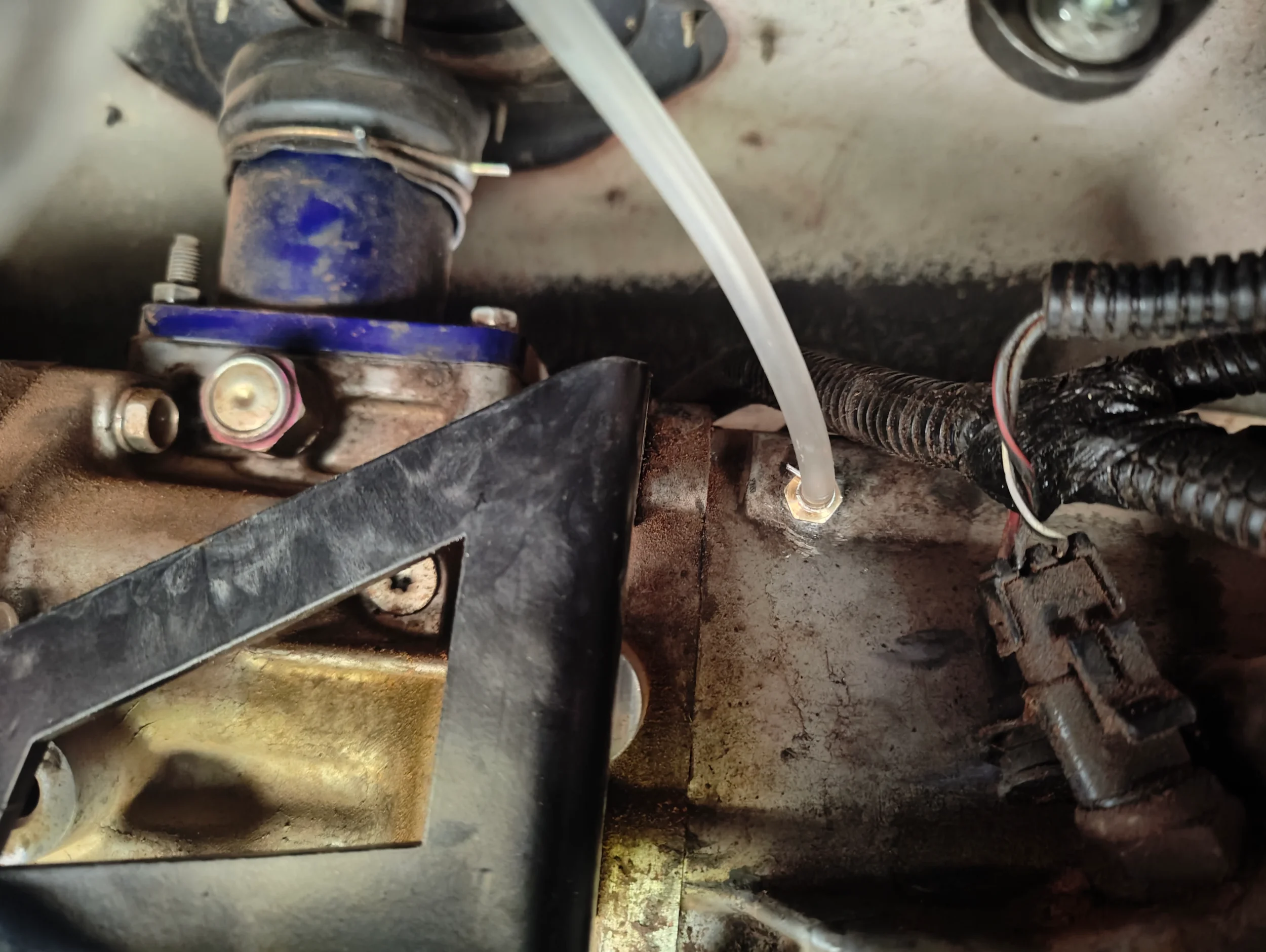

Replaced the vent tube on the top of my Frankenstein 231J. The press fit tube wouldn't stay in. Loctite, RTV... nothing worked and it would fall out and contribute to the minor fluid leaks out of this POS.
Basically tapped the hole with an 1/8" npt tap... technically the hole is a few thou too big but it tapped perfectly and a brass barbed nipple slid right in. I used small clear hose for 10" and ran it into my existing reasonably refreshed vent hose that runs up next to the brake booster. Curious to see how much fluid collects.
