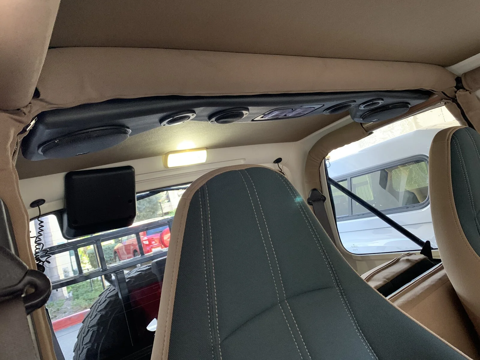

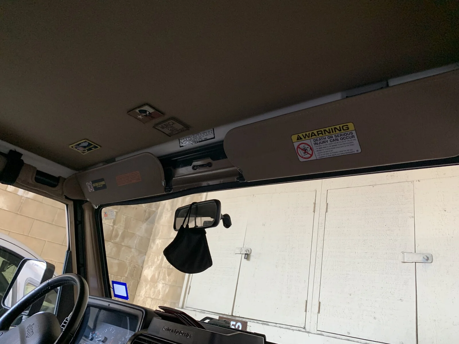

Sorry to revive this thread, but I couldn’t find a whole lot on the hothead for the camel interior before I purchased and installed mine. I purchased mainly for quieting down wind and road noise and I was satisfied by the difference it provided. Can easily hold a phone conversation with the phone on speaker while on the dash at highway speed. I bought the med oak hoping it was going to be close to matching the camel interior. It wasn’t exact, but it was very close And looks great. I installed with the had top on, wasn’t very difficult with one person. Most difficult part was the rear panel fitting around the sound bar without having the velcro adhesive stick before it was in position, but again wasn’t difficult by any means. I had to remove the rear hard top light housing to get it into place correctly, and the light housing doesn’t sit flush with the hard top upon reinstalling. It leaves a small gap at the top, but should be easily remedied by shaving a little plastic off the housing. For me, it’s not enough of an issue to mess with it right now. Hope this provides someone some insight when deciding whether or not to get one. Attached a couple photos to see the Med Dark Oak comparison when installed with a Camel interior.
Thanks for this. So it looks like the Medium Oak is a bit darker than Camel? I have T6 "Saddle Tan" interior, which I think is a little darker than camel. So I'm wondering if this might be a good match for me.
