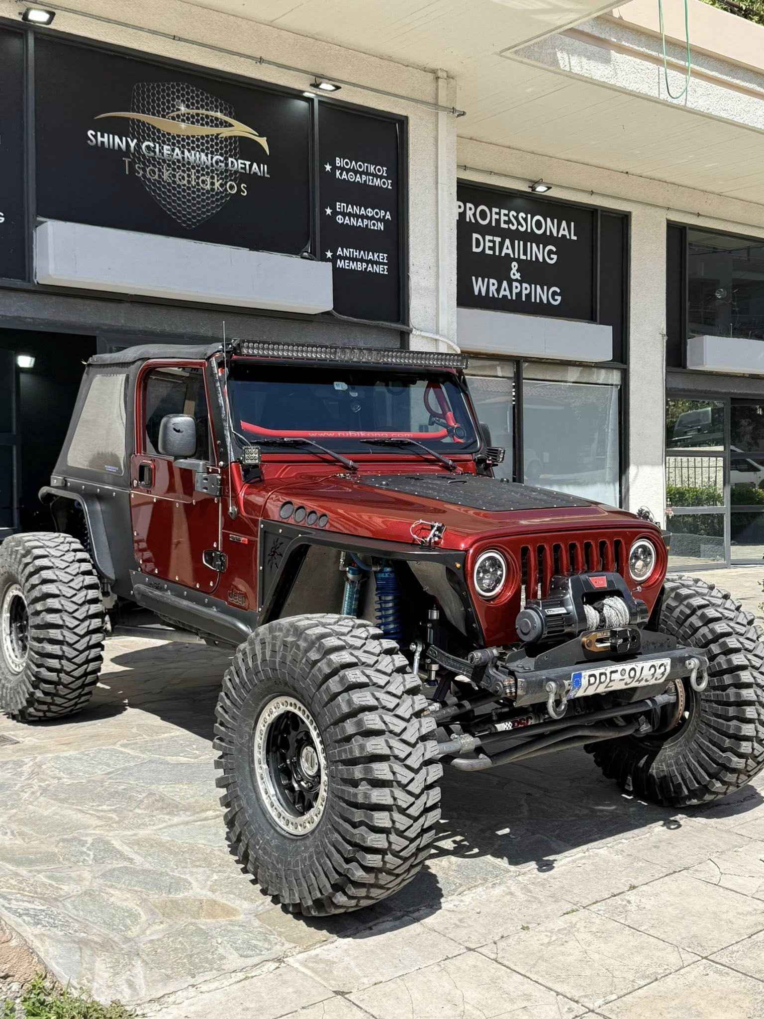

Here's a guys TJ with a 6.1 Hemi & 8HP70 swapped in. He's overseas so I'm not sure which rig his shifter came out of.
Edit: He's in Greece so IMO it's a cool build on that merit alone.

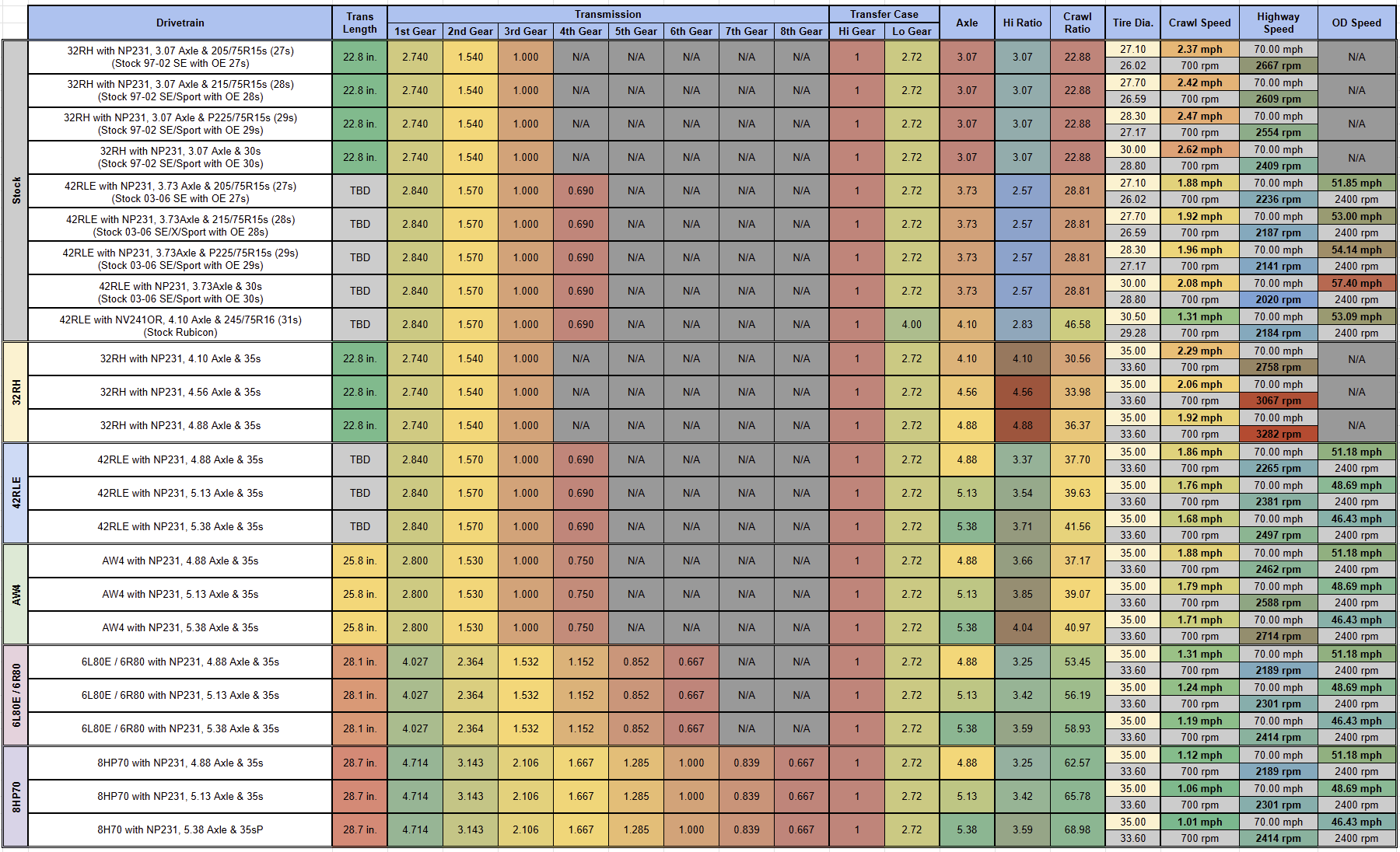

Yeah well the AW4 is ~3" longer than a 32RH so the SSYE more than makes up for that (~6" shorter than vs stock slip yoke). If you add another ~2.25" plus a 0.7" bell housing adapter to that SSYE probably about 1" shorter than the OE 32RH location, not ideal but probably manageable if the lift isn't too big. Still have yet to find anyone who can tell me how long a 42RLE is. Worst comes to worst I can message one of the sellers on FB and ask them to measure.
8HP70 (0.7" Bell Housing Adapter via @Wildman) - ~28.7"
6R80 / 80LE (0.7" Bell Housing Adapter & T-Case 3.625" T-Case Adapter via @Jezza ) - ~
AW4 - ~25.75"
42RLE - ???"
32RH - ~22.75"
Add trans lengths, combine 6L80 with 6R80, and added some more conditional formatting to the chart:

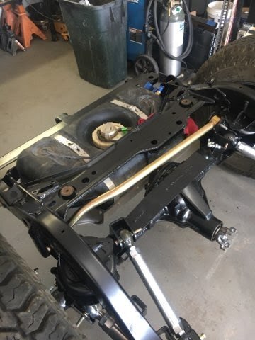

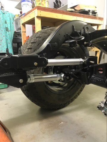

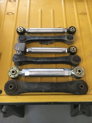

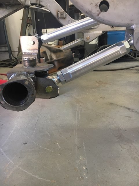

For reference when I was talking with the builder of that AW4 swapped Sahara TJ that won Rebelle Rally he was right at the limit of what is possible in a stock TJ wheelbase.
With a 44 rear at full droop with the 8+" travel shocks it's 2-3 degrees away from bind on the rear CV. That is with an SSYE on short arms (stock length) with a full flat belly. Drive shaft was ~17" yoke to yoke at ride height. The SSYE offset the extra 3" of length of the AW4 bringing it closer to a standard SYE on a 32RH but the flat belly raised the T-case 2.5" so with the 3" lift about equivalent to a 5.5" lift on a 32RH with standard SYE which is about the limit on a TJ.

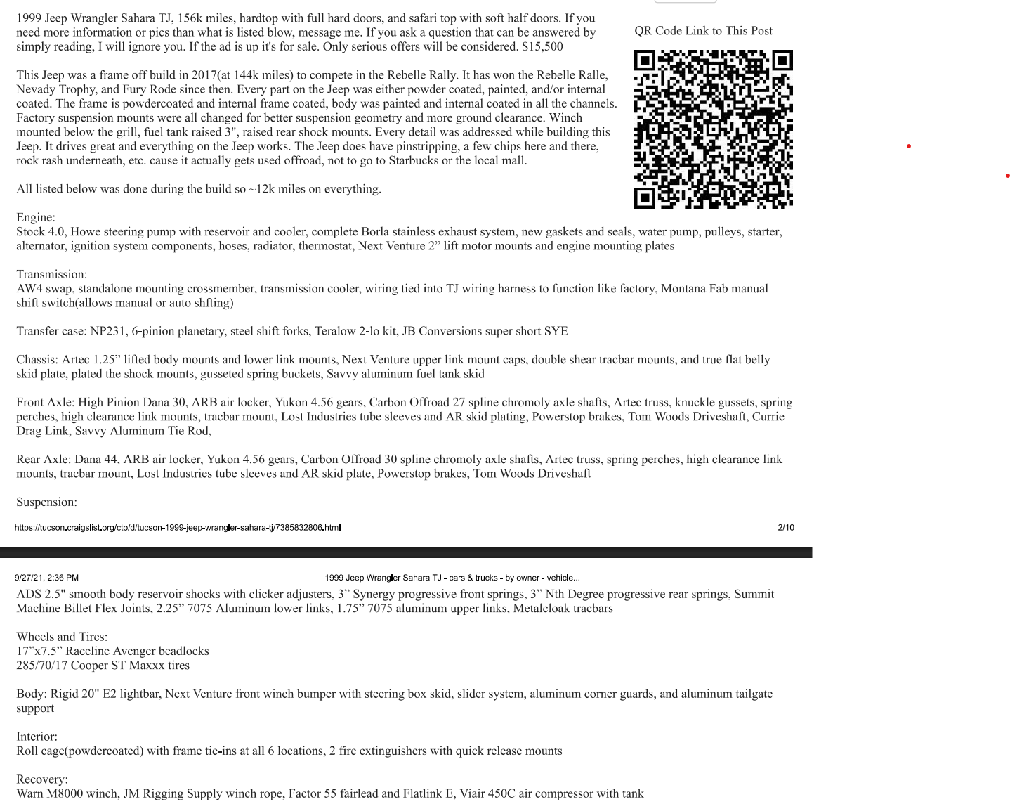

Build details from original craigslist posting for reference:

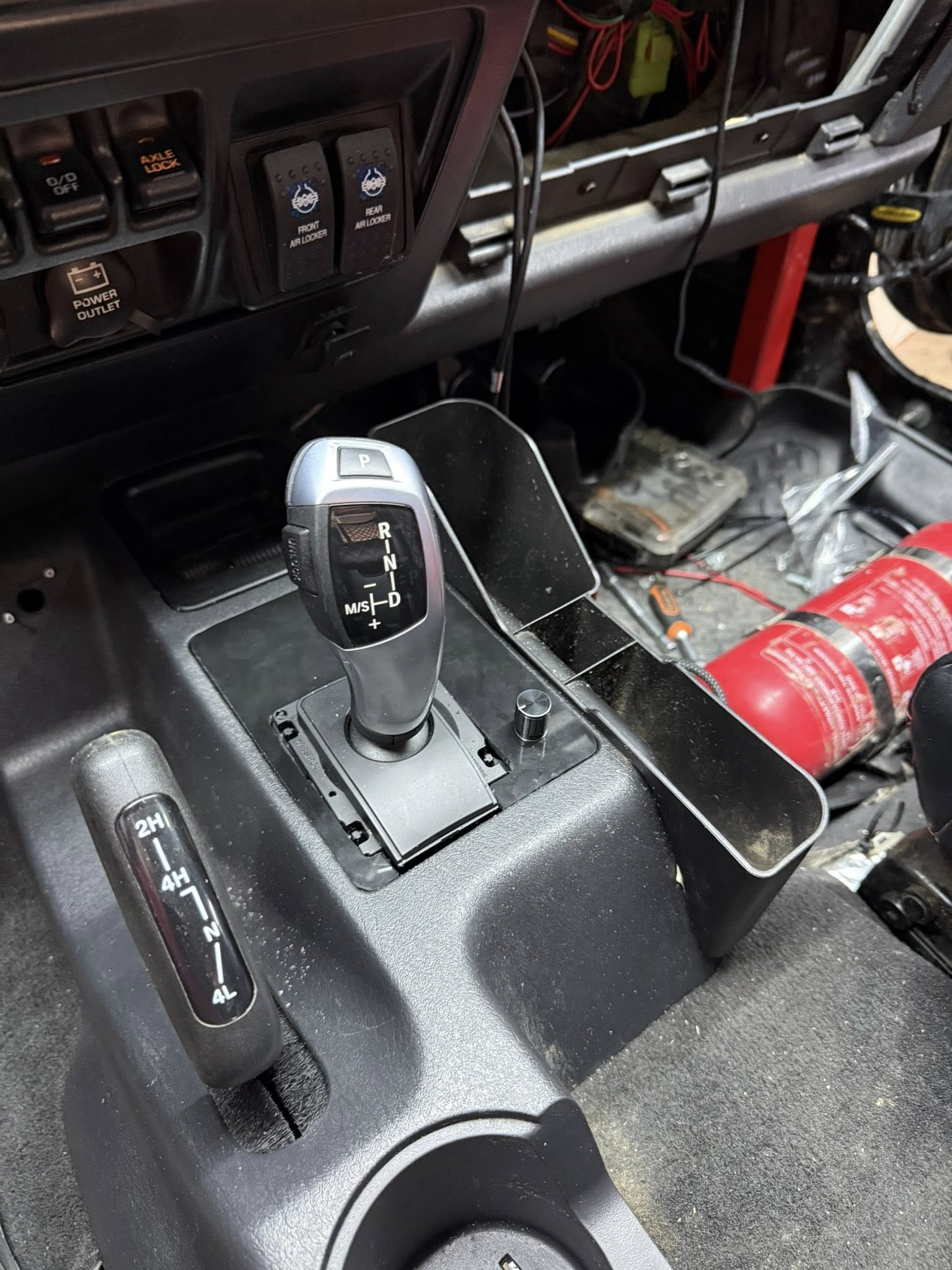

That looks like a BMW shifter out of a 2012+ 3-series or other BMW car/SUV with the ZF 8 speed. Makes sense if he is overseas the parts for those cars are easier to come by.
I wasn't sure which model it was but figured it for a BMW. I like the looks of it over the Challenger shifter too to be honest.

Yeah it came in quite a few BMWs across a certain model year range. It does look better, but I hated it on my friend's 335i. It is nicknamed the "video game controller" in the BMW world because it feels cheap and plastic. I much prefer the shifter in my 2019 Grand Cherokee, not sure if there is a way to swap that on instead.

Well I got a little more info from the owner of that rig & shifter. He's able to use it because he's using the Turbolamik controller instead of the standalone harness from SoundGerman. It does give some options/features that the SoundGerman kit doesn't.
