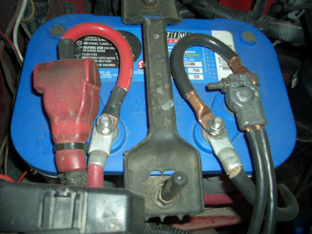

Optima warned against connecting a winch to their side posts even in 2000 when I installed my first of 3 Optima batteries... all of which died prematurely. Their warning way back then was why I added a pair of 2 gauge jumper connectors between the side and top posts to carry the load.
This was my last Optima battery, my first two were Yellow Tops and the jumpers were connected to their side posts.

The pictures you show are a stud on top, not the soft threads on the side.
You need to pay a little more attention. As was explained in that post only one of my six AGM batteries had the posts on top, the Blue Top which I posted to show the jumpers I used on all three Optimas. The other five AGM batteries all had side posts.
