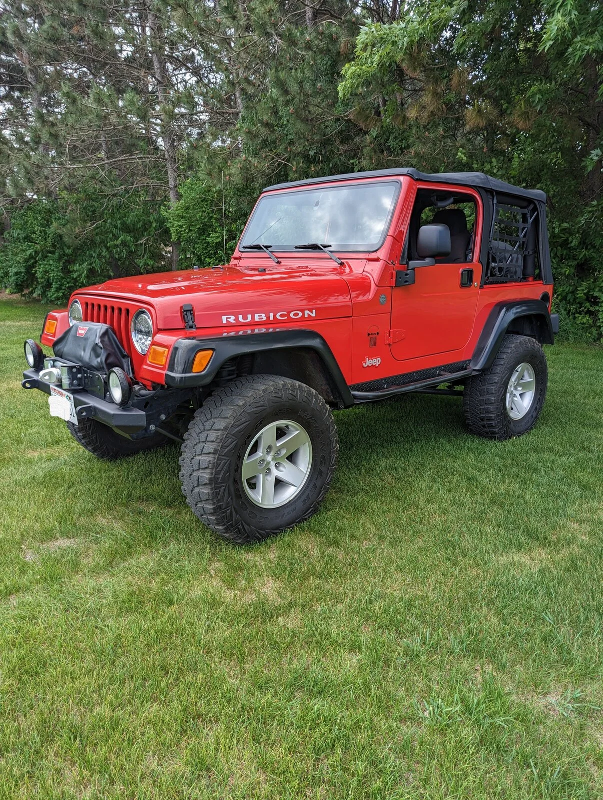

I have a "new to me" 2003 Rubicon that is in exceptional condition with 77K miles on it. I've tested pretty much every function and feature that it has and found almost everything to be perfect, The one thing that is not working is the O/D on and off switch. It does not affect the overdrive operation and the light does not illuminate when the switch is activated.
