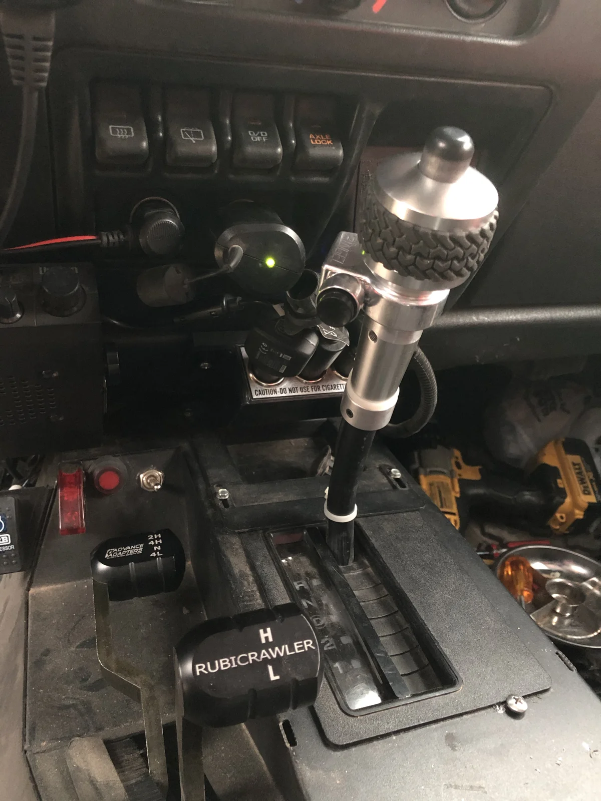

I have a hand throttle below the switch visible in the pictures, it doesn’t get in the way

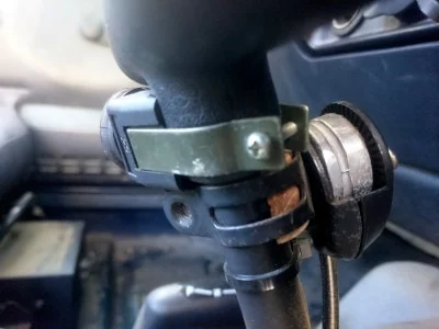

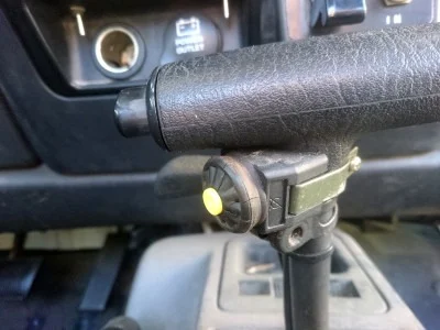

I mounted the switch on the t-handle collar so it can be pressed by your thumb without moving your hand from the shift lever. It took a bit of bending of the mount brackets to make it work. Depending on the exact switch you buy you might have to work at this a bit to make it fit. I spent a bit of time getting the screw the correct length and everything to sit flush. I also rounded the back of the switch slightly so it matched the curve on the handle collar a bit better.
The button sits at the bottom of the t-handle, the hand throttle is just below

One of the wires from the button is attached to the factory O/D button signal wire. On a 2004 it is the orange wire with the white stripe or the second wire in from the drivers side on the switch. I used a Scotchlok wire tap so damage to the factory harness would be minimal.
The other wire is just connected to any ground point. I chose a mounting bolt near the shifter. Be careful when running wires through the plastic plates at the base of the shifter. They slide underneath each other and if you drill through them they can lock together. You have to slot the lower holes if it binds. Just test gently after you route the wires to make sure it operates smoothly. Be sure you have enough slack to get all the way back to the first gear position.

You can feel the mounting bracket on the opposite side depending on how you grab the shift lever. I got used to it in no time but some people might not like it.
After several years I noticed the cheap chinese switch has started to deteriorate. I didn’t even notice until I took pictures for this.
