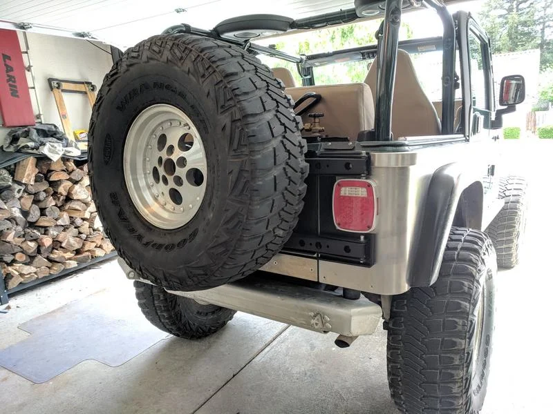

Some posts I've found with cuts in the rails to accommodate a spare tire carrier (might be an older version for Jerry Bransford's jeep but I'm not 100% sure. My rails look like the ones in the 1st link below) (links are not allowed to jeepforum & wranglerforum so you'll have to manipulate the below URLs to include www, remove the space in the sub domain, and add the .com back in... just fyi):
Pretty much every other picture that I can find w/ the rub rails is of a Jeep without a tire carrier

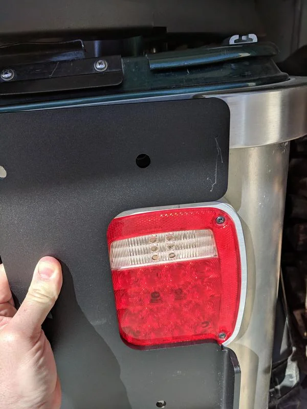

Personally I would use the ExoGate and just make the required cuts. It's no big deal if you ask me.
I had to cut and modify my ExoGate slightly to work with my Savvy LED taillights.

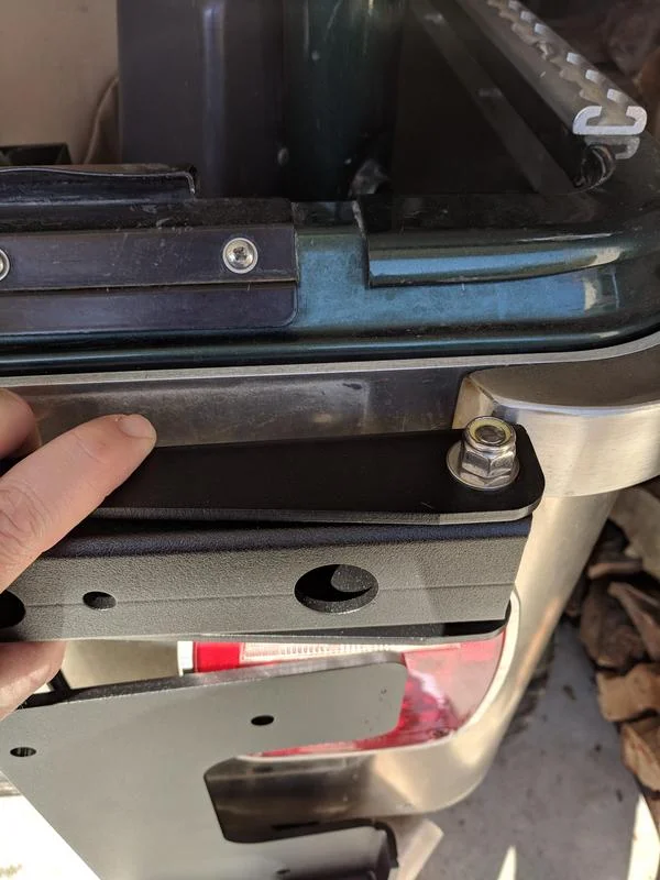

@Chris To clarify, the cuts that I'm concerned about are the ones that would have to be made to the tub rails (not worried about chopping up the exogate plate). If that's what you're referring to... I could probably make the exogate hinges work by moving them away from the rails (towards the tailgate) but this would require drilling new holes in the hinges and removing about an inch or two from the left portion of the hinge which might compromise their strength... idk

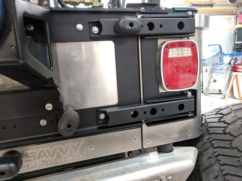

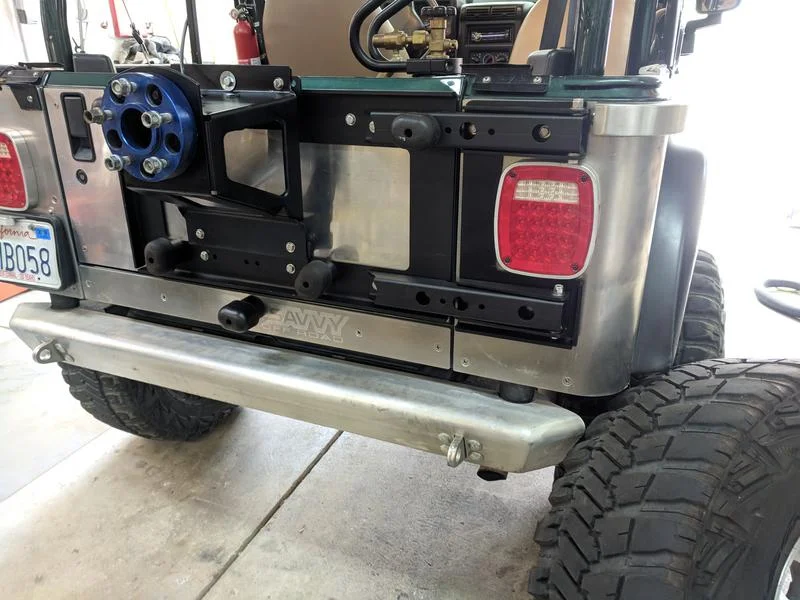

Here are the pictures in the links that I tried to post above (found that links to the other forums do not work :cautious:)
and
@ImpactOrange Great find! That does indeed look like it will work. I read through the install instructions and it seems to use all factory holes (enlarged) and the hinges are short enough that they look like they won't interfere with the edge of the tub rail. My only concern is that Rusty's company seems to have a bad reputation... https://wranglertjforum.com/threads/rustys-offroad.3727/
