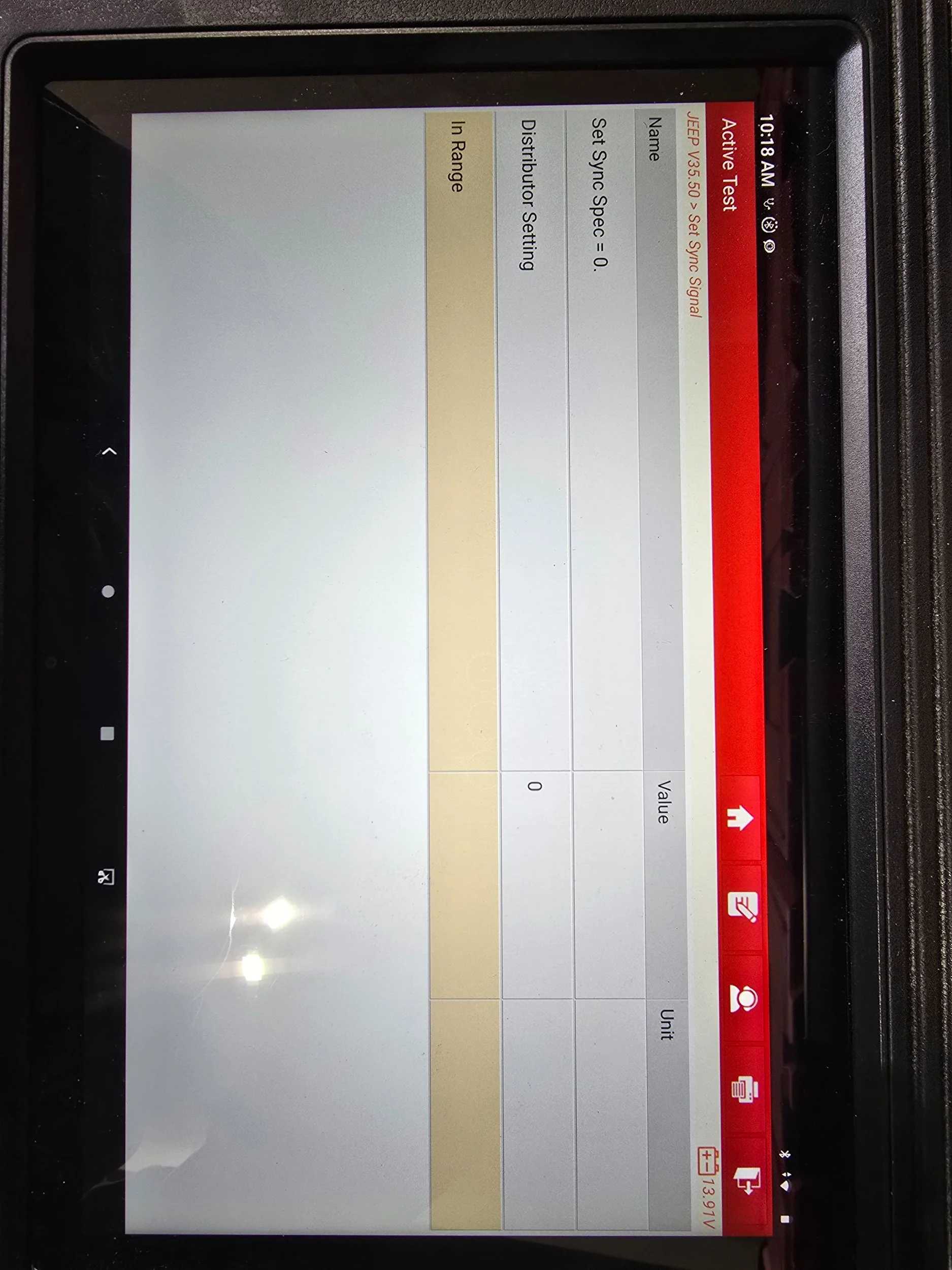

Have you checked the cam sync signal? I've had issues with that before on my '04.
