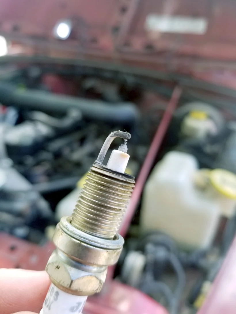

Noticed that I had a little rough idle at stoplights last night, then this morning the Check Engine light came on just as I pulled into the work parking lot.
I had the OBD reader with me, so hooked it up and it showed a P0305 misfire (cylinder 5). The code wouldn't clear.

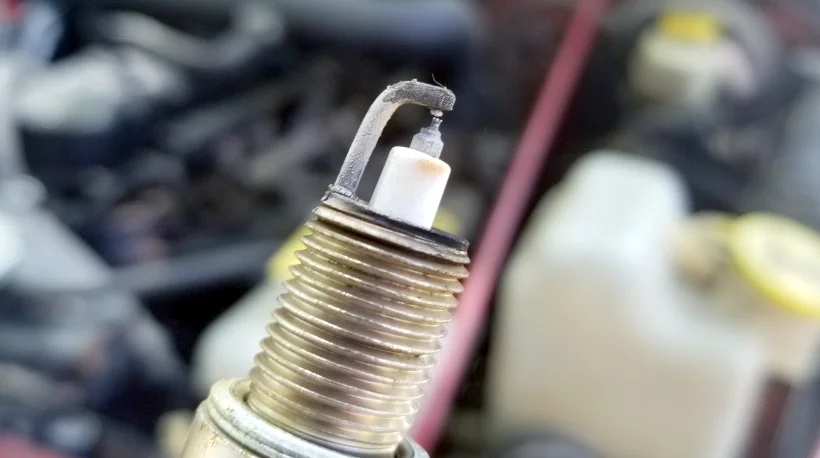

Took the afternoon off to figure it out. First thing I did was pull the number 5 plug and found this:
I've never seen a plug gap close up like that before. These went in about a year ago, they're Autolite APP-985 plugs. I'm wondering if I gapped them wrong and the gap was too tight.
I wire brushed it, filed the nipple off the ground node, re-gapped and put it back in. Then I pulled the rest and cleaned them up too. None of the others were close to this, but were starting to build a nipple on the ground. Filed it off before re-gapping.
Cleared the code and it hasn't come back, so easy fix this time.
