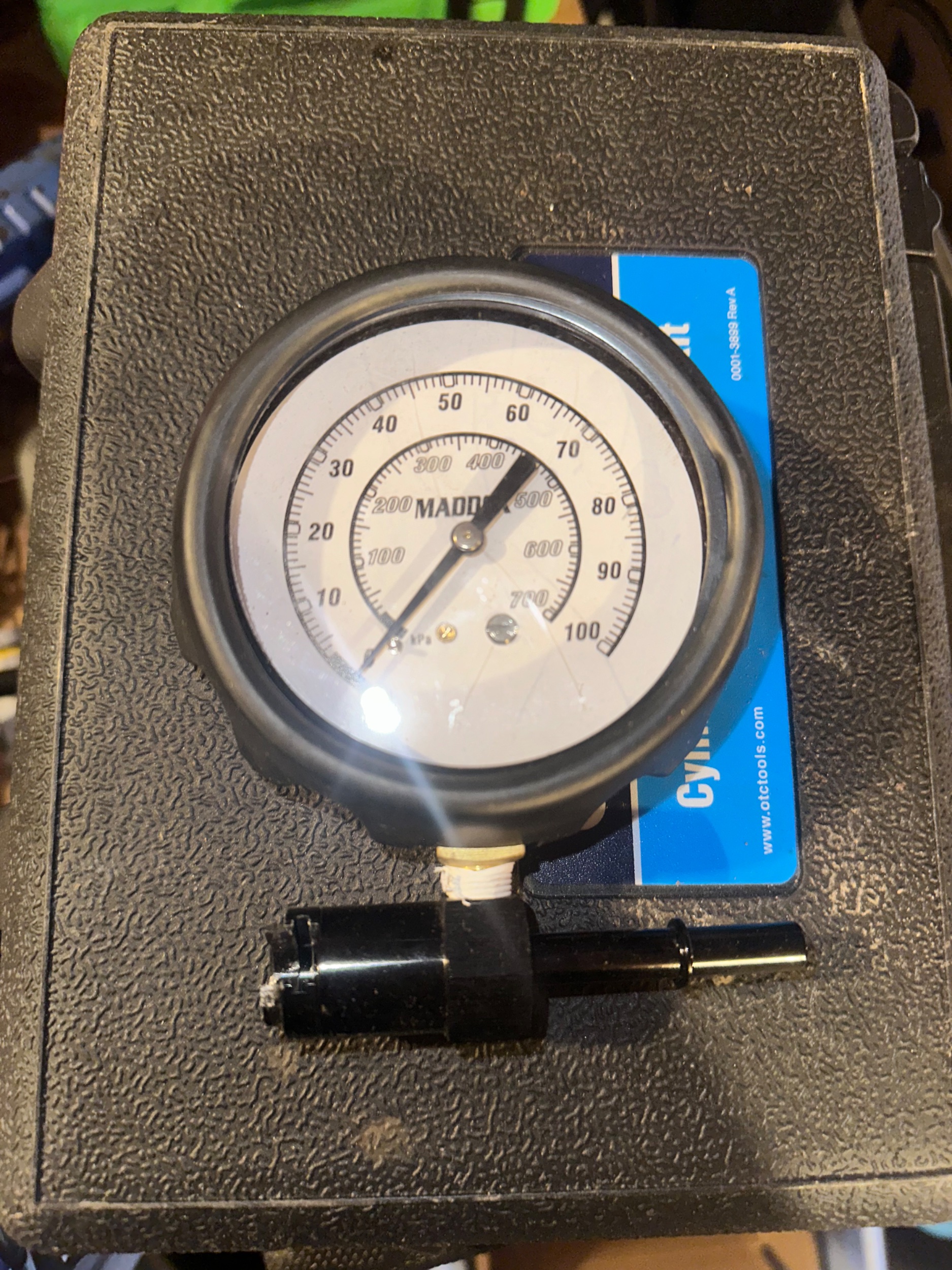

This is the inline adapter I made. Can’t remember who recommended the adapter, but it’s pretty cheap.
In-line Fuel Adapter
