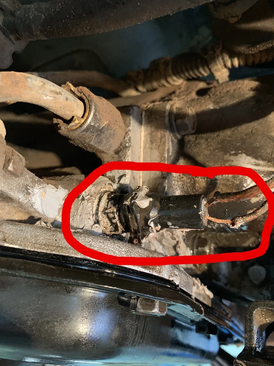

Check its electrical connector at the rear of the transmission.
This is not a great photo of the connector but...
Also disconnect and reseat the three big electrical connectors for the PCM.
