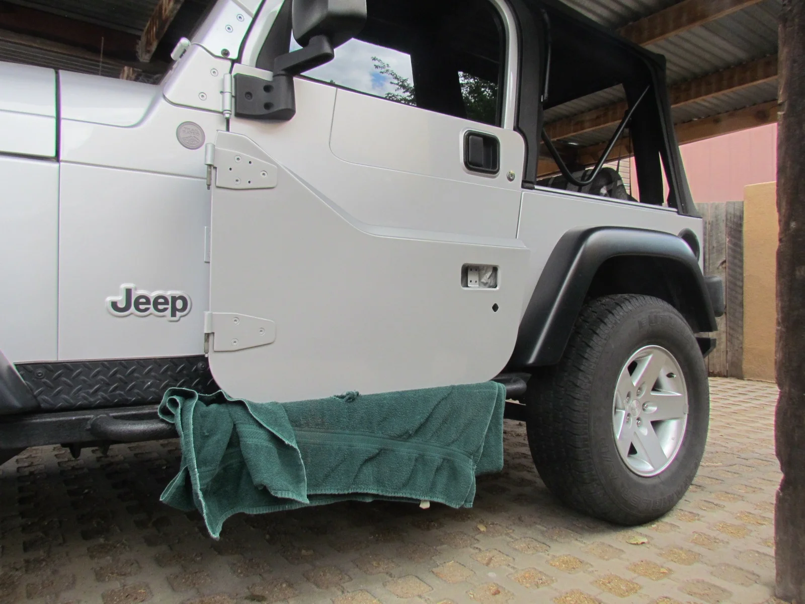

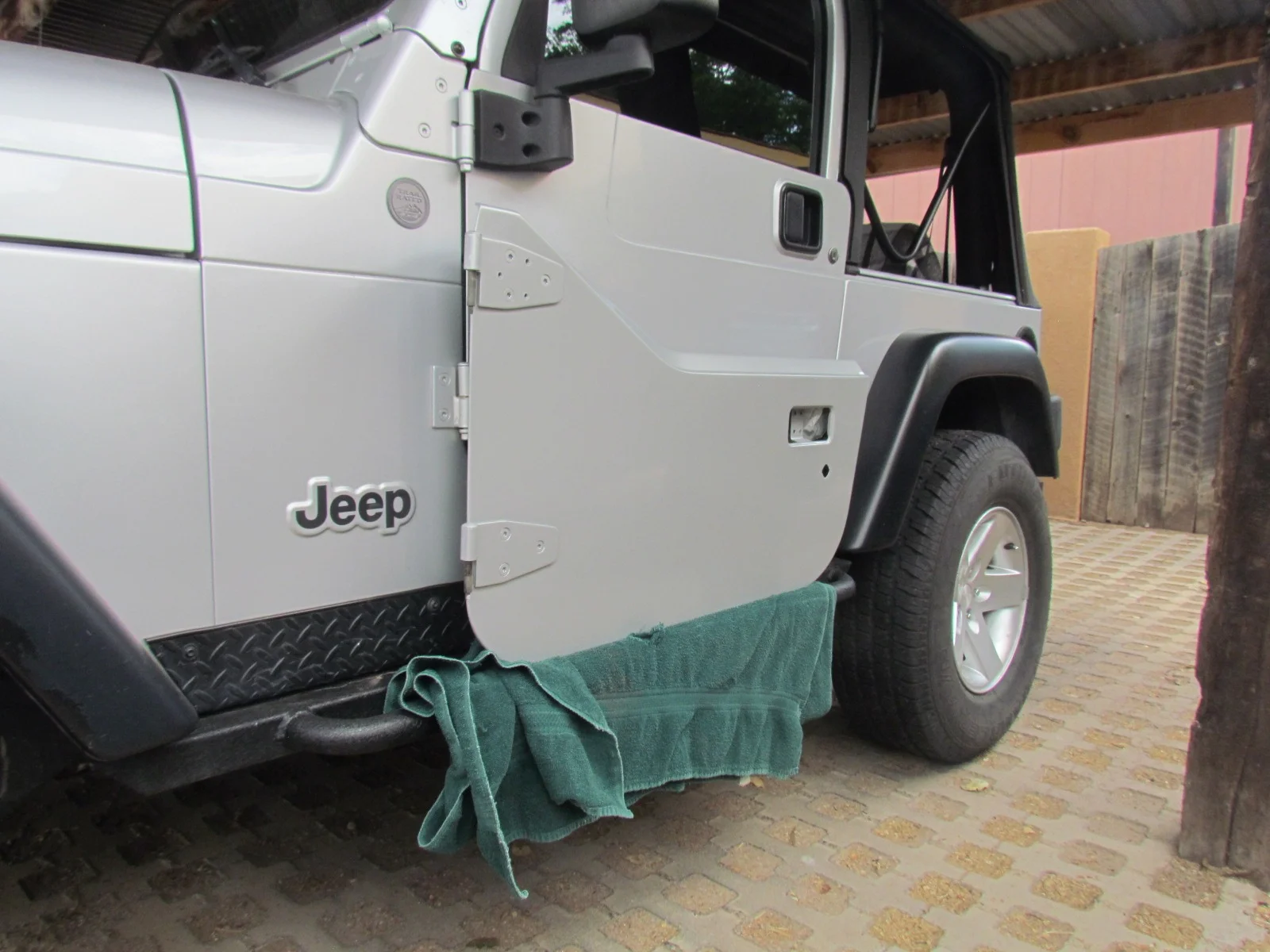

The time has come to paint the half doors I picked up last winter. They are dark blue, and I want to match the bright silver paint of my Rubicon. What's the proper way to prep the blue factory paint prior to applying primer?

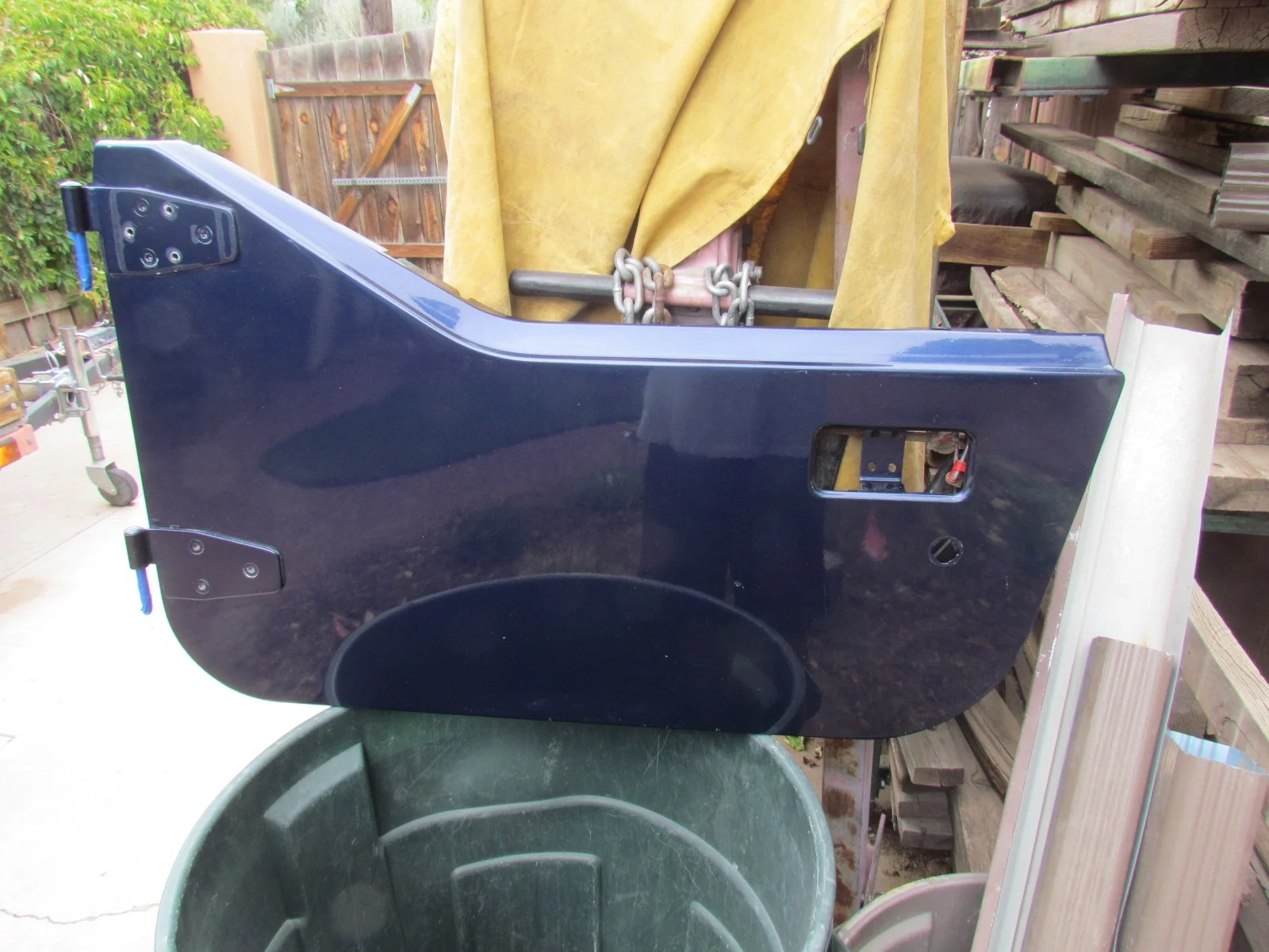

What kind of shape is the factory blue in?
It's actually in very good shape. They were the original doors on the TJ, were replaced by full doors, then pretty much stayed in storage for the last few years. I'll see if I can dig up some photos, or take some more.
How they sit as is:
The factory substrate is a good foundation to start. Pull the handle, lock cylinder, and door panel. I'd pull the hinge plates too, but not absolutely necessary. Clean the surface with a good mutipurpose cleaner and a gray scotchbrite pad. Dry and wipe down again with wax/grease remover. Wet sand with 400-600 grit wet/dry sandpaper. Try not to sand thru the basecoat if you can help it. When everything looks dull and uniform, clean again with wax/grease remover(always use clean, lint free, disposable towels for cleaning), and apply your primer. Let the primer dry for a bit and check your work. The primer will tell you what you've missed, and what is acceptable. Sand with 600 grit and apply more primer if needed. Your top coat will only look as good as what is under it, so it is important to have the final primer coat looking good.

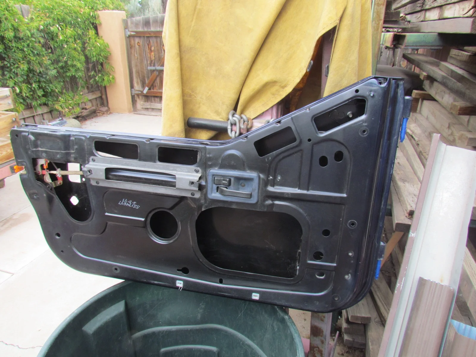

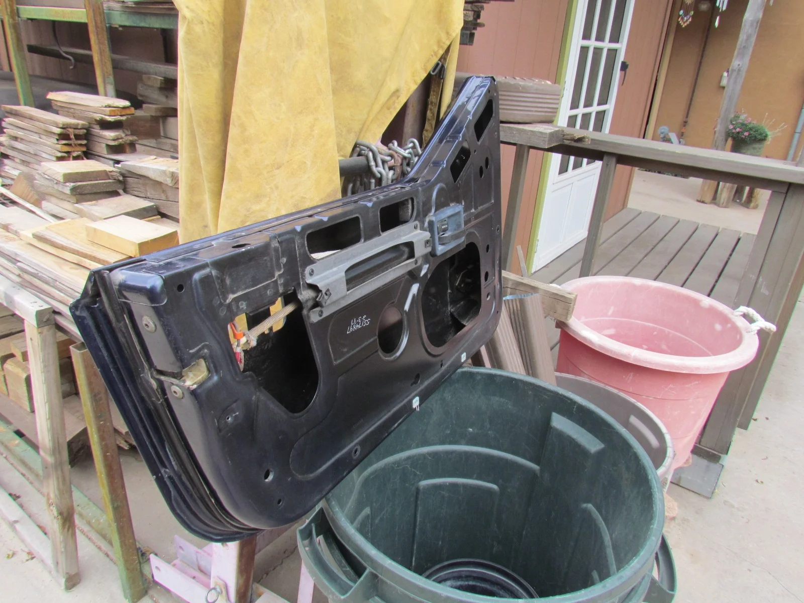

Decided to have them painted at a shop after getting a price of $250 + cost of paint. Disassembled the doors:

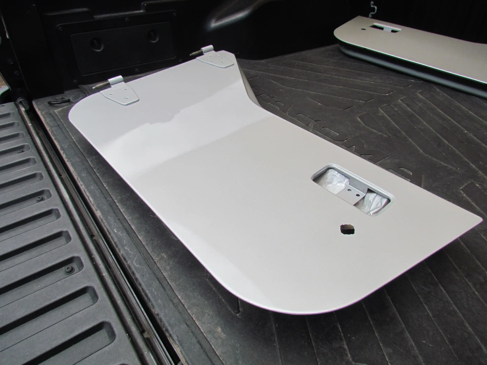

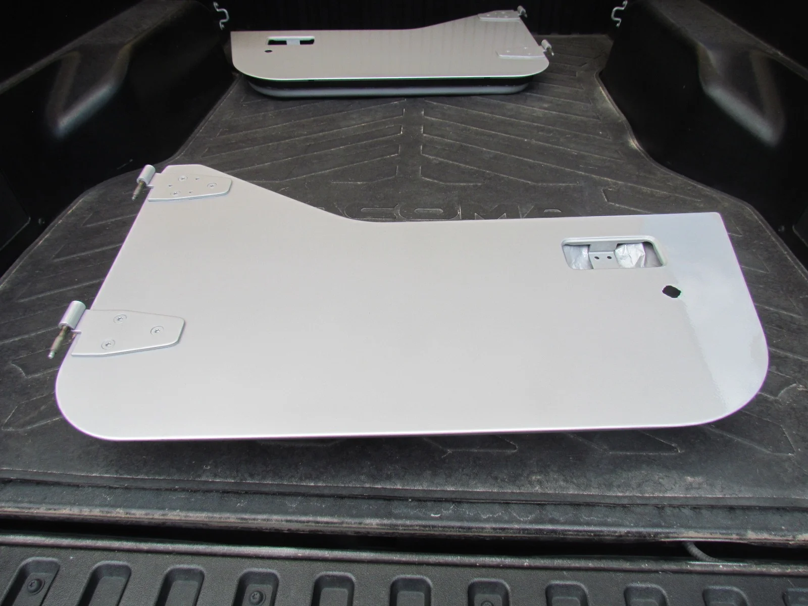

Picked up the doors from the paint shop today. Still need to paint the interior panels a dark gray, to match closer to the factory interior.
Then I can put everything together again, and mount up the doors. Here's a couple photos I took of the painted doors, two in the back of my truck, and two propped up against the full doors,
before my camera's battery died...they look in the photos a little darker than the TJ, and may indeed be so, but they did a great job, and they are leaning at a different angle, and really are so close I am thrilled with the outcome. Can't wait to get everything back together and see my TJ with half doors!
Silver can be a tough color to match, but those look pretty durn good!
You're not kidding...even when I was at the NAPA paint store, he had about 6 or 7 sample swatches, based on the factory paint code. They all were very close, but each one had a slightly different tint or shade. We finally selected the swatch that matched the closest, and they mixed up the paint based on that swatch.
Considering these are summer doors I plan to run part time when the top is down, I think they are just the ticket. The paint guy said they would look a bit better with a wet sanding, but he likes to wait a couple weeks to let the paint cure fully before attempting that.
