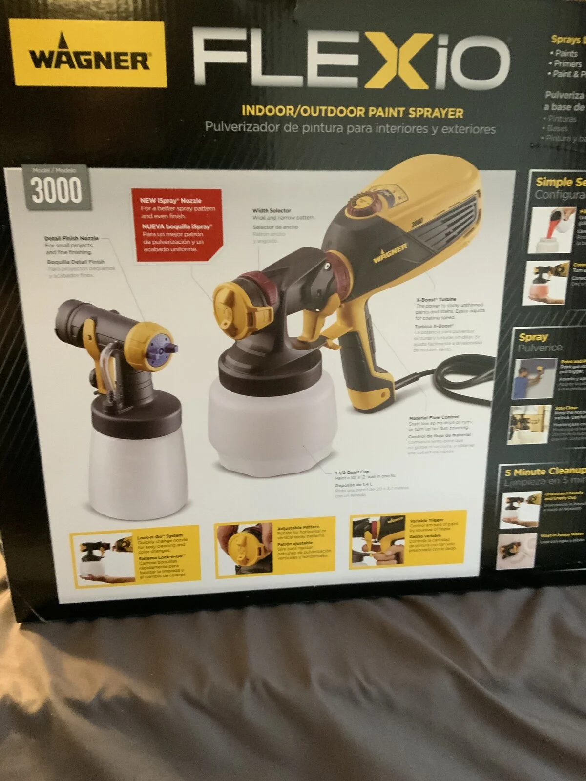

I am wanting to paint my Jeep and was wondering if this sprayer would do the job. I’m not looking for a professional paint job, I’m pretty much just wanting to make it look better than it does now.
I would say it probably would not turn out like you hope. Those airless types are designed more for latex and thick bodied paint. The type for a auto is very thin and needs good control of the air/paint mix. I had a guy paint my hood with a HF sprayer ($40ish??) and he did a fair job with it. The bifg deal was the prep and the actual quality of the paint. It was a auto specific paint that he had mixed using my paint code.

I'd use that to paint a fence or deck and not much more. You'd be better off using spray cans. Siphon Feed Spray Guns are fine, but need a ton of air to paint an entire car. Unless you have something that plugs into 220v, you probably don't have enough compressor.
