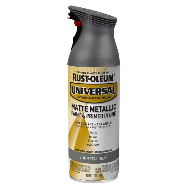

Rustoleum. Good product at a decent price. It's easy to find and easy to touch-up.
I've used plenty of Eastwood products and had mixed results. At $25 + shipping a can, I don't like mixed results.

Just my opinions but I have gotten some solid, good looking paint jobs out of Rustoleum spray paint
