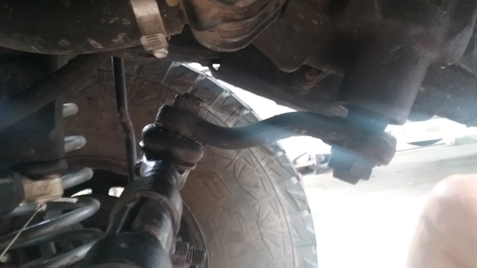

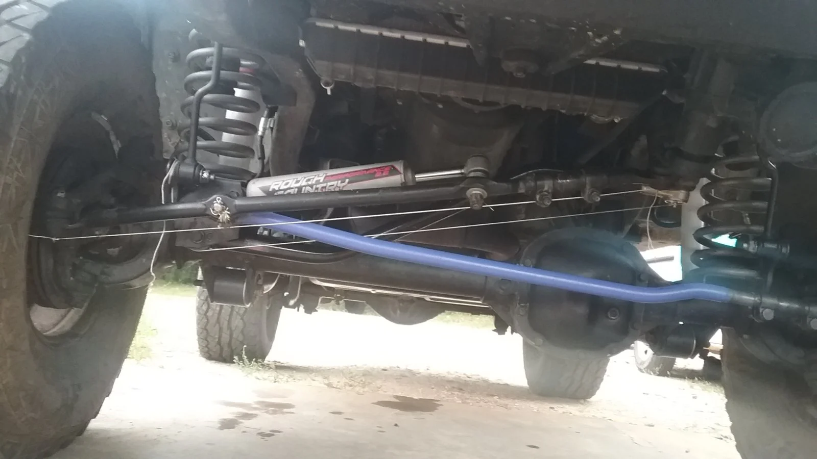

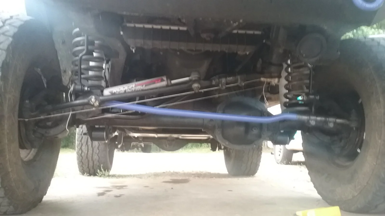

In one of the threads below, I saw a reccomendation to check the relationship between the track bar and the drag link. In an effort to make sure they are parallel I used some twine for a fairly good demo. So I tried a suggestion and here are my photos.
I'd like to know how it looks to you and if a drop pitman arm would be helpful for my setup. I was told several months ago to stay away from a drop pitman arm.
4" lift /33s.
