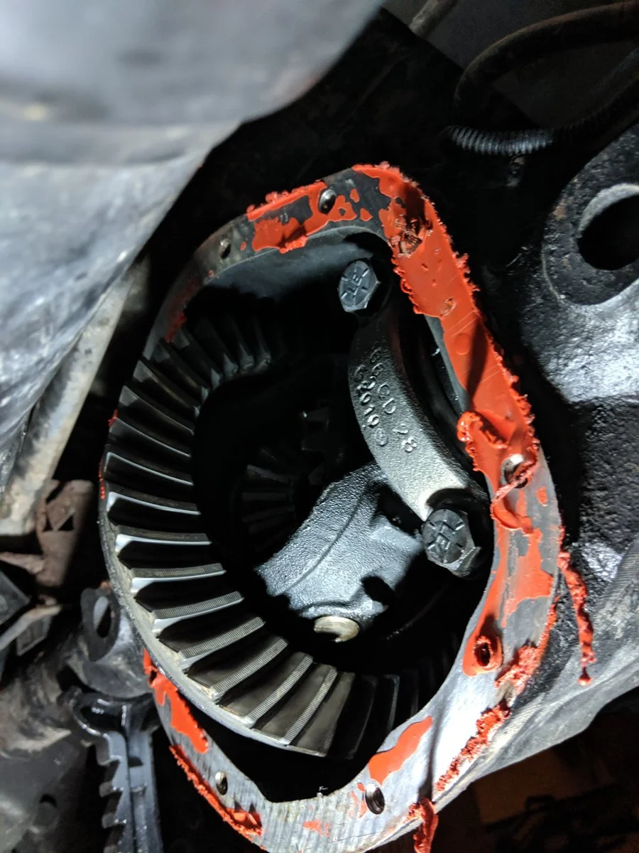

So I decided to start over again just for peace of mind, and I did make a mess, and made another mess on the second try but it cleaned up easily. Here are my lessons learned:
1) Jack up the jeep as others have mentioned
2) Make sure to use the valve/nipple on the rtv tube instead of right out of the nozzle
3) When laying the bead of RTV, do your circles around the bolt holes and then do the main ring around the cover
4) Do not spread the rtv! Just leave it as a bead
5) This part depends on if you are right handed or left handed. To put the gasket on, lay on the side of your non-dominant hand ( left side in my case), and support the rtv'd cover in your left hand with a bolt in your right hand. Gently/slowly put the cover on, thread in a bolt and thread in another bolt. This made all the difference then being upside down under the gas tank
I torqued the bolts and will add the fluid tomorrow evening.
I am attaching a pic of last night's rtv mess. Hard to tell but its on the gears, barely.
