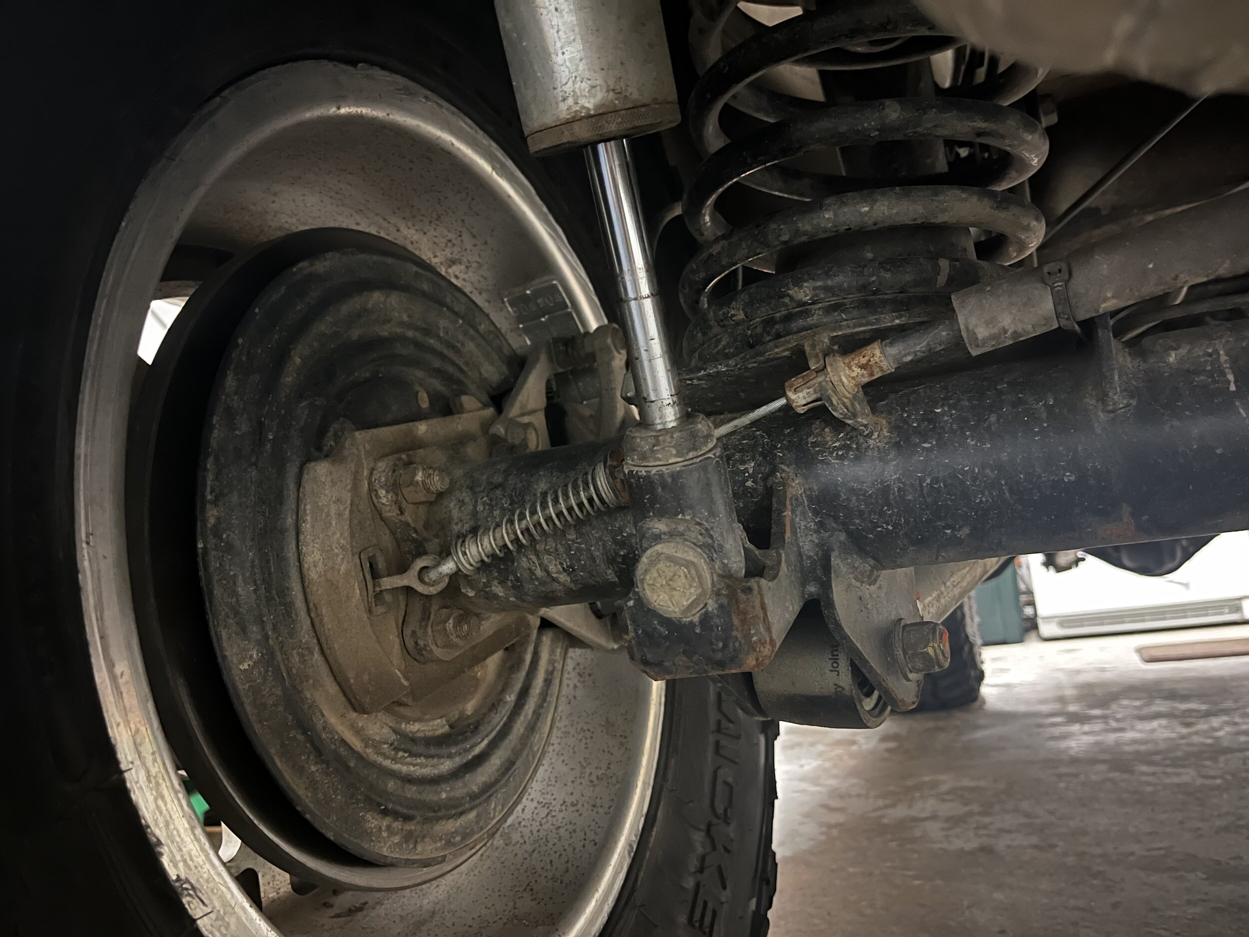

It doesn’t seem super easy to use my LJ’s current cables but i’ll look into it. Do you have a picture of yours? I read that jk 2 door cables are still too long.

I think the LJ cable has a loop end? I believe I saw @mrblaine make a small connector like a bicycle chain link and bolt it between each connection.

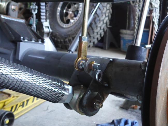

I drilled a hole with a cable slot in the AR tab. This is how I lined it up to pull straight on the ring.
Added a washer to bring the tab to the correct thickness for the cable housing clips.
Calipers on the back side. It was fully cycled and articulated to make sure the calipers can't come into contact with the springs. Even with fully worn out brake pads.

Wow that is truly an elegant solution. Difference between shade tree (me) and professional (you) right there. It didn’t even occur to me the fatigue impact of pulling at an angle on that skinny little tab.

The angle is not in the direction yours are pulling. The bad angle is towards and away from the axle tube. It can't handle much of that. Any twisting motion on the eyelet will break it eventually. It is designed to move "up and down" though. I just don't have that luxury with those housing ends that have been slotted to clear the lever. They have to go straight in and out as the cable moves.
