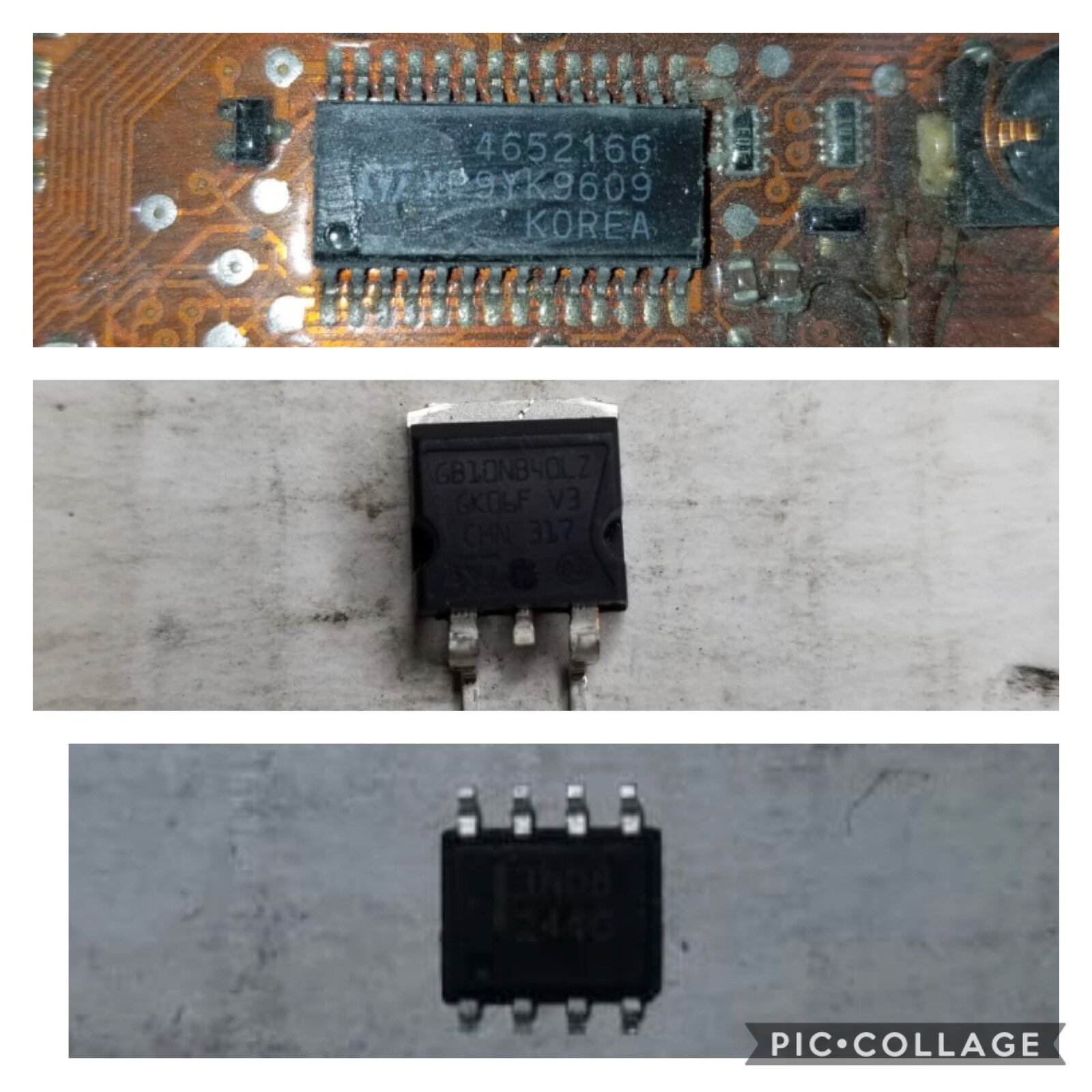

2005-06 were engineering nightmare years for Chrysler. Wrangler’s, any 4.7, 5.7 and 6.1 L vehicles are ticking time bombs with pcms.
I made this photo extemporaneously on three common failures on the “older” Jeeps. Too much voltage and shorts are usually the culprit.
From top to bottom are:
IAC Control driver
Coil driver
Dual injector driver
Hopefully this helps a little bit.
Reactions: qslim and 06lj
