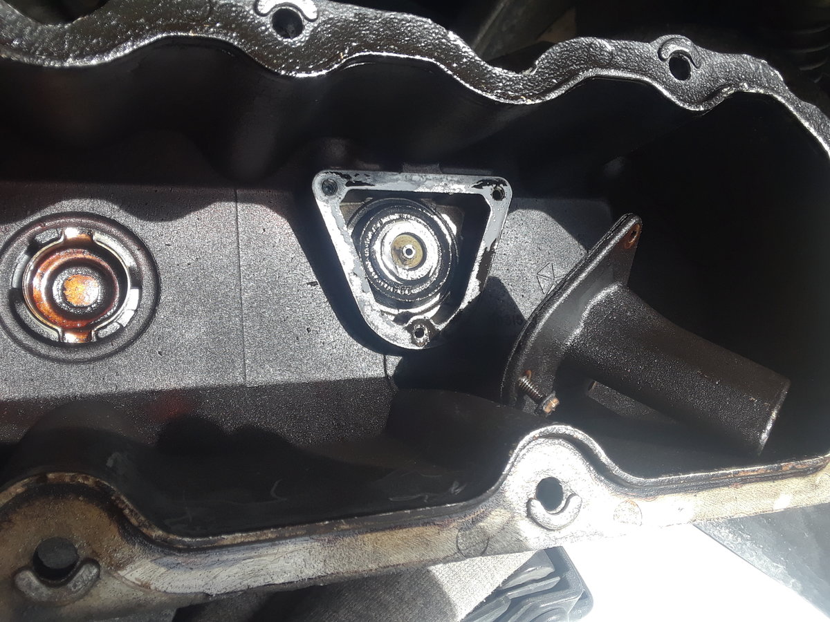

KCsTJ TJ student Supporting Member Joined Jan 9, 2018 Messages 2,909 Location Farmersville, TX, United States Mar 31, 2020 #1 How do I get this pcv valve to come out?
Fonz54 TJ Enthusiast Supporting Member Joined Apr 9, 2018 Messages 975 Location Monterey, CA, USA Mar 31, 2020 #2 KCsTJ said: How do I get this pcv valve to come out? View attachment 149535 Click to expand... I used a heat gun to soften the gasket/bushing. Reactions: KCsTJ
OP KCsTJ TJ student Supporting Member Joined Jan 9, 2018 Messages 2,909 Location Farmersville, TX, United States Apr 1, 2020 #3 Fonz54 said: I used a heat gun to soften the gasket/bushing. Click to expand... Great idea, thanks
