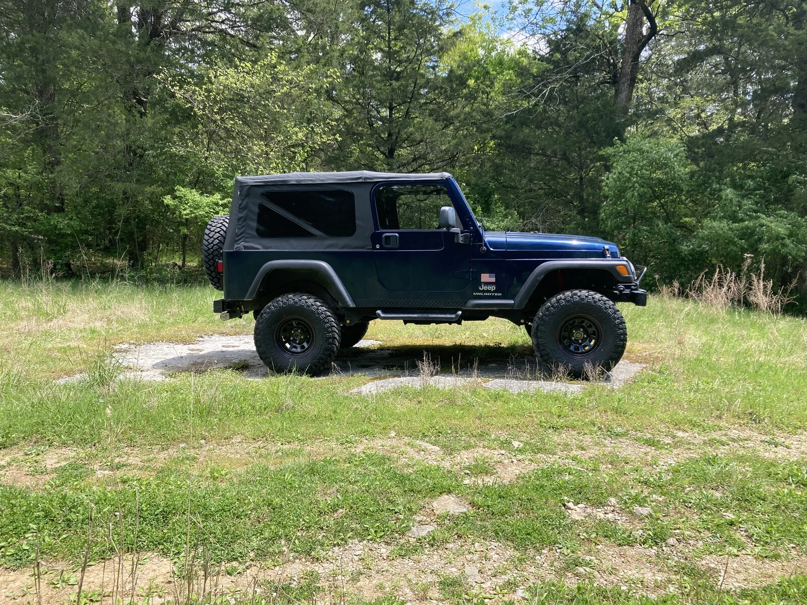

Time to order gears, as in the next 24 hours!
04 LJ, 42RLE, 3.73 gears, 33x10.5 ( no plans on 35's at this time).
Need to order gears and a powertrax for Dana 30.
4.88 or 5.13?
Goal is to be able to cruise 2+ hours to wheeling spots for the weekend and around town during the week.
In addition to ratio, what brand? Gearing is foreign to me so please basically tell me what I need. This place has been a great resource so far!!
