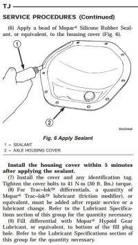

Get a flat head screw driver and pry the old one out get a flat small piece of a 2[emoji808]️4 and beat the new seal in very slowly and very light after you do that got to your parts store and buy the actual diff cover gaskets for your dana 35 in the rear and the Dana 30 in the front. Take the diff covers off drain fluids get a few pieces of 100 grit sand paper and clean up the diff and the cover as much as possible. Now the fun part get you a spray bottle and some kerosene and spray out the doffs to get and debris and muck out of there let the kerosene dry put the gasket and covers back on and fill up with 90 weight gear oil which is recommended also do not let some stupid redneck talk about you into using rtv to seal your diff cover they are stupid and they make a gasket for a reason enjoy have a nice day and be careful in the woods
Some models call for a gasket, some for oil-resistant RTV. For the Jeep, the Mopar rednecks call out RTV.
I use a Roloc bristle disc in the drill or a fine wire cone chucked into a 4-1/2" angle grinder to make short work of any old silicone residue. Smooth as a baby's ass in about 90 seconds on the cover.
