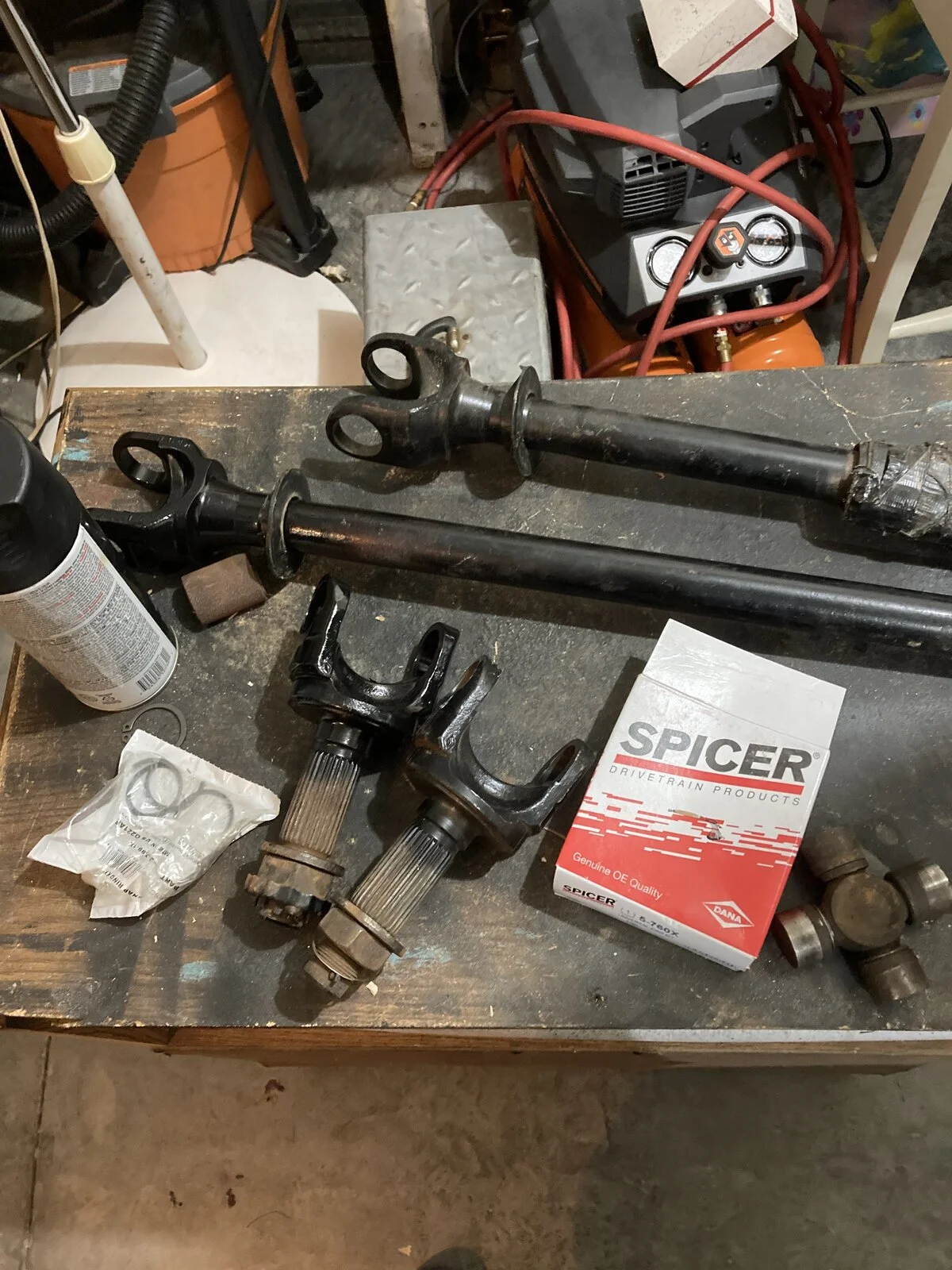

I’ve been going through this Jeep since I got it trying to tighten things up. Rebuilt both DS and found a little play in the passenger side axle u-joint so I bought 2 spicer 5-760 . I noticed a knocking noise under load last week so I removed the front driveshaft and still got the noise just not as much.I replaced the passenger axle joint and it was toasted and still got the noise.
I checked the joint again and it still has play(1-2 mm)
I’ve got a spare set of axles and another new joint.
From what I can tell the clips are seated correct but hard to tell while assembled.
What could cause the play?
My unit bearing has no play.
Should I swap the spare in with new joint?
Thanks

Are you certain it's not a stretched ear on the axle shaft allowing the movement?
No I'm not sure but it took some good whacks with a hammer to get the old joint out and the new one went in pretty easy. I didn't notice any play in it at all until the next day I grabbed it and wiggled.
Should I put a new joint in my spares and swap them?

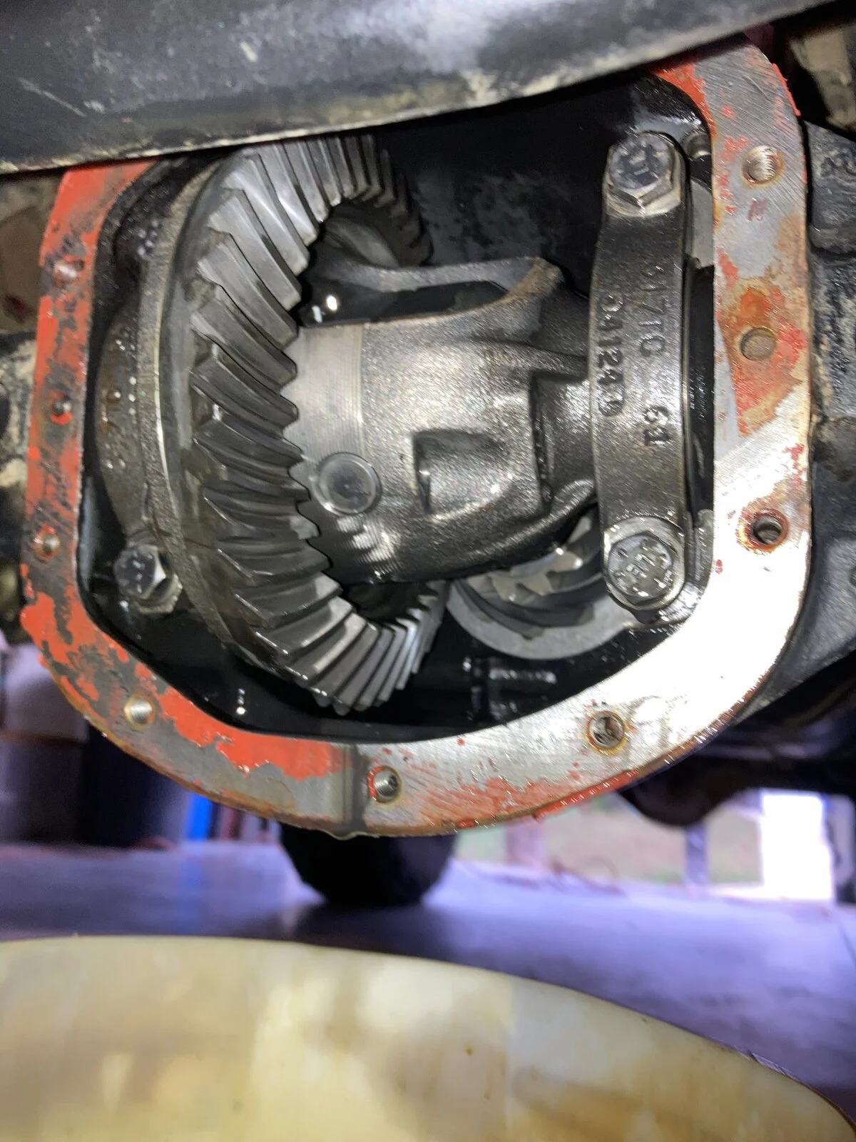

I had the cover off a couple weeks ago and everything looked fine inside.
Do these lunchbox locker develop play that can be felt at the joint?
Must have been a stretched ear on the stub shaft. I wiggled it until I found which shaft had the play and pulled it and swapped just the stub shaft with a spare and reused the u-joint and absolutely no play now. I still hear the clicking or popping under load. I’m assuming it’s just this lunchbox locker.
I haven’t noticed it this loud.
Does anyone recognize this locker?

I just realized you can’t even see it cause of the case🙄
